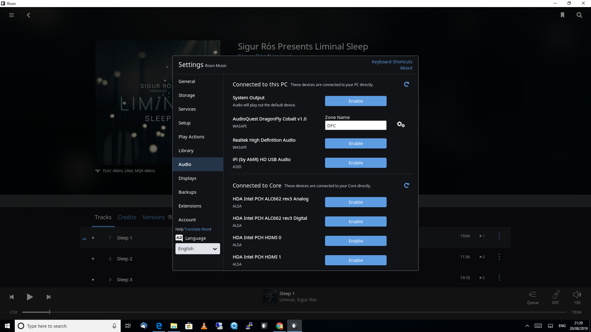

Set Volume Control to Fixed which should set it at 100% or set Roons volume to 100%, Then set all the other settings as my pictures and it should work.

Can you make sure that your Dragonfly has been enabled in Roon Settings -> Audio
tab? Additionally, can you share a screenshot of this tab from your end? You can use these instructions to upload screenshots to this site.
Can you try using the default settings for the Dragonfly zone? You can achieve this by going into the same Roon Settings -> Audio
menu, pressing the “cogwheel” icon next to the Dragonfly zone and then Load Defaults.
After performing these two steps, you should then be able to select the Dragonfly from the Zone picker and have audio output to the Dragonfly zone. If the above two steps are not clear, we also have them listed in our Knowledge Base Guide with some additional screenshots. Note: all the blue links above are click-able.
