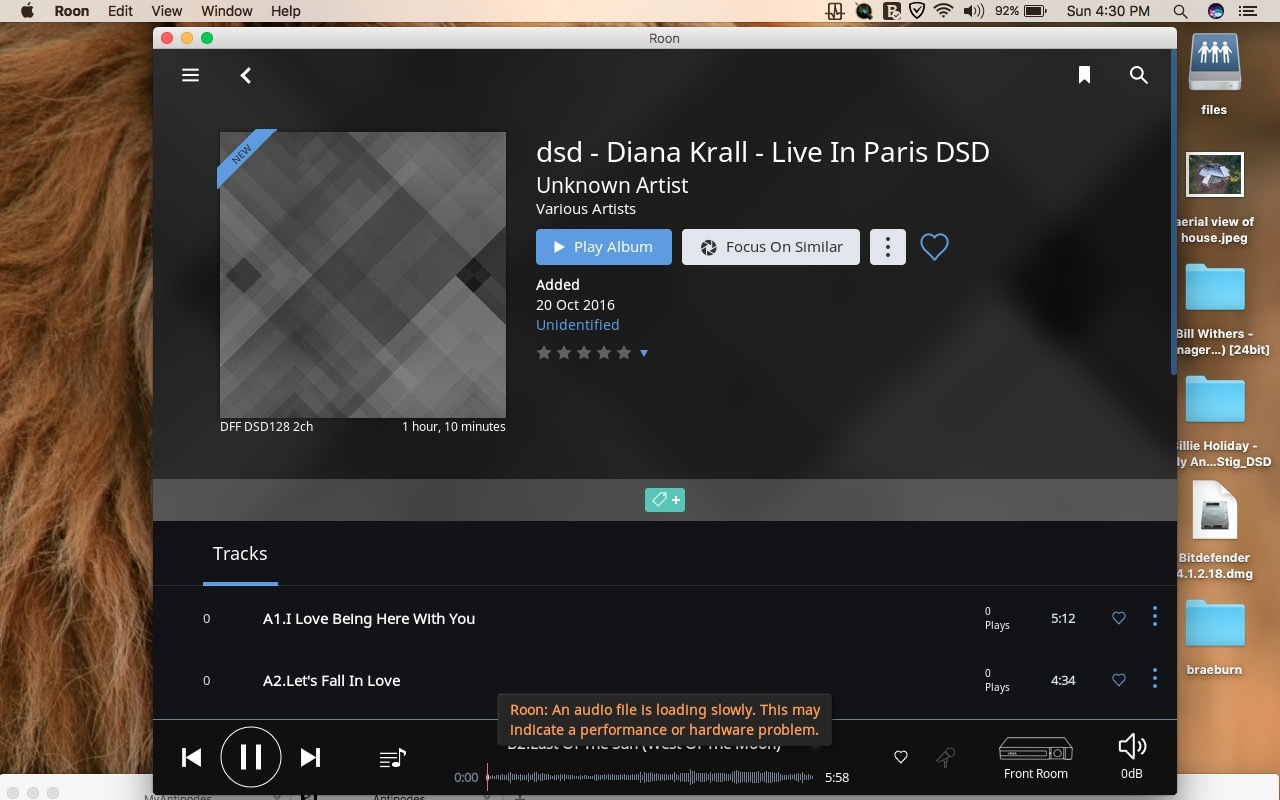

I’m having trouble with DSD files lately. I’ve got a couple of DSD128 files lately that are slow to load in Roon. Roon keeps saying it’s a hardware problem. I’ve got an Auralic Aries to decode and an Antipodes server, so it shouldn’t be that either can’t decode the files. But maybe I’ve got the settings wrong in Roon to accept those files. I think I should be supported up to DSD256 as far as I know. What should the proper settings be in Roon to accept all DSD files? Or is it possibly something else I’m missing? Thanks.
By the way, I was wrong. I’ve got an Auralic Vega, not Aries. And what happens is Roon tries to play the file (DSD128) and stops 5 seconds into the file and stops and there’s the message that it might a hardware problem. Then it tries to play the next song with the same result.

The Vega is connected via USB to the Antipodes. The files come from the Antipodes D1, then through the Auralic Vega to the preamp and amp. And it’s all running from a dedicated MacBook running the latest Roon. By the way, it seems all the files not working are DSD128. So for some reason, the DSD64 files are fine. Recently, I got a couple of DSD128 files that aren’t loading. And the Vega and Antipodes should be fine with them, as well as Roon, from what I know. As far as I know, I should be good up to DSD256, right? So my settings might need to be changed to accept the new files? Roon is playing DSD64, but not 128 and I assume above that too. Thanks for your help.
