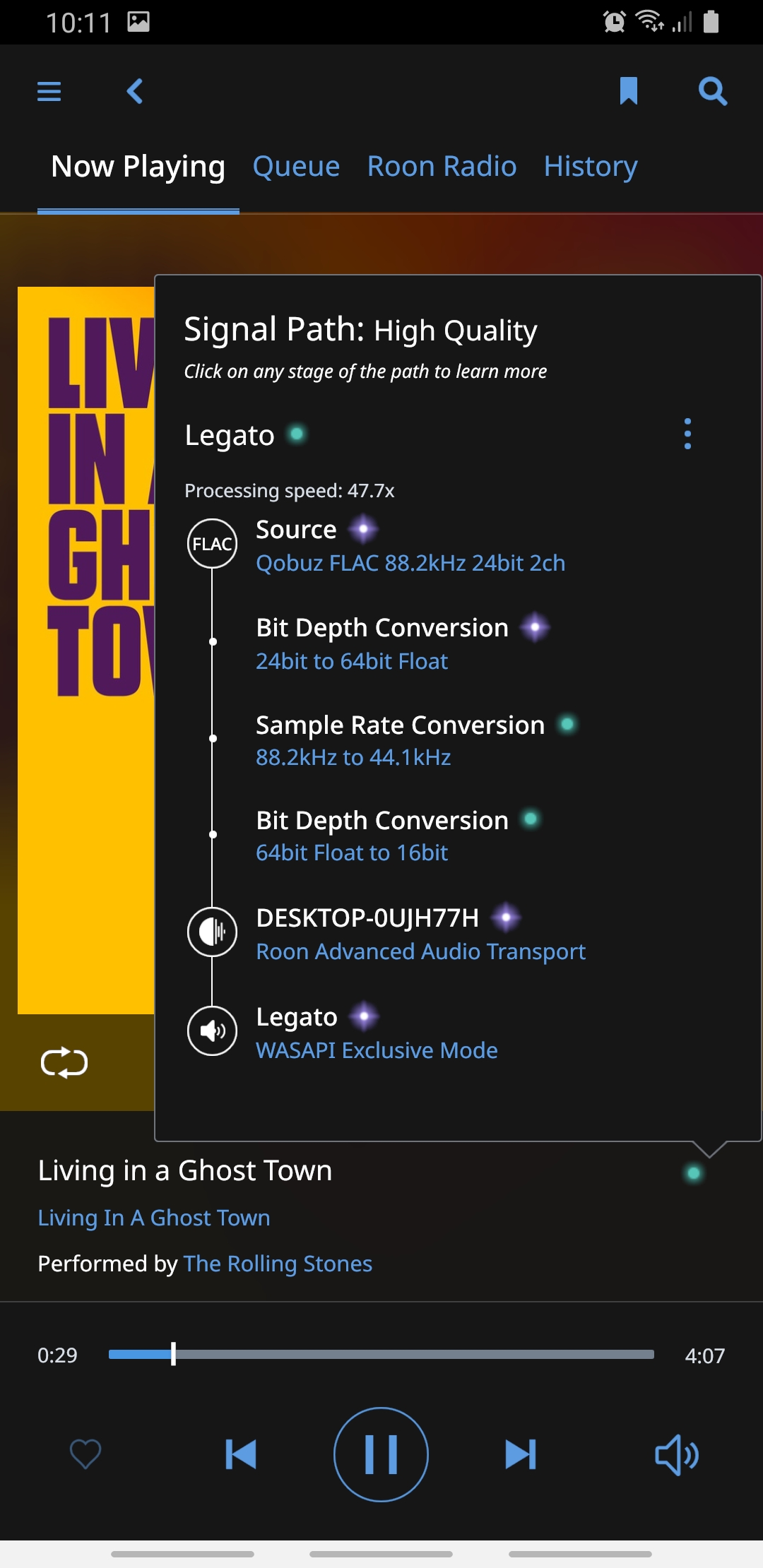

This is a screenshots of a 16/44.1 file ,all works fine.
Giovanni.

Hi,i follow your suggestions and everything is going very well.
Let me know what I need to do now to integrated HQPlayer.
Tks Giovanni

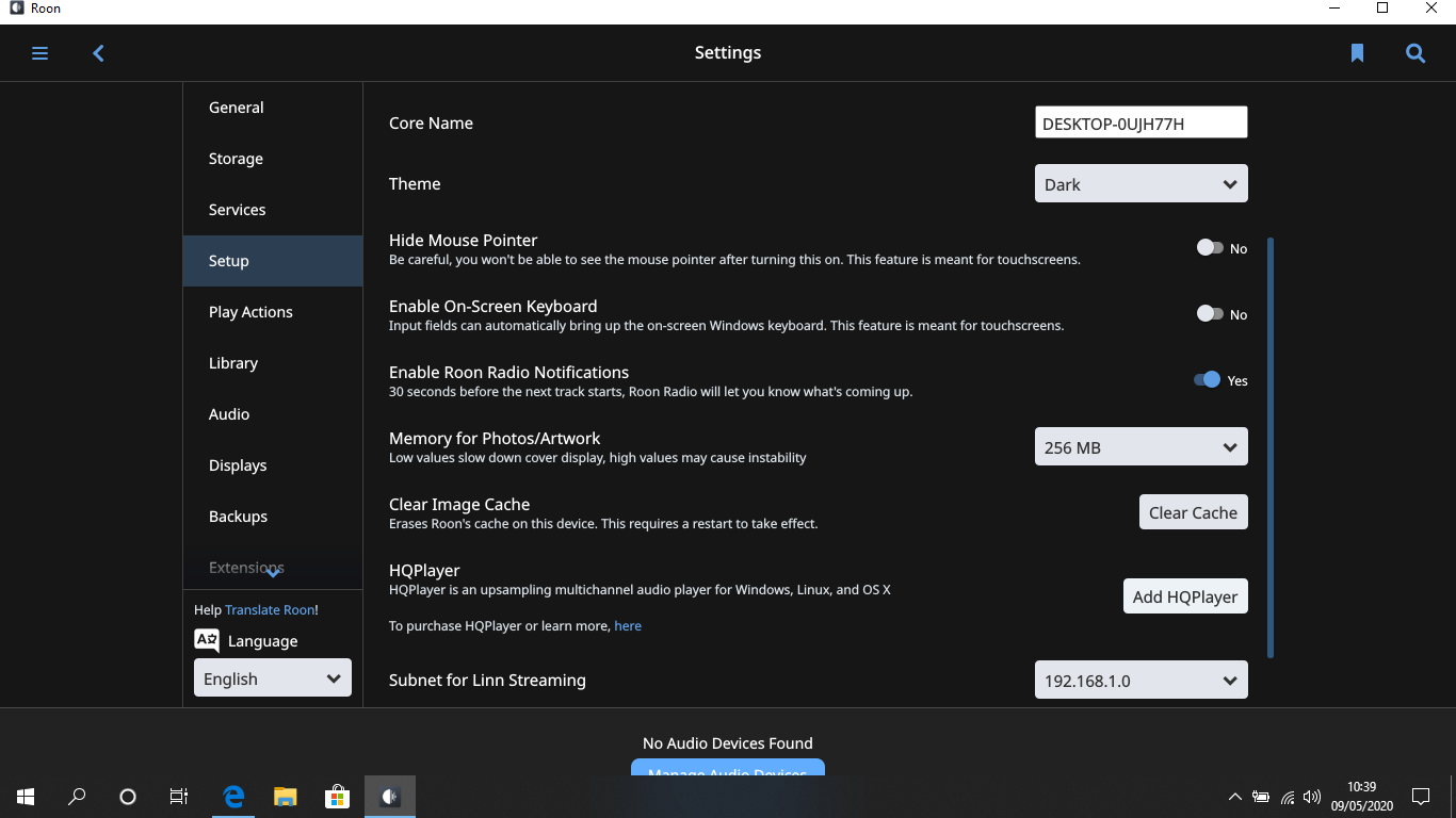

First af all TKS for support
Now I try config Roon
Roon and HQPLAYER are on the same machine, so local host is o.k.
Any anyway in HQPLAYER I don’t have the icon for lan configuration…?
Audio setup I leave the default, is it o.k ?
Giovanni.
