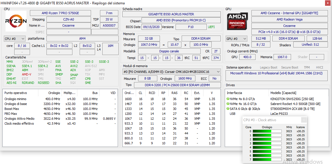

In the meantime I also attach this photo of the overall characteristics of the system
I also don’t understand what you mean by “your graphics card won’t boot.”
How is this possible if I use the PC for all other purposes?
The motherboard doesn’t have an integrated graphics card; the only graphics card is the external one in use.
