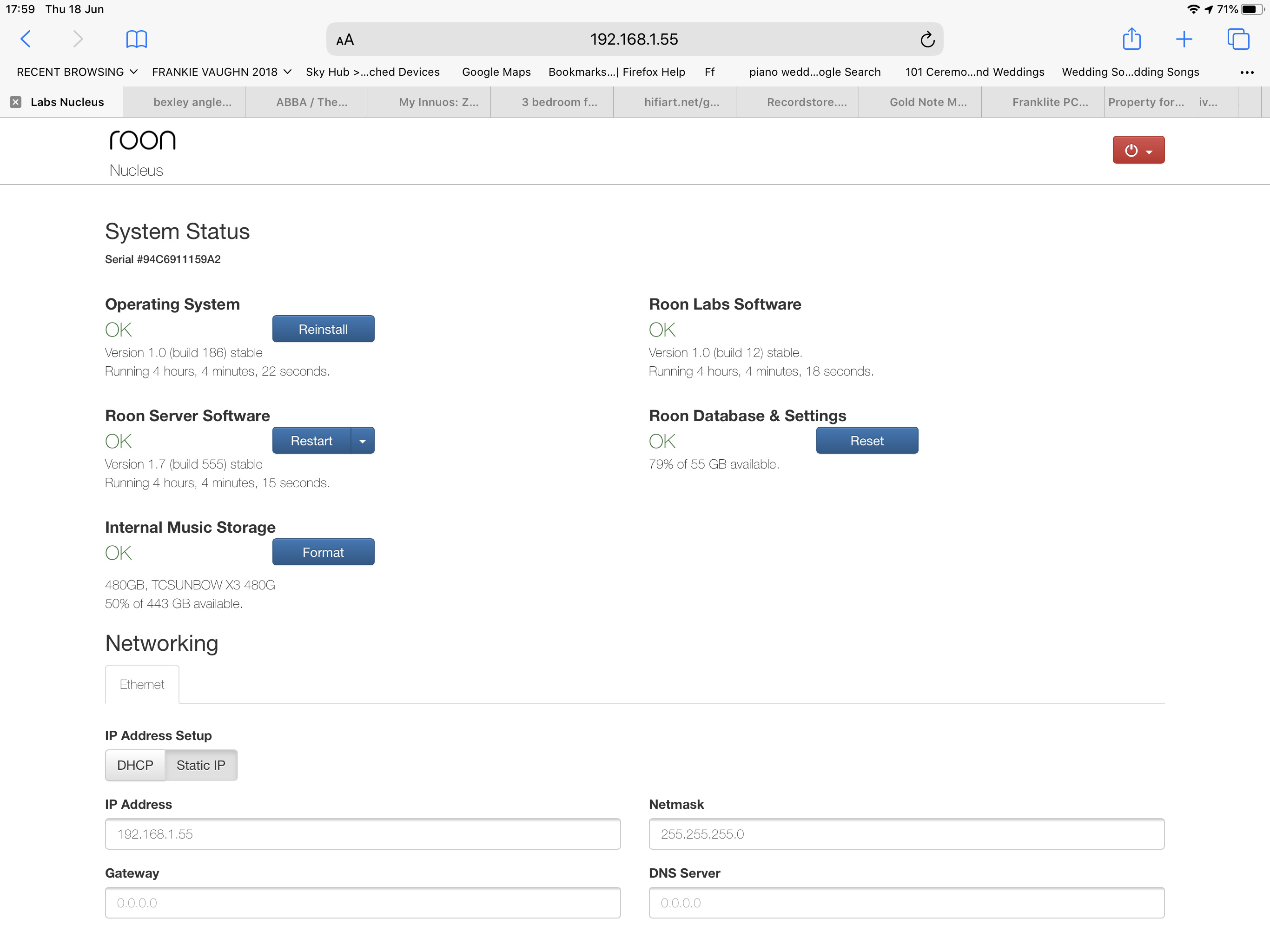

I have now taken network switch out of the situation and connected Nucleus directly to router, still I can’t connect to internet, update or login to Qobuz
All my other internet connected devices in my house are functioning normally!
I have rebooted nucleus twice and no change.
It looks like a ROON/nucleus issue doesn’t it?
Hi @alex_wood,
What does your Web UI for the Nucleus look like?
Can you share a screenshot of that tab?
Click on link above, i included it earlier “image 231x500”
Hi @alex_wood,
That’s not the Nucleus WebUI. It should look something like this for reference:
Doh, my bad, I had a complete brain fart there…
Ah, have I got a problem with my gateway and DNS server settings and if I have, how on earth do I resolve that?
Pick DHCP and see if it populates.
I have manually populated the DNS and gateway, boom, it worked.
Noris you led me too it and I clicked!
Thanks, lesson learnt there
