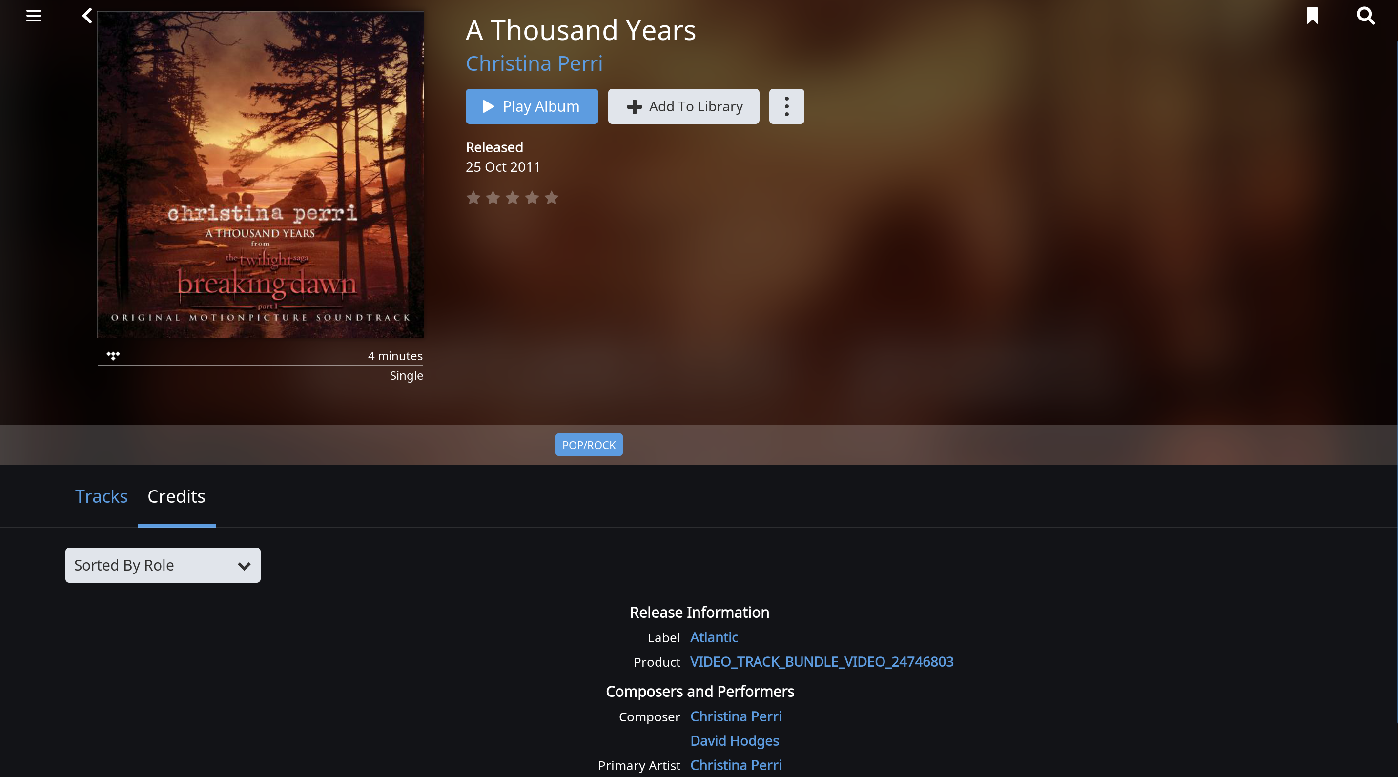

@Eric,
It just happened again and this time I looked into some of the metadata and found that if I look into “Credit” there’s an information there that indicate that this “track” is actuall a video.
Maybe this screen capture can provide better picture of what I meant… have a look at the bottom part of the image, under Product, you’ll see that it is a “VIDEO_TRACK_BUNDLE_VIDEO_xxx”
If you do a search on Christina Perri on Tidal, there’ll be two of the same singles “A Thousand Years”, one is this one (a video) while the other one is the real song, which plays okay.
I hope this helps in the investigation. Thanks again!
