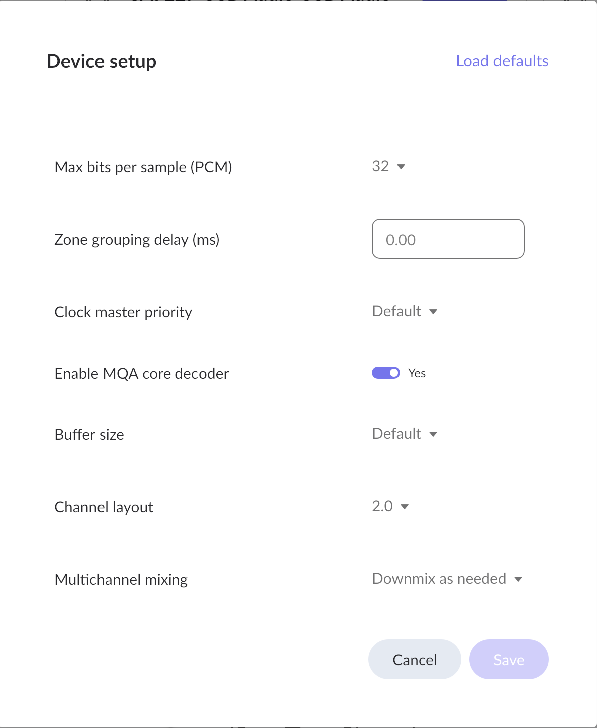

My point is if the OS has a new enough kernel it will detect the DM7 (and other mch DACs) just fine over USB. That’s half the battle. Whether Roon can then use this as a mch DAC via its bridge software, I don’t know. It does seem to detect it as mch though:
I have Roon bridge installed on my RPi4 CDSP box and this is the endpoint found in Roon. Notice the option for channel layout. I assume this is because the Ubuntu server OS detects the DM7 properly and not because of anything CDSP is doing but I can’t be sure. I also have Ubuntu server and Roon bridge installed on a mini pc with HDMI out to an AVR that I do use just for Roon as a mch endpoint and this is how it appears in Roon as well.

In settings: native DSD, channel layout 5.1, downmix as needed. AND- send stereo/mono content as 5.1. This does NOT seem to add fake extra channels- stereo files only come out of 2 speakers as they should. But before I enabled that, all 5.1 files played great, stereo files sent buzzing to the rear and center. I don’t completely understand it, but it works and sounds good.
