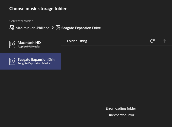

Roon app cannot access external USB storage on Mac OS X Sequoia 15.1.1 (ref#SEW6TT)
Roon app does not access to external USB storage, Mac OS X sequoia 15.1.1 (no pb with OS X Sonoma)
no network, Roon core is my Mac

I have no VPN, no antivirus. The third party software I use is ntfs-3g+Mac fuse+Mounty to write on my NTFS external USB hard drive (my music files are on that drive). If I mount the drive with Mounty, Roon does not see it. Thus I cannot choose it as music storage.
On the screenshot in my first post, when you see in “Choose music storage folder” the drive “Seagate Expansion Drive”, the USB hard drive was mounted automatically by OS X in read only mode.
In other words, when I use Roon I do not mount the drive with mounty. The drive is automatically mounted by OS X in read only mode.

Just to complete my last post from today, I uninstalled completely Mounty, MacFuse, … and the problem remains. Roon cannot read my USB drive (file system is NTFS).
I also precise that, I did the test with a USB key in FAT32 format, it works, Roon can read the key.

Unfortunately, NTFS is known to be problematic with Macs, some users have gotten it to work in the past with another driver, but NTFS usage on Mac is not something that we regularly test for or support. If you want to try the other NTFS driver, I will link it below (note that we have no affiliation with this tool):
I wish I had better news here, but if the driver doesn’t work or you don’t want to try it, copying the data off the drive and reformatting it to exFAT, or using a separate drive non-NTFS formatted just for the music would be the next best course of action.
