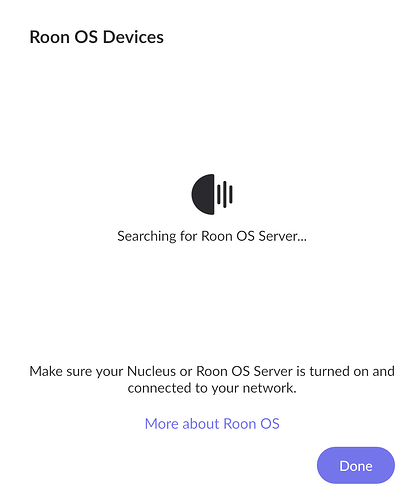

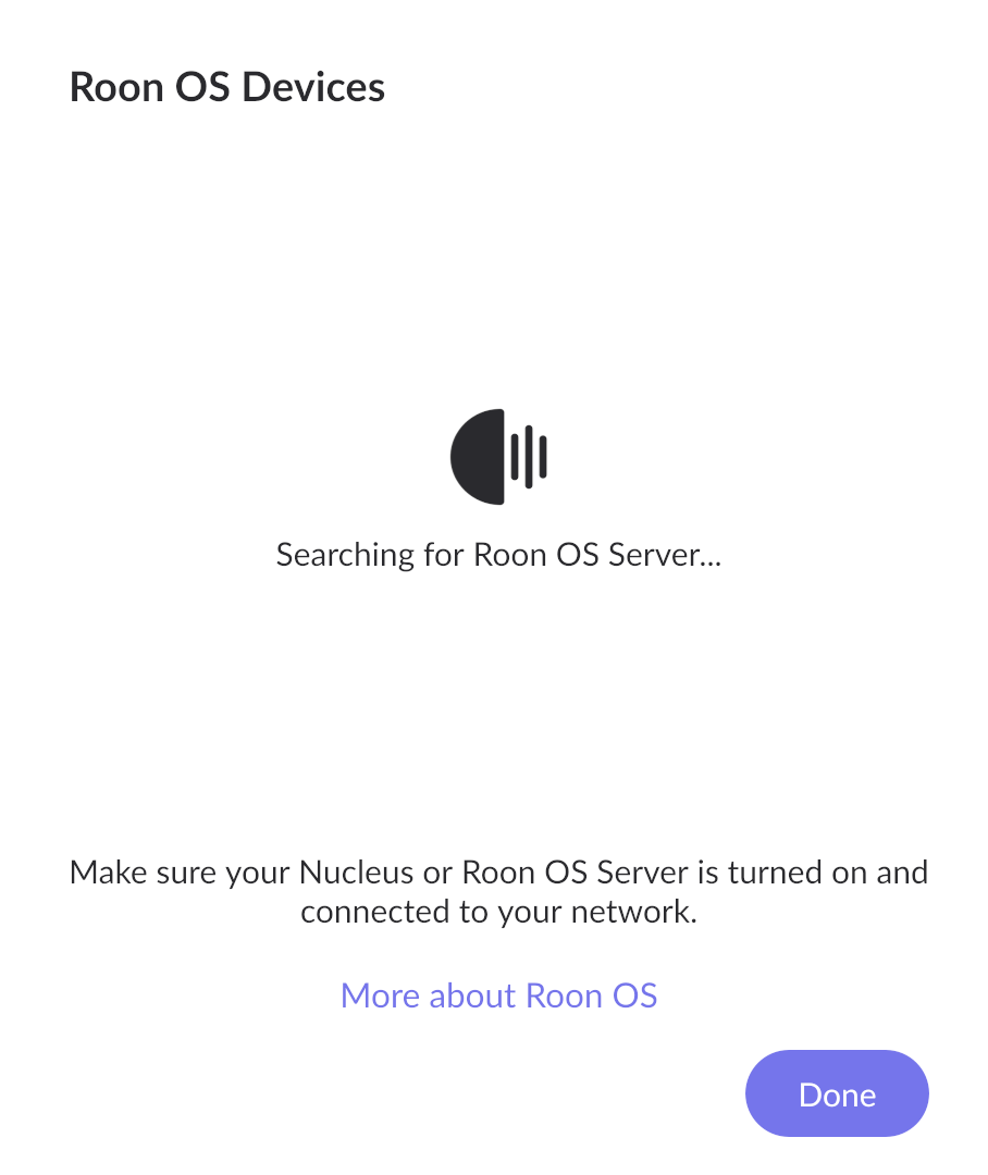

Thanks for the very clear instructions. I’m stuck on “Searching for Roon OS server”. It’s not seeing it, despite it being on and being seen by the Roon app on my iPhone.
Never mind; clicking install server and then cancelling that solved the problem. Whatever works. I also made sure the newly installed startup option for server was deleted. Seems to be all good. Thanks.
