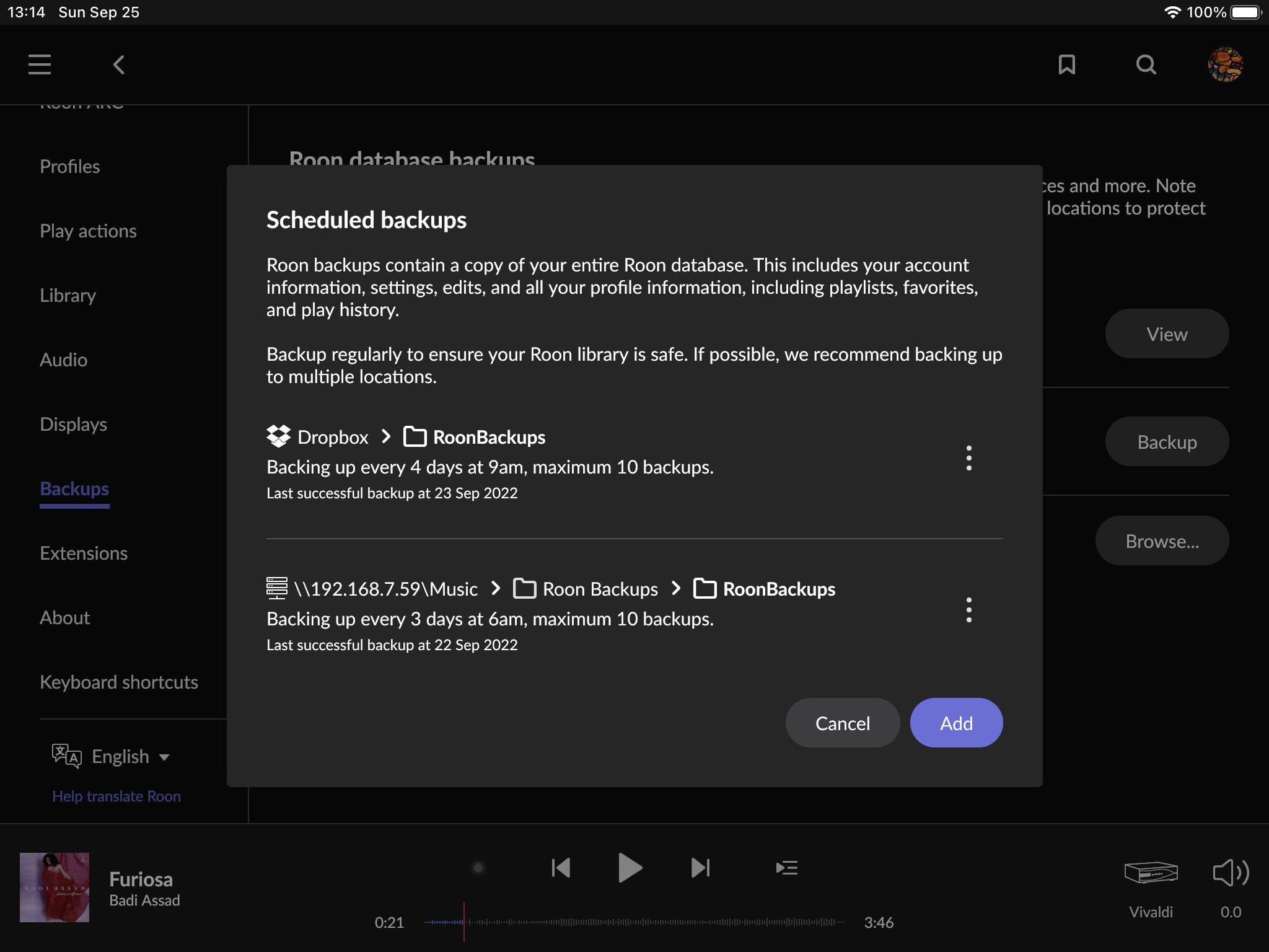

Thank you for the details! I’ve enabled diagnostics on your account to take a closer look at things, and I wanted to ask about your Nucleus backup situation. Do you have an SSD you’re saving backups to? Or, are you using Dropbox as a system for your backups?

I have two different backups scheduled. One goes to the SSD on the Mac Studio (same location as the local music library); runs in about 30 minutes. And the other goes to Dropbox and takes 4 to 5 hours to complete. As an aside, since those backups are scheduled at 6:00 am and 9:00 am respectively, I’ve been launching many of them manually, since Roon has usually been down when they were scheduled to run.

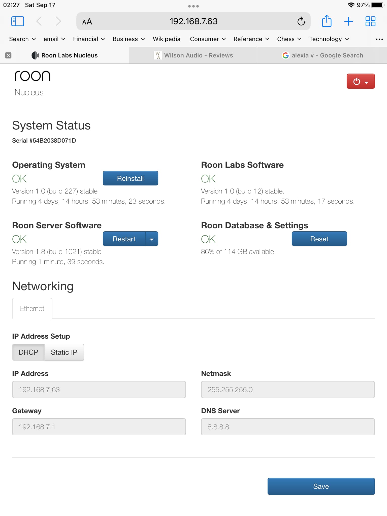

I played music on Roon for a couple hours early this morning (Sep 8, ~2:00am). Later today (~1:00pm) when I checked Roon on the Nucleus, it was down again. I disconnected/reconnected power and it came back up. Then I manually launched the local backup that should have run at 6:00am. Within five minutes or so, Roon crashed again. I went through restarting the Nucleus/Roon again, relaunched the backup again, and this time it ran successfully. Roon is still running now (5:00pm) and playing Live Radio without complaint.
Wouldn’t there be an error log somewhere that would give an indication of what type of hardware or software fault is causing these failures? Hard to believe such a sophisticated system does not have fairly robust error reporting.

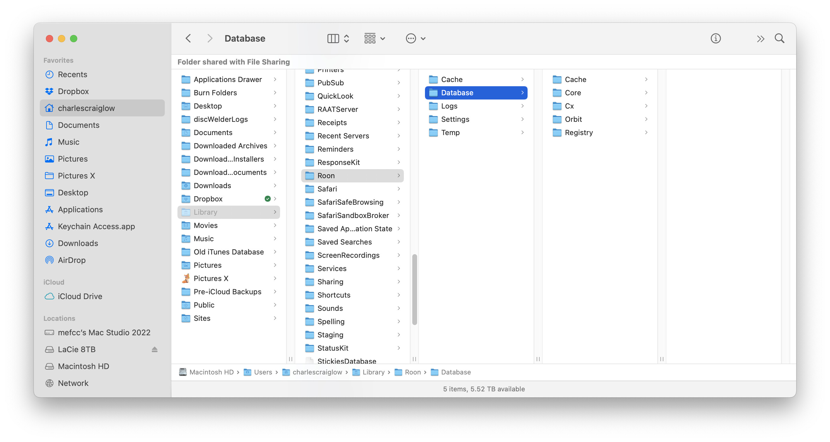

As a next step, let’s get you set up with a fresh RAATServer. You can generate a new RAATServer instance on your device by following these instructions, but please be aware that this will reset your Roon Settings → Audio Tab to factory settings and I would advise making a backup of any custom DSP settings you have:
  • Create a Backup of your current Roon Database
  • Stop RoonServer from running in Nucleus’s WebUI
  • Navigate to your Roon’s Database Location
  • Restart the RoonServer in the WebUI to generate a new RAATServer
Let me know if your issue persists after the above :+1:
Thanks, Benjamin
Oddly, there does not appear to be a “RAATServer” folder in my “Roon Database Location”. Please see the attached screenshot. Or am I missing something? (None of those subfolders in “Database” contains a “RAATServer” folder.)
Chuck

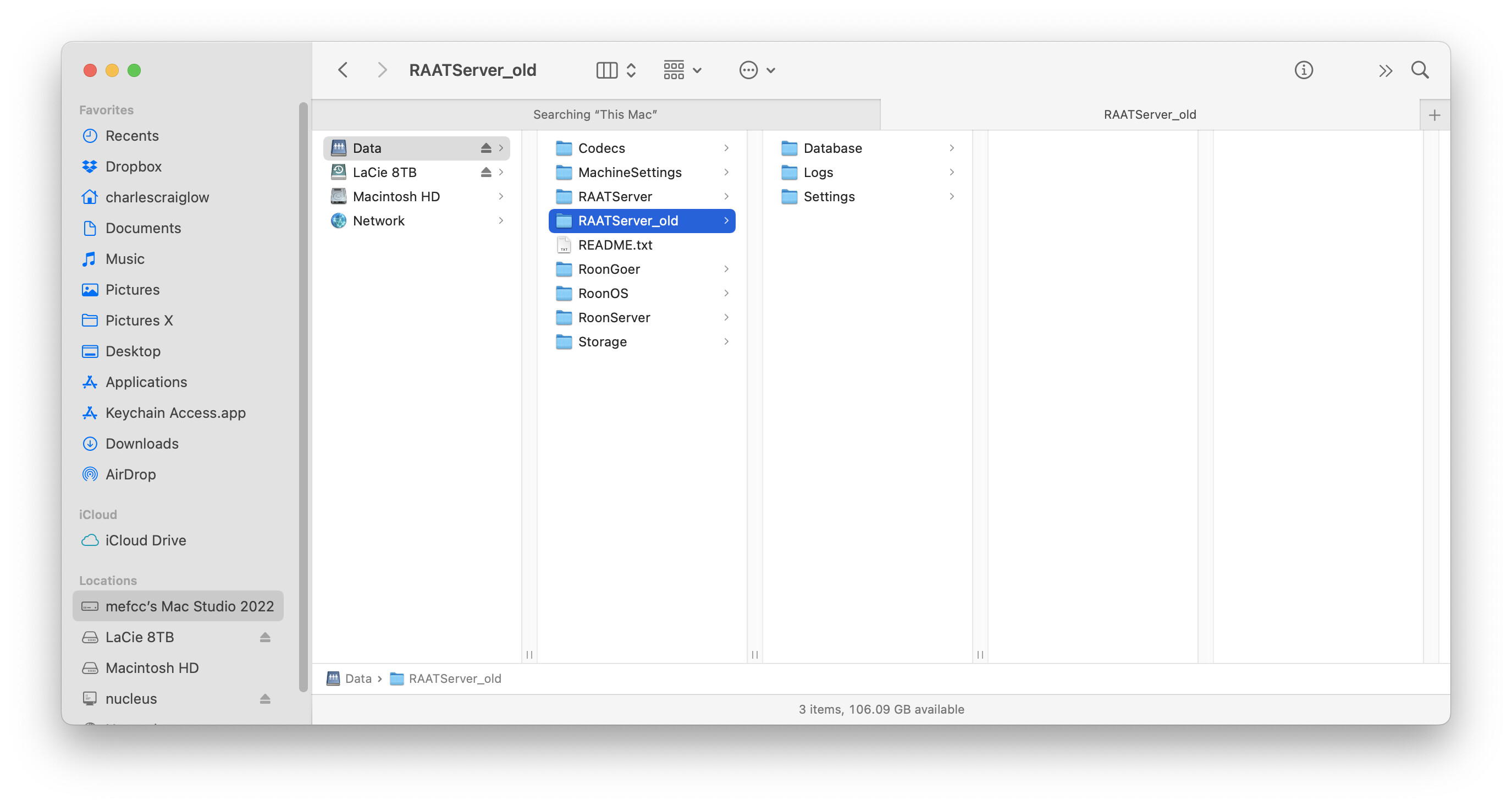

Sorry, I did misinterpret the instructions. This afternoon I managed to access the Roon Database on the Core and rename the RAATServer folder as requested. Restarting Roon Server did create a new RAATServer folder as expected. See attached screenshot. As of now, Roon is running and playing Live Radio.

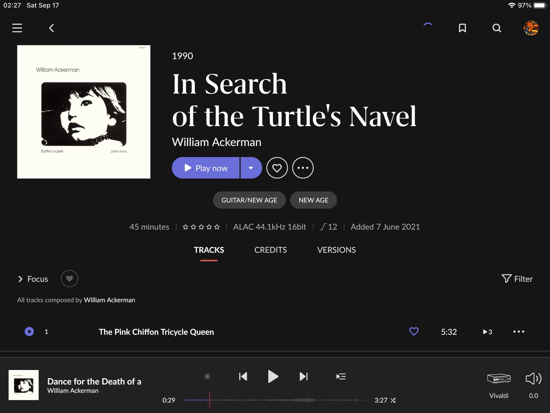

After streaming music for 2-3 hours, Roon crashed again last night. I attached a couple iPad screen shots to give you a time stamp. It has not crashed again since restarting last night, but clearly something is really wrong. I’m pretty convinced it’s not a network issue, We have 2 Macs and a number of other devices attached to the network, and none of them has any problems at all. Nor did the Nucleus until a few weeks ago. I’m beginning to wonder if there isn’t some kind of corruption in the Roon database that may be the cause. Please advise. Thanks.

As a follow-up, when your nucleus crashes, does it show that RoonServer restarted in the WebUI?
With that, if you could (again, my apologies) provide a specific time and date of the next crash we may be able to better pinpoint what the cause might be.
Sorry, I have not been checking the Server status on the WebUI after these crashes, but I will after the next one…

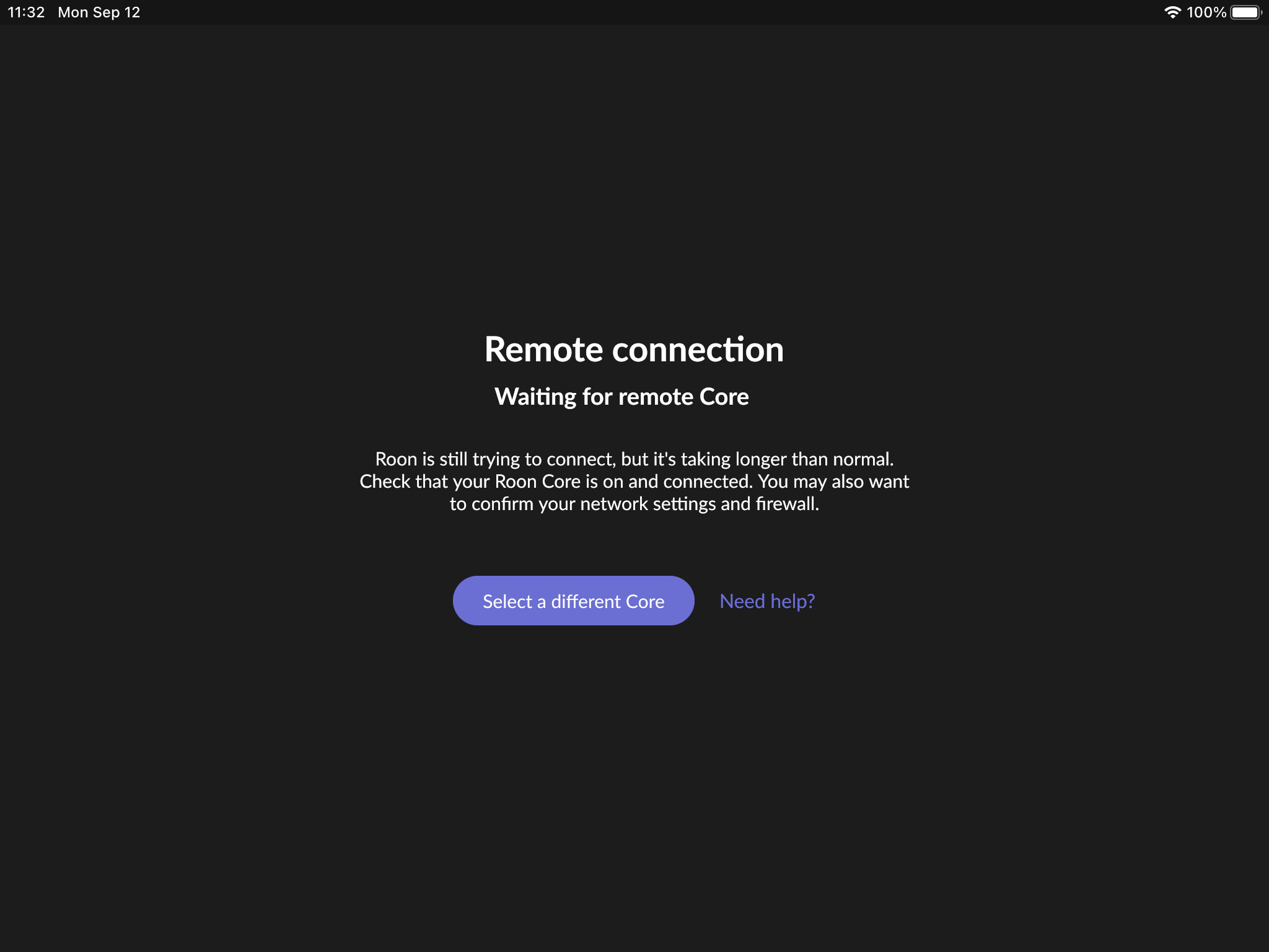

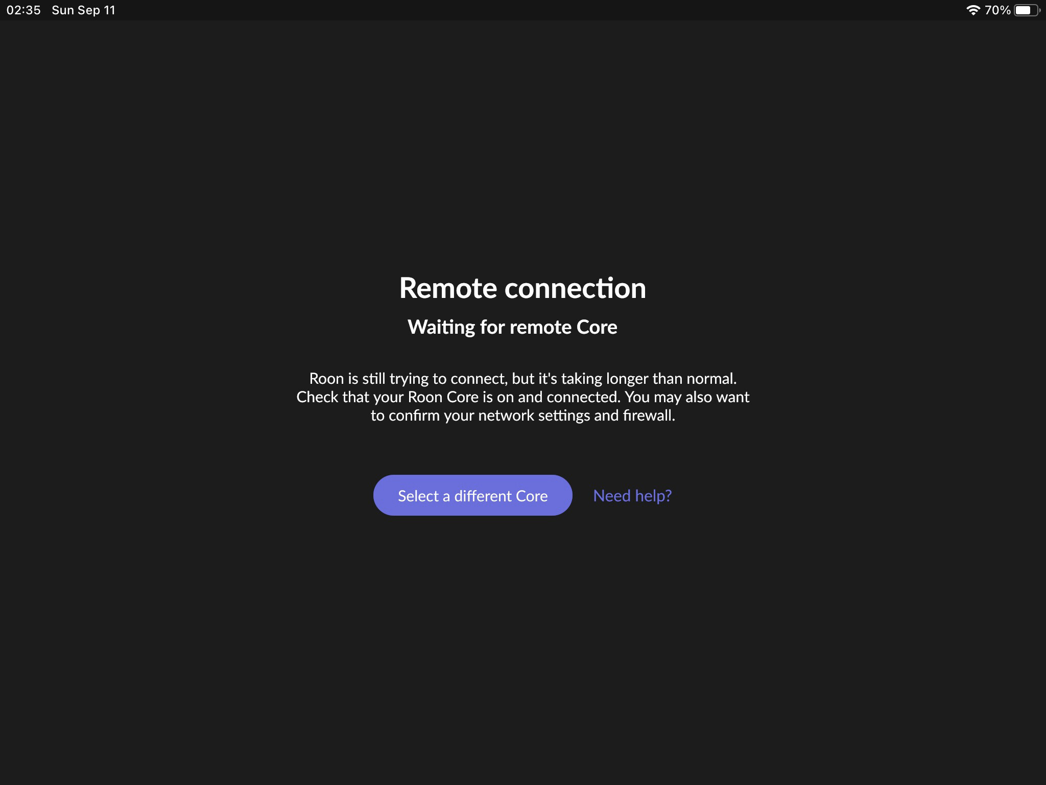

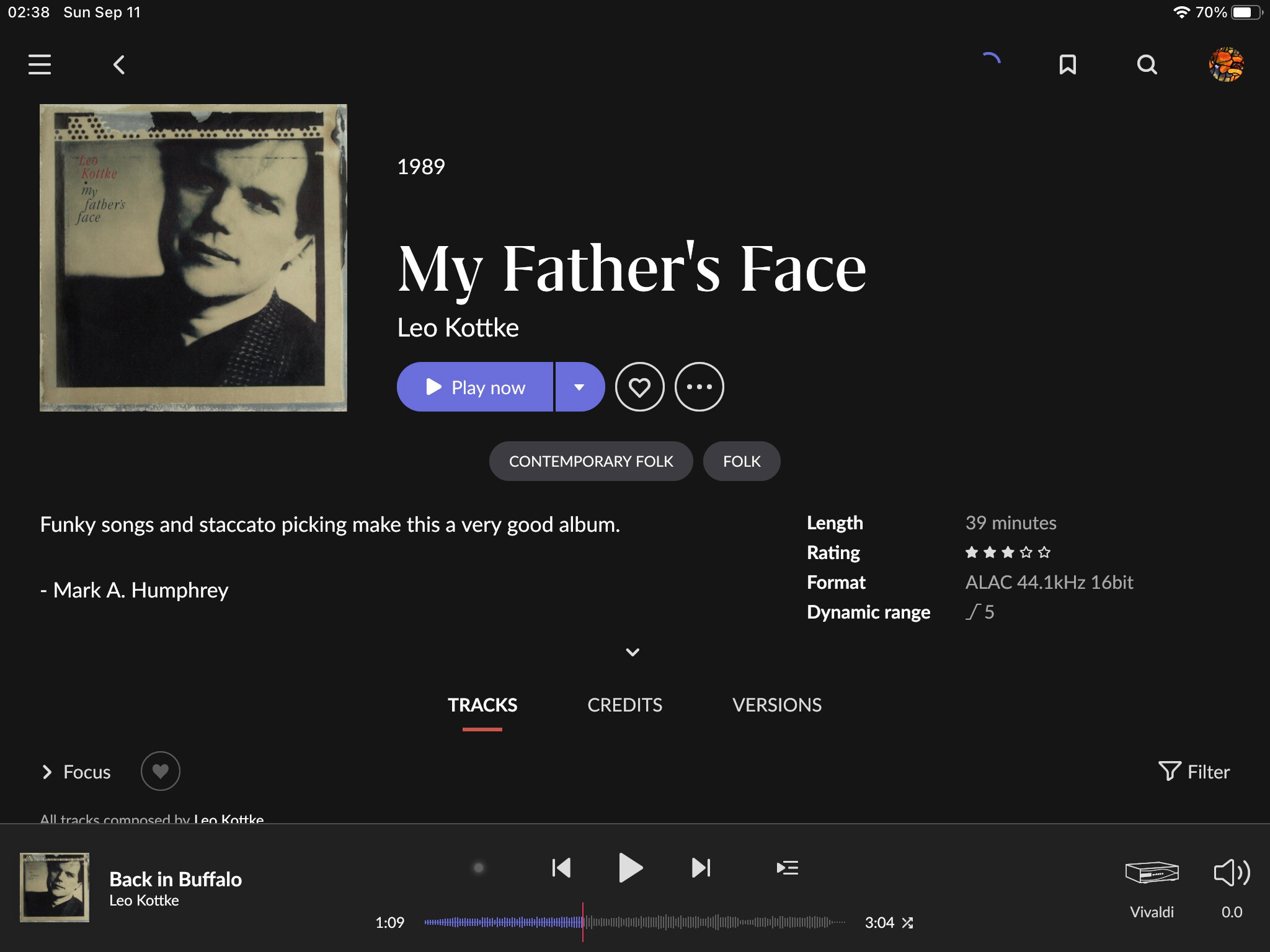

FYI, Roon ran fine all day on Sunday, Sep 11. Streamed music until close to 4:00 am on Sep 12. But at 11:30 this morning it was down, as usual. The best I can say is it crashed somewhere between 4:00 am and 11:30 am, presumably while I was sleeping. The next time it crashes, I check the WebUI first and let you what the Server status was prior to restarting it.

Roon ran uninterrupted for ~4.5 days, but it crashed again early this morning (Sep 17) after streaming music for a few minutes. In this instance Roon rebooted itself automatically, so I was unable to capture a screenshot of the WebUI status prior to the restart.

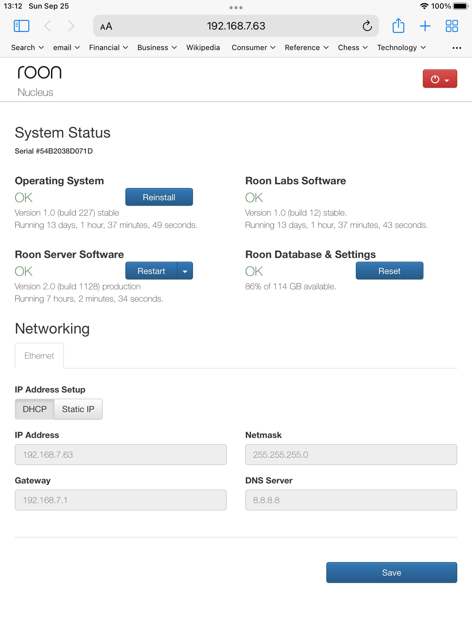

As requested, I updated to the latest version of Roon on all my devices sometime in the afternoon of Sep 21. Roon then ran fine until earlier this morning (Sep 25). As you can see from the attached screenshots, what appears to have happened then is that Roon failed while attempting to complete the scheduled 6am local backup. It subsequently rebooted itself, but never ran the backup. After making the screenshots, I launched the backup manually myself, and it ran without incident. Roon is still running fine as of now (4:17pm).
