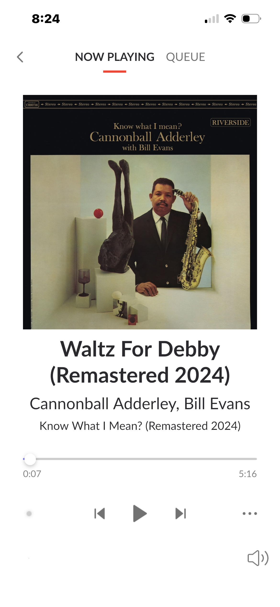

· The Roon app keeps dropping one of my connected audio devices. When playing a track, the audio device icon (which you can usually click on to select which audio device you would like to use, if more than one device is available) in the left does not appear. Instead a fuzzy dot is displayed.
If I go in the settings menu and to audio and click disable on the device and then click enable the Roon app window closes.
When I play a track it turns on and plays music on one of my two audio devices. I cannot select which device as the usual audio device icon in the left is not present.

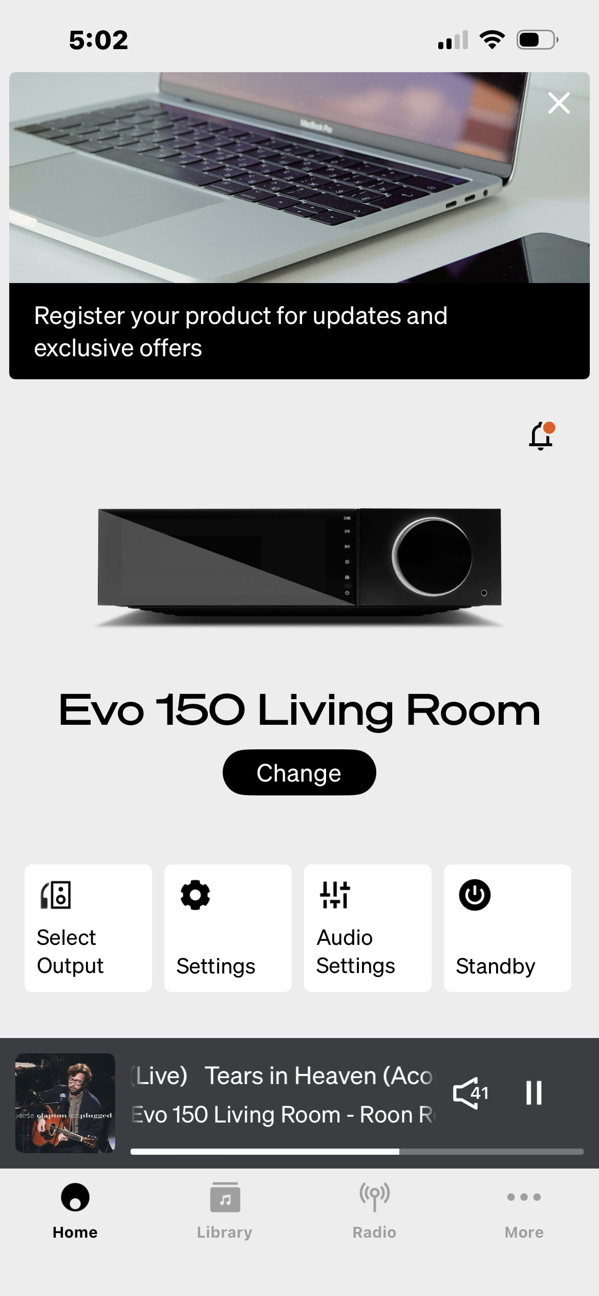

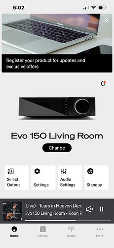

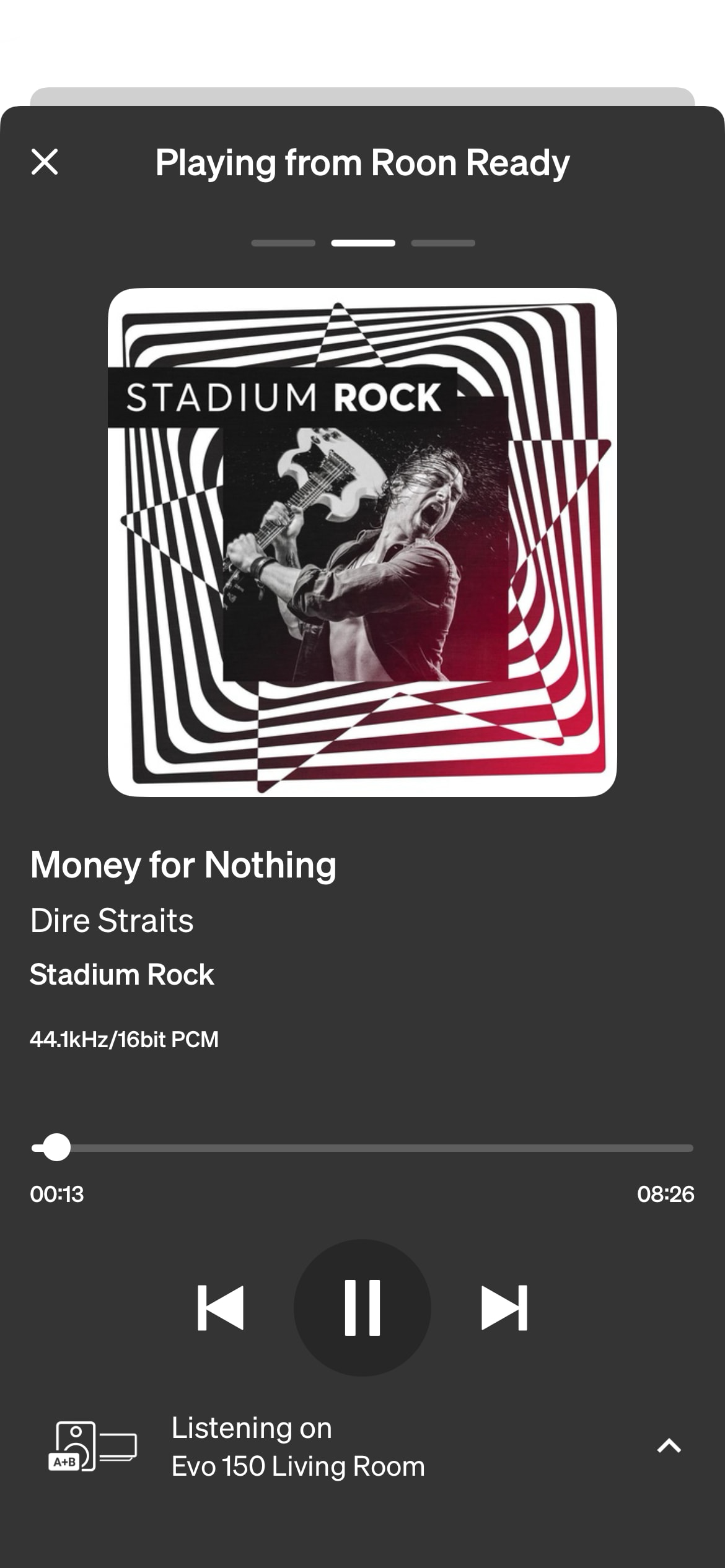

P.S. I can select Roon Ready from StreamMagic using the EVO150 and press play and it is playing in a shuffle mode.
However, I cannot see/connect to the EVO150 on the Roon app where I can usually select which device to choose for playback.
