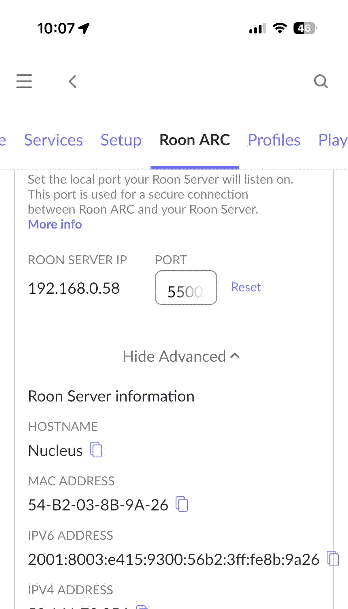

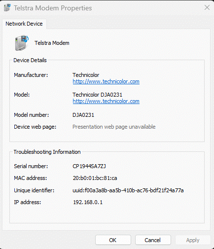

To your previous questions:
What is the make/model of router you’re using in this setup and where have you connected your Nucleus to the network?
The Router is a Technicolour DJA0231 connected as a telstra NBN mode m
The Nucleus is connected directly to the modem by wir e .
Do you have a mesh network? (Eero, Netgear, e tc.)?
No

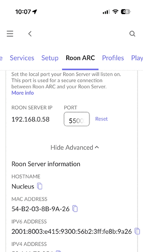

Please also share any diagnostic message you see in Roon Settings → ARC.
ARC is working with music downloading to Iphone.
The message at Roon settings – ARC – is “Roon ARC can securely access your Roo n Server”
The listening por t is 5500.
Here is the screenshot from the advanced se ctio n phone
Please assist further with any setting issues
Thanks
Hello @David_Clout,
I am glad we could get this thread reopened for you! Thank you for providing the router details and those screenshots.
The great news here is that your router configuration is spot on. Roon ARC is perfectly configured and fully operational, which is why you are seeing the “securely access” message and can successfully download music to your iPhone.
