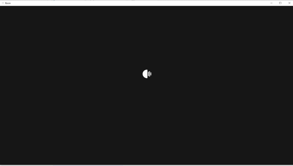

Hi! roon stopped opening on my PC, just hangs loading and that's it
I'm using windows 10
and I've already tried reinstalling the app and rebooting my pc.
Asus rog strix 16000

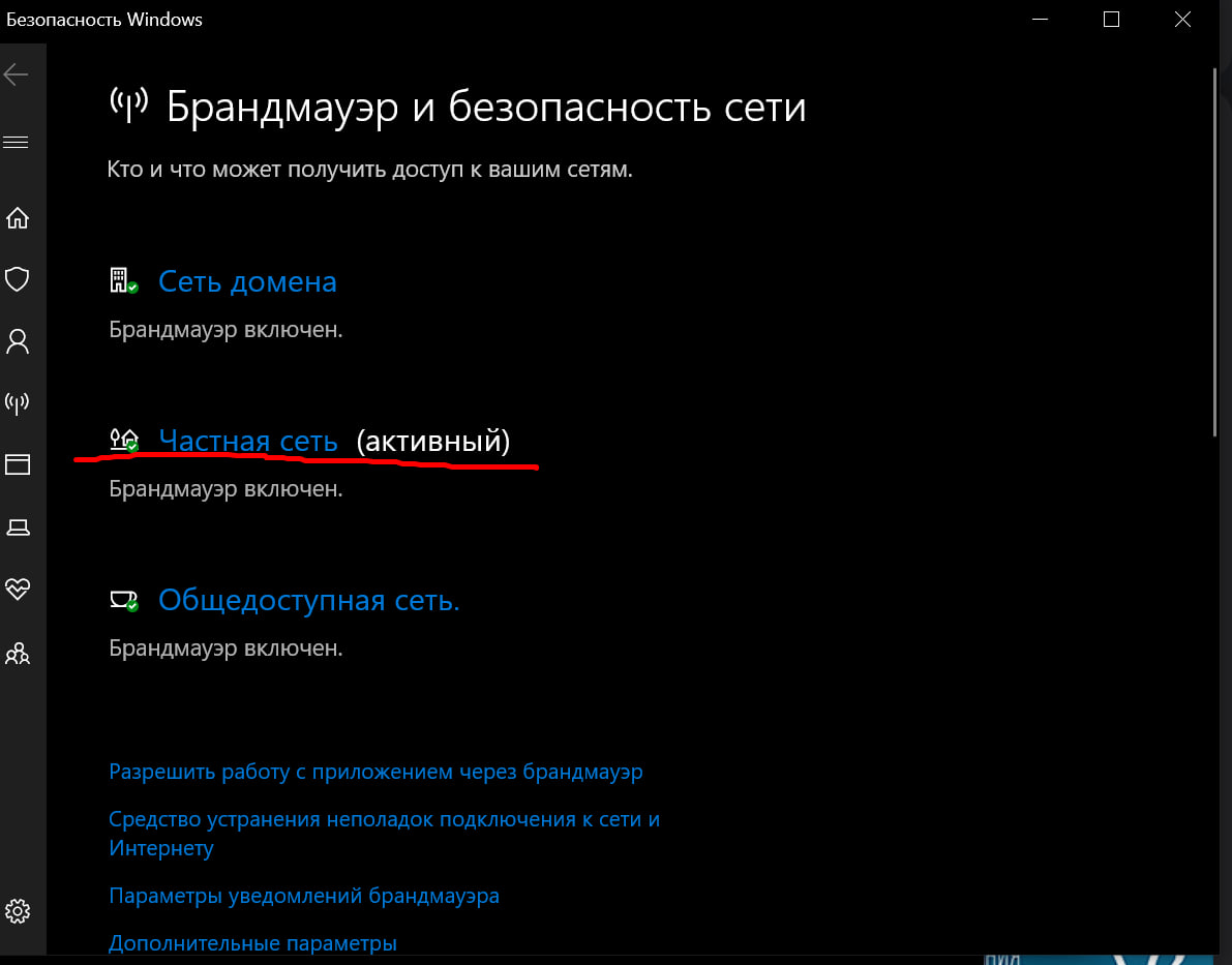

Thanks for the update! Can you please verify that all your Roon devices are running on the same local subnet within your network? Based on your server information, your machine may be running multiple subnets, which wont work with Roon.
With that, we’re seeing repeated Trace: [.NET ThreadPool Worker] [broker/accounts] network reachability changed. refreshing traces that could be playing a role in your failure to connect.
Can you please reboot your router, and make sure you have a direct ethernet connection from your PC directly to your router, bypassing all other network gear?
I’d also review your PC firewall settings. Since you are using a Windows PC, I would verify that both Roon.exe and RAATServer.exe have been added as exceptions to your Windows firewall.
You can use these instructions to add the exceptions and the executables themselves would be located in your Database Location/Application folder path.
I would also add these exceptions to any Antivirus or other Firewall blocking applications you may have and ensure that you connected to your network via a Private network, not a Public one, see this guide for more information.
Hi, thanks for the tips but it doesn’t help, let me know what I’m doing wrong. By the way, I could be wrong but I think the problem started after I bought a subscription to oneDrive for windows 10
