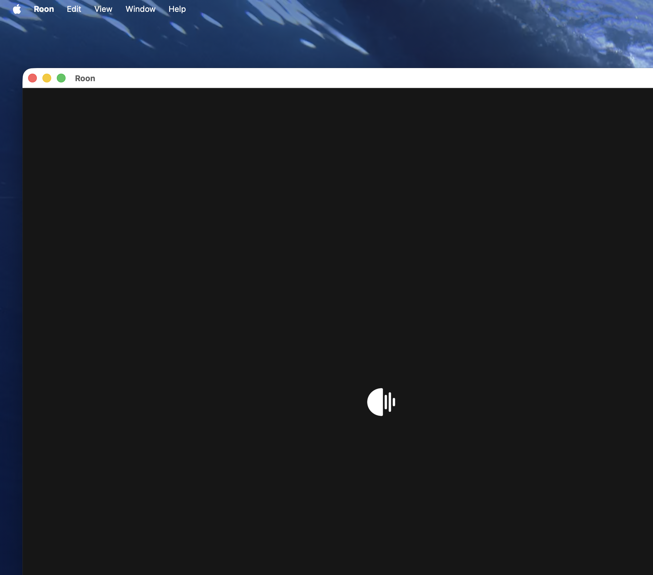

· Installed the most recent update on OS 26.4.1 (26 April 2026 install). On start, roon hangs on the app's logo page. Cannot open "about roon" or "settings" to tell you what version is hanging. Reboot of app and of Mac ineffective

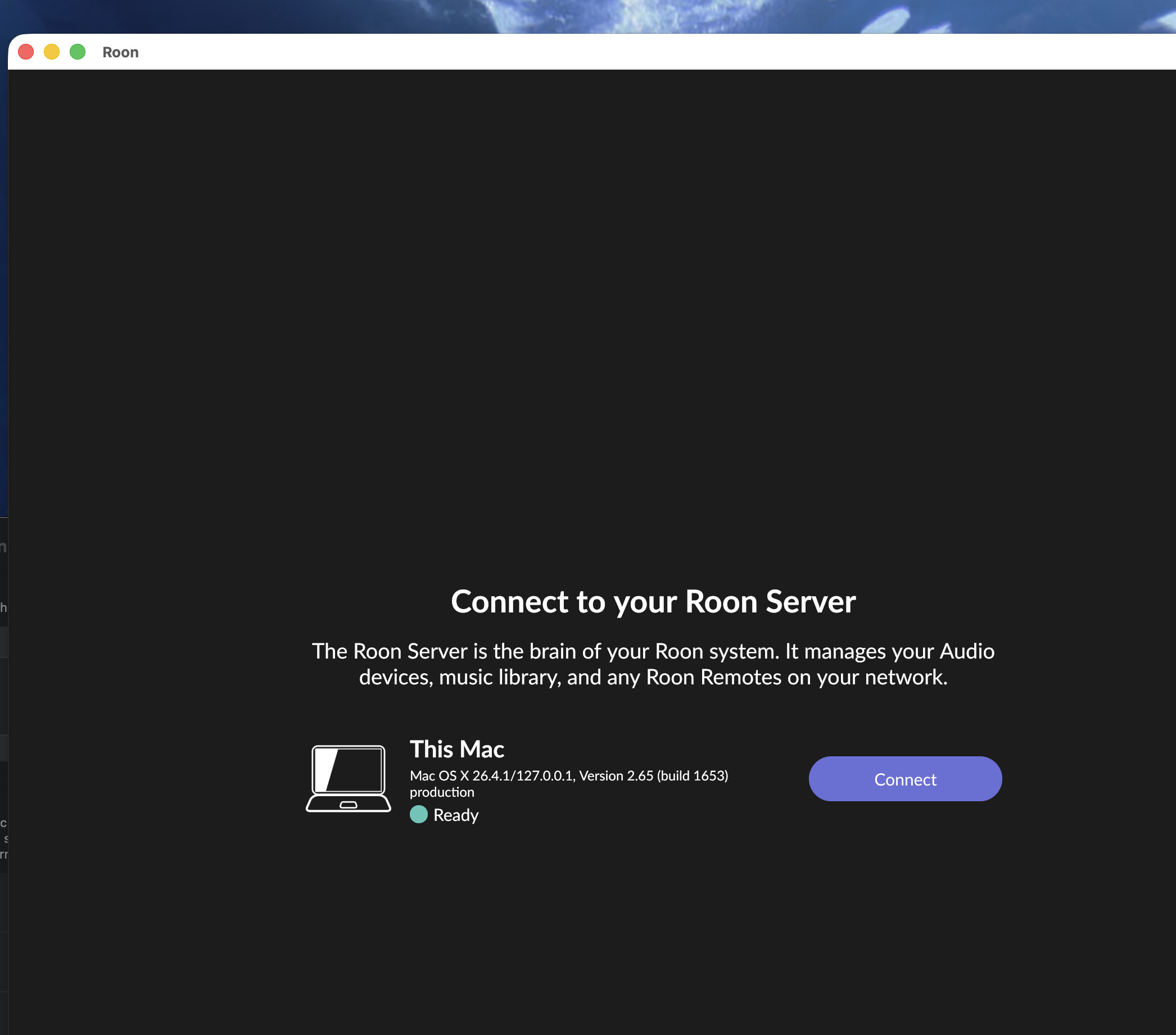

Reboot and no other apps and no firewall got me into roon. Two screenshots attached. When I choose connect from the “ready” page, it displays the neverending logo screen.

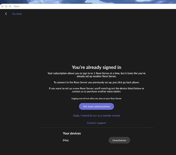

It’s this last screenshot. It believes I am signed in to a different roon server. Does it think I have two installs on one mac? Because I have no other device with roon.
This screenshot shows one device. If I choose “go back”, it’s the spinning roon of death. Should I “unauthorize” this mac? Well, gave it a go. That restored everything. Didn’t even have to log in again!
