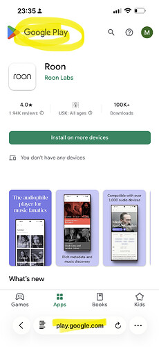

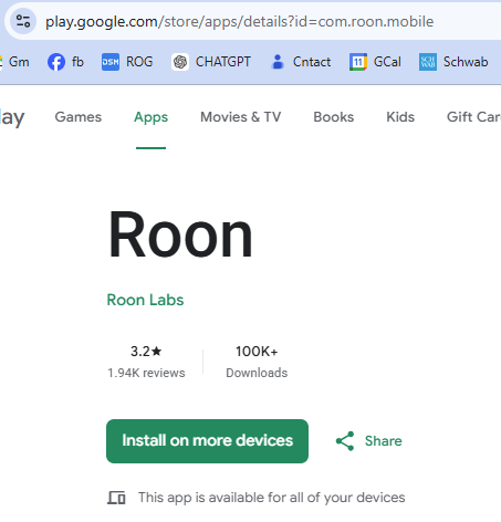

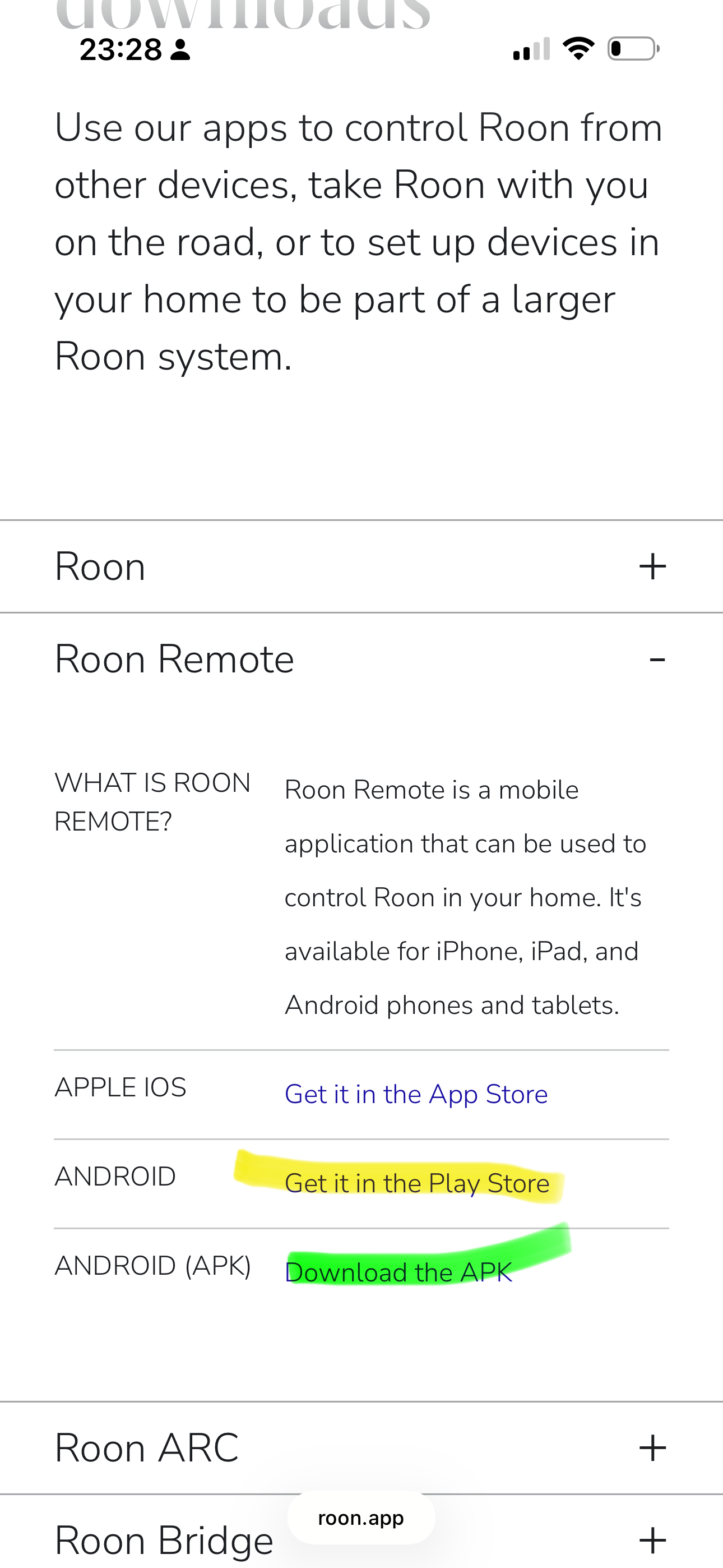

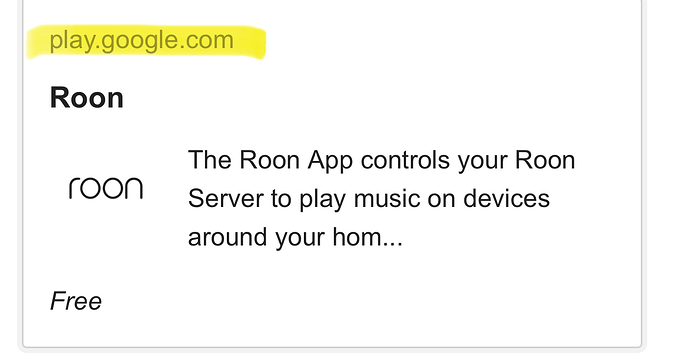

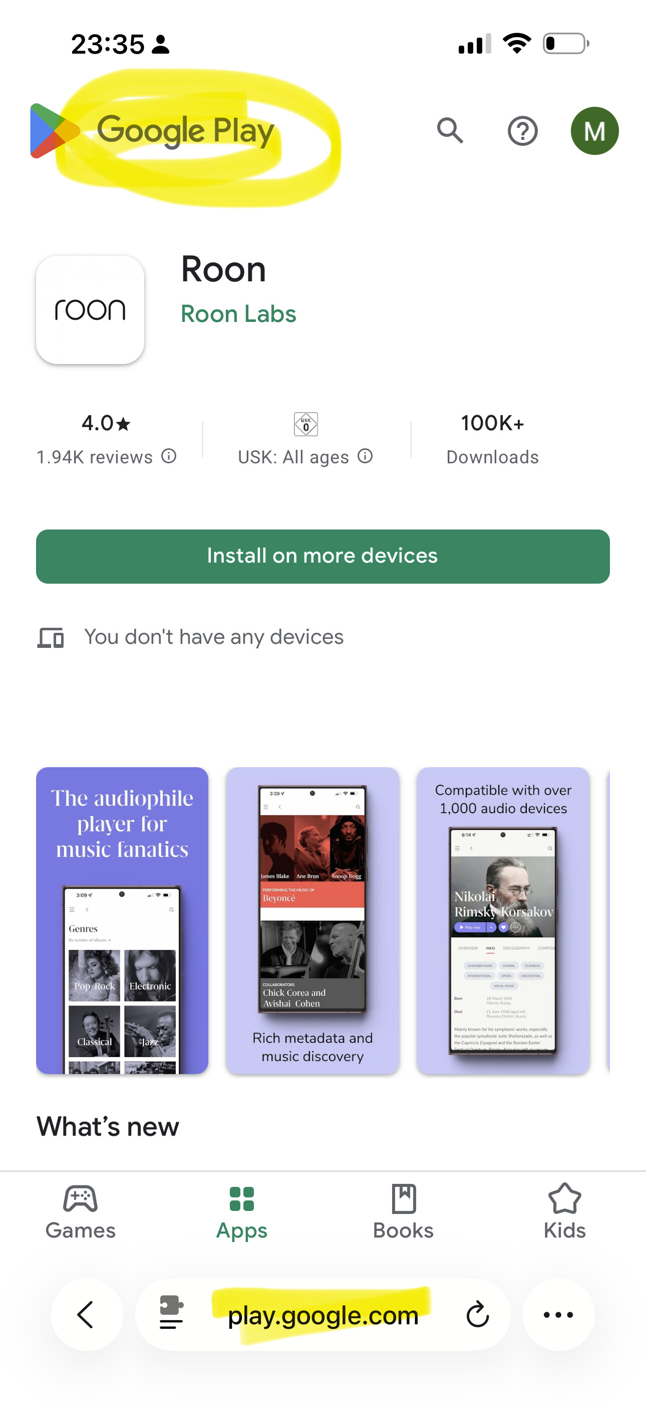

PS. The link from your website goes here. Is that the Playstore?
There are two links on the download page, Download Roon - Mac, Windows, iOS & Android Apps | Free Download
One goes to the Google Play Store, the other is a download of the APK package that can be installed locally on the phone.
Yes that’s the Play Store
I don’t get options.
I don’t know what you mean. And why don’t you open it simply in the Play Store app on your phone.
