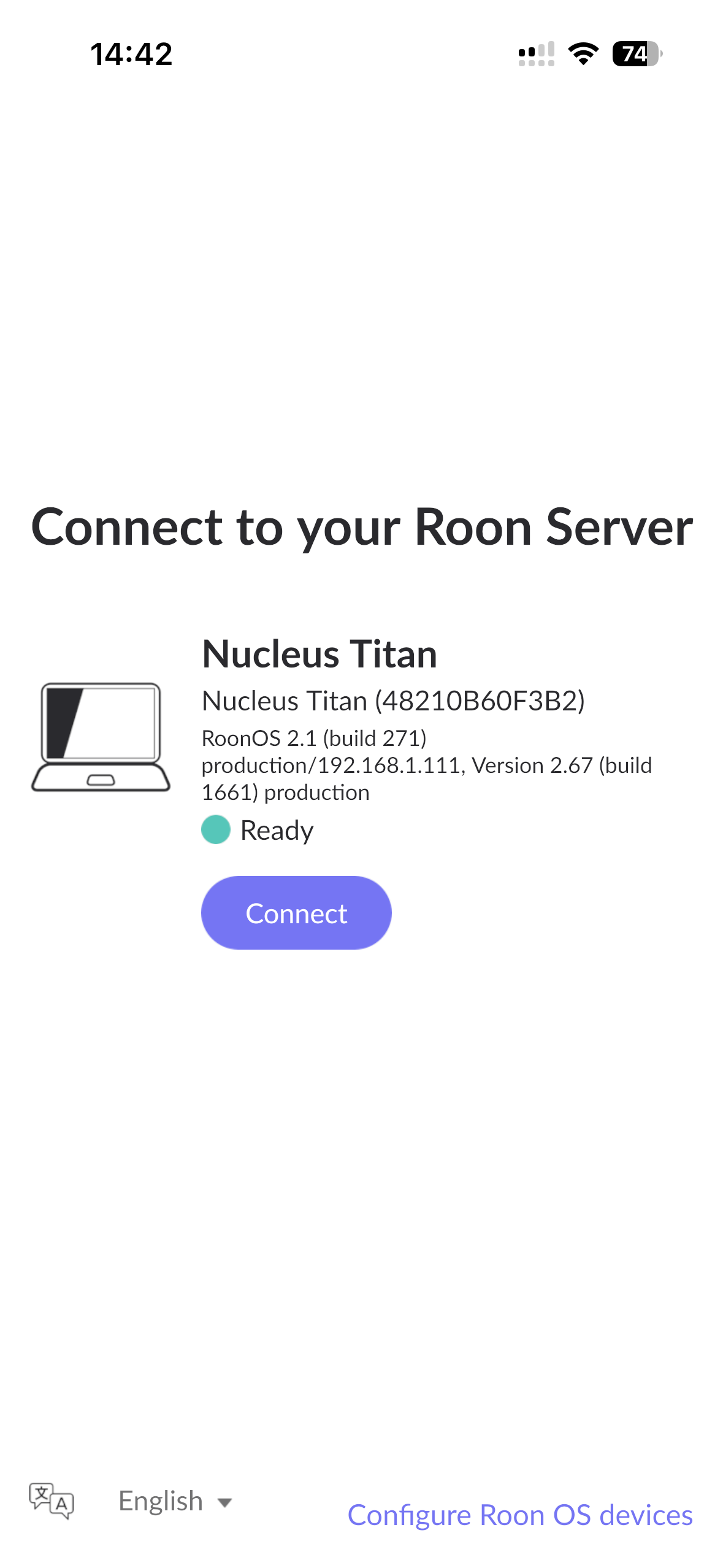

Thank you very much for your support! I’ve followed your advice + did twice reboot my ROON Nucleus Titan but without any success! What is strange: Nucleus is scanning more than 900k files totally but on the Nucleus internal storage there are only about 462k files now!!! I guess that the other about 500k stems from Synology NAS probably when it was earlier connected to Nucleus! I didn’t use + connect it with Nucleus anymore since I had problem to integrate Synology NAS in ROON too → See 3 attachments too!

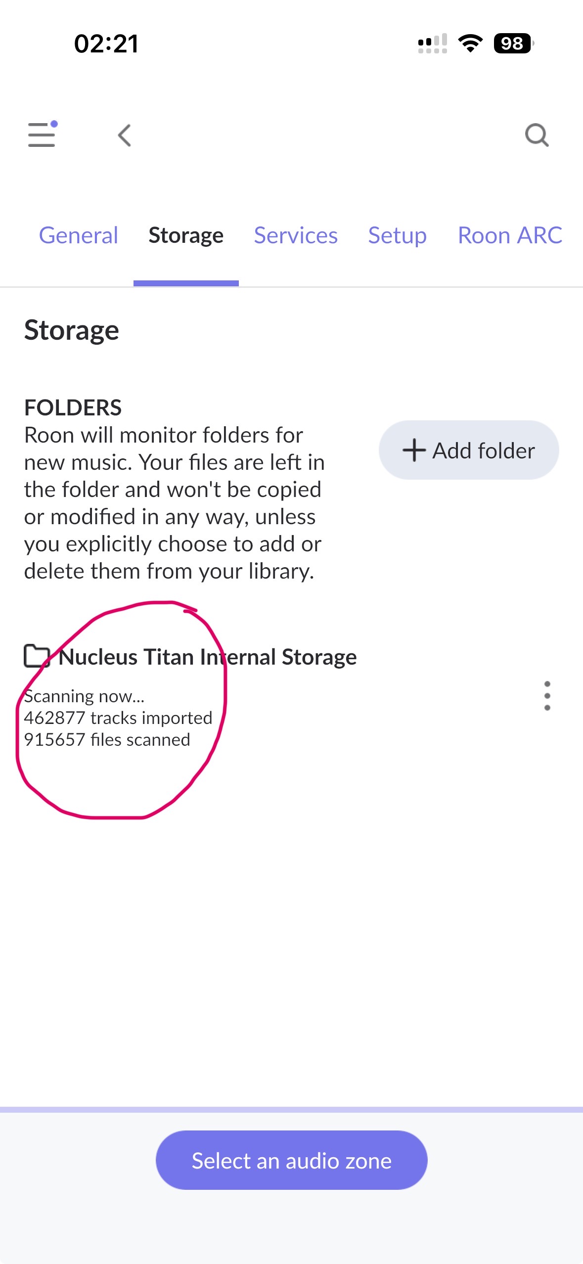

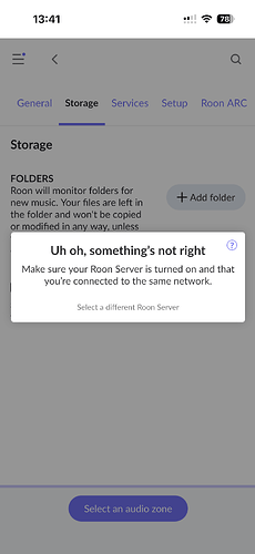

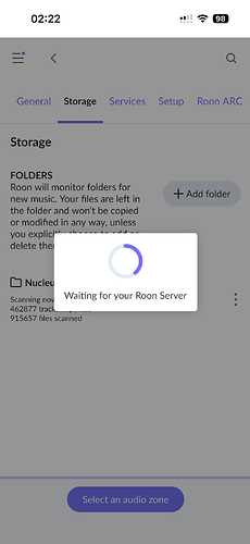

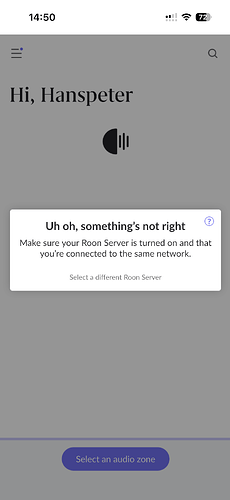

Good morning dear Vadim

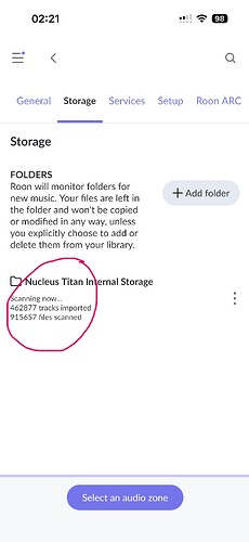

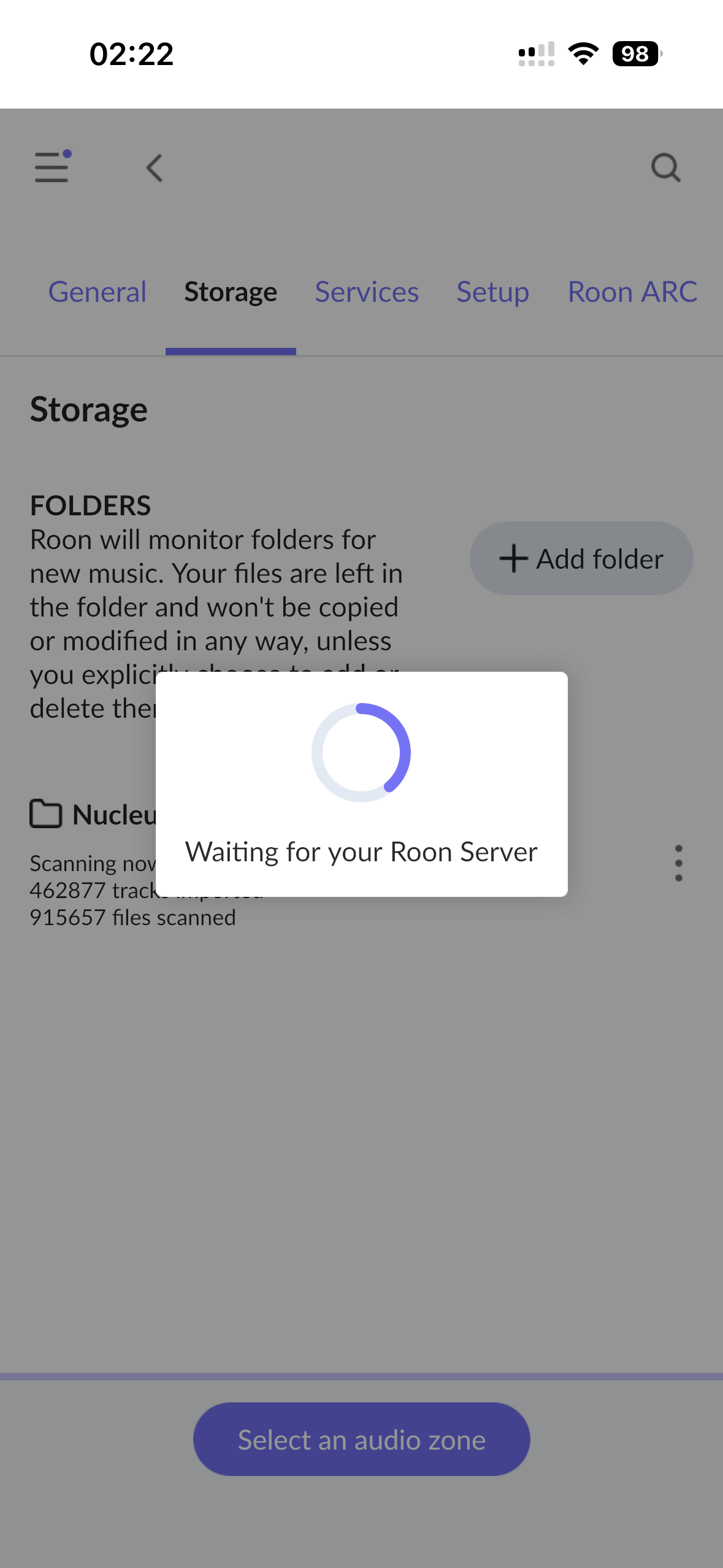

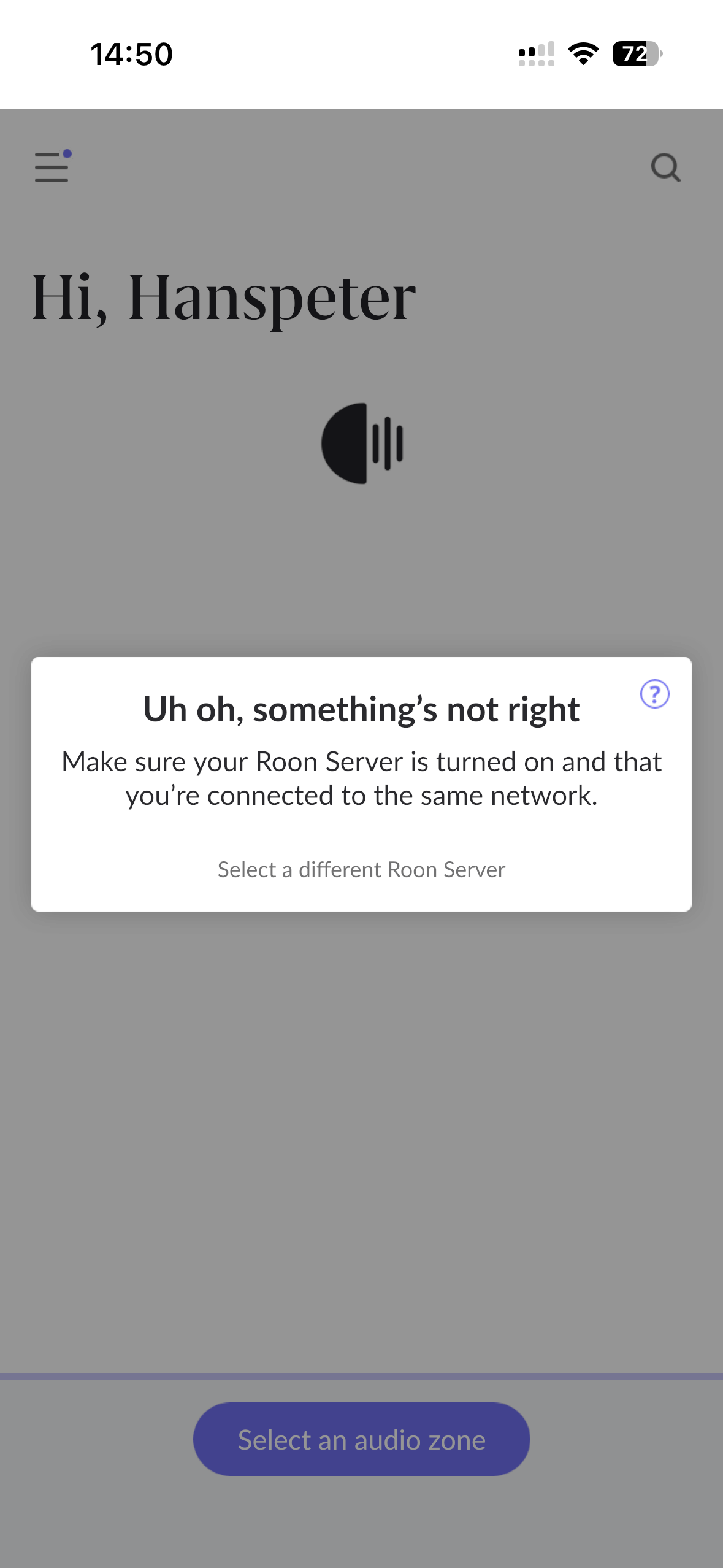

This morning the same pics from my ROON App on my iPhone 14 Pro! No improvements so far! On the rubrik Storage I could see again that Roon is scanning files up too 823’846 files too then again the two ‘"error’" messages as attached!
Don’t know if it would make sense to reinstall the ROON Program on my Mac Studio too!
Mac Studio + Nucleus are on the the same Network, visible on the Router too + both with a valid IP address too, Nucleus’s one 192.168.1.111
Sent the above information just to update you!!!
See my 3 attachment below too!
Kind regards
Hanspeter Dettwiler from Switzerland

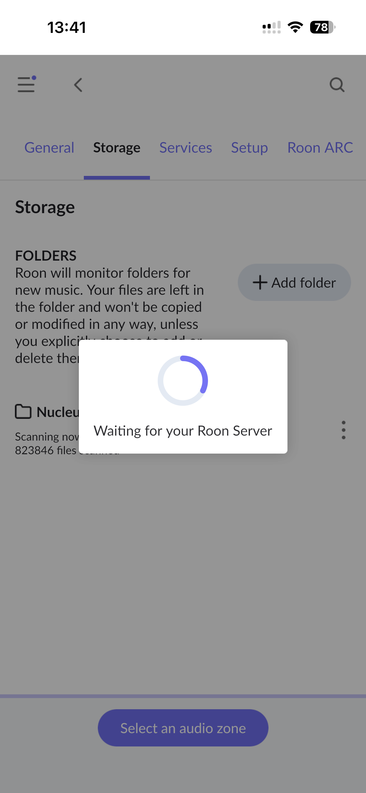

Dear Vadim

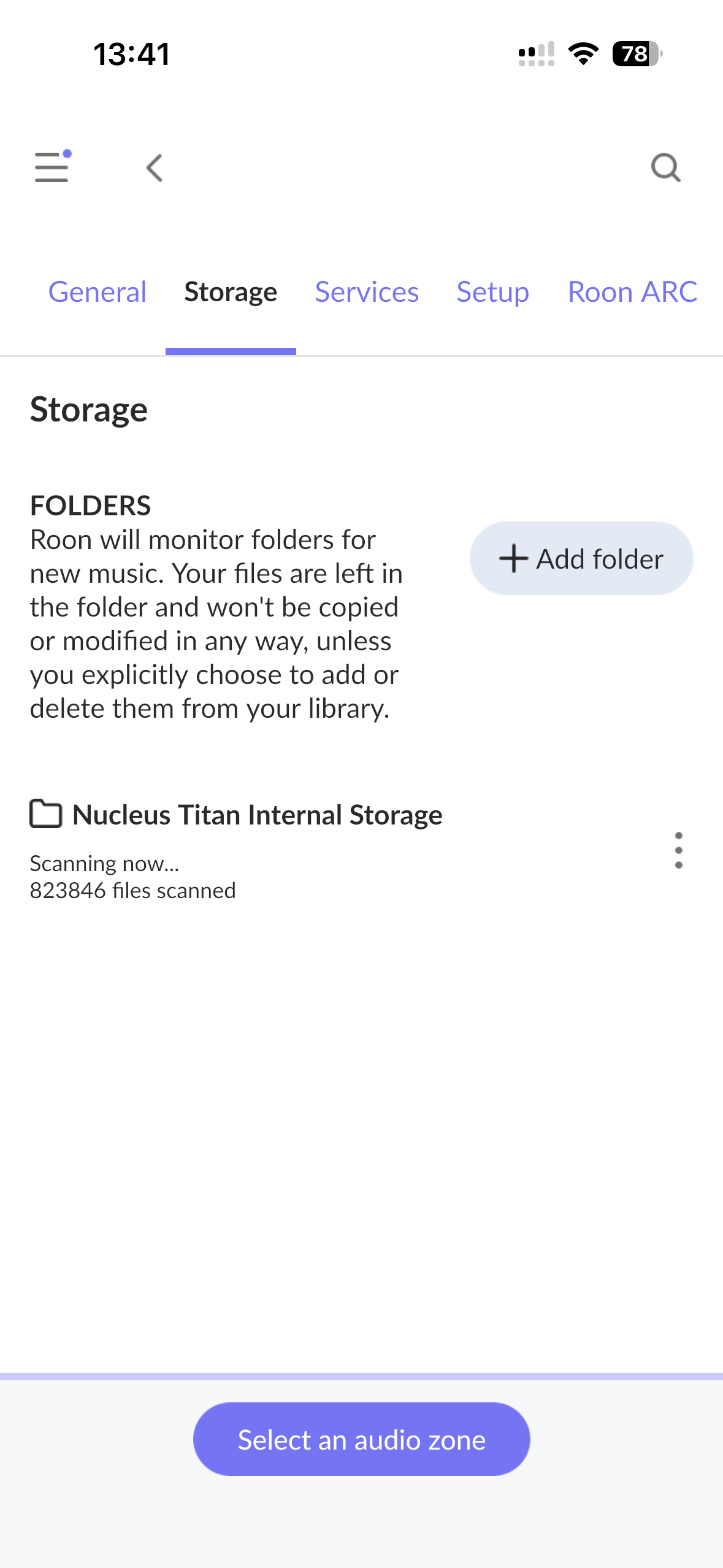

Why is my Nucleus Titan scanning 827’612 files whereas I had just about nearly 500’000 on my internal storage too???
And do you know roughly how long it will need to solve my problem too?
Kind regards

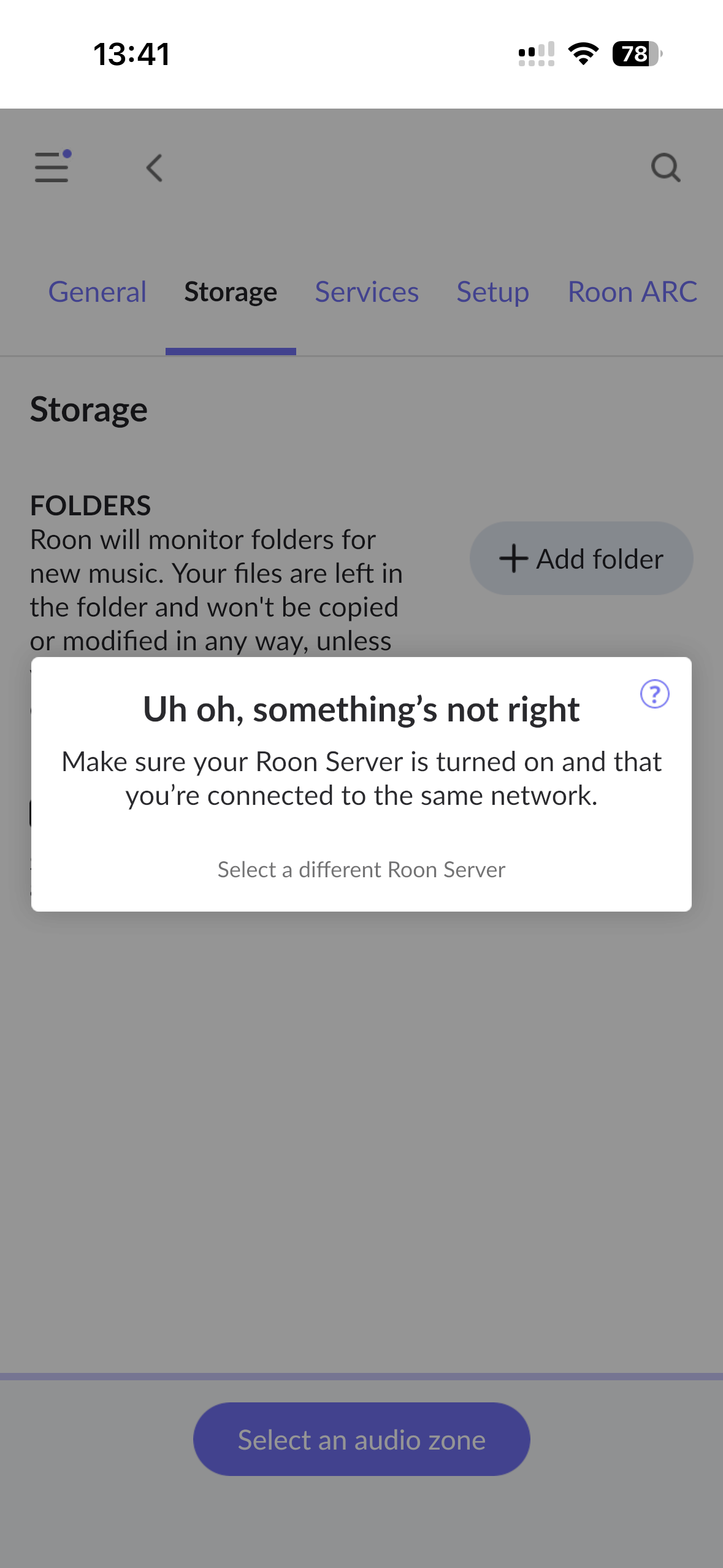

Good morning Vadim

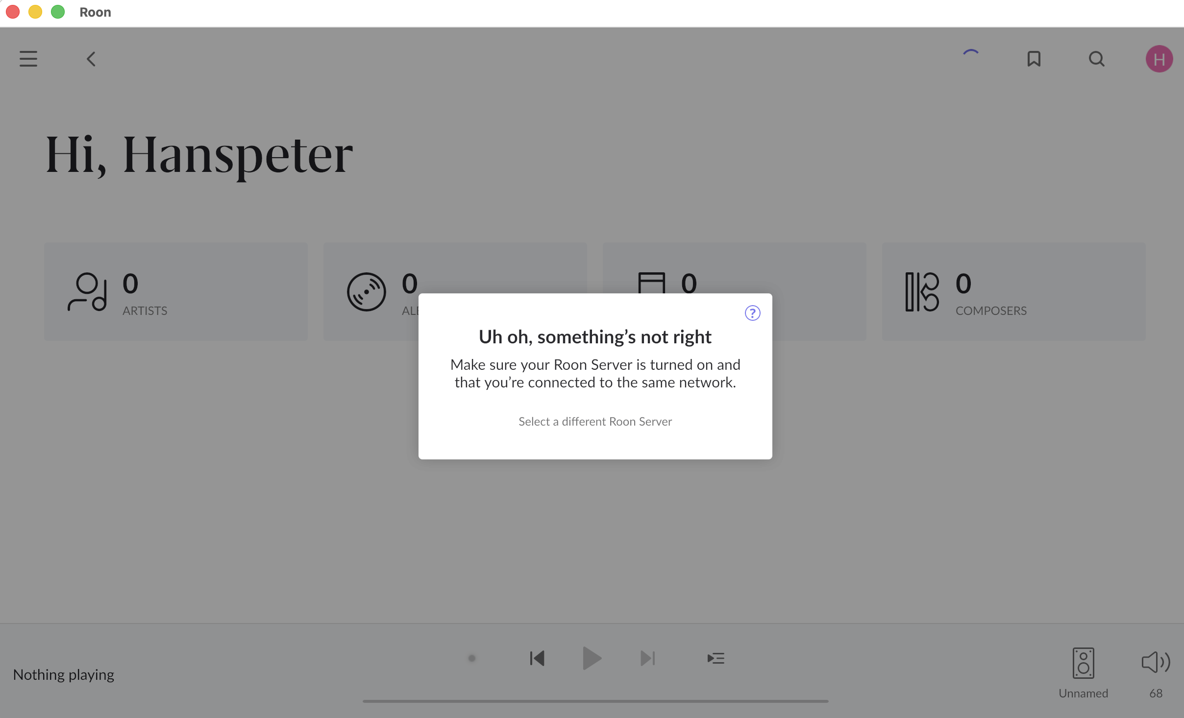

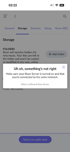

I’m getting this ■■■■■■■■■■■■ message below again + again! I’m calling it that way cause it’s a standard one + it’s not refering to the real problem too!!! My Nucleus is ON, is in the same Network as my Mac Studio too, Fire Wall is OFF too, I can see it in the network with a valid IP address too (192.168.1.111), I’m able to get + see all my files from my Nucleus’s internal storage (8TB) via Network too but the ROON App on my Mac Studio + iPhone isn’t able to show me any music resp. Albums too!!!
I’m really in a very bad mood currently + I wouldn’t recommend a Nucleus Titan to anybody too!!!
So please take my problem seriously + solve it as soon as possible too!

From the diagnostic data, we can see that your internal storage contains 939,923 files - this is an exceptionally large library, even for the Titan. The scanning and analysis process for a collection of this size will take a significant amount of time, and this is expected behavior rather than a fault.
At this point, the best course of action is to let the Nucleus finish scanning all files without interruption - please avoid rebooting it while the scan is in progress. Once the scan is complete, please report back and let us know if you experience any performance issues.

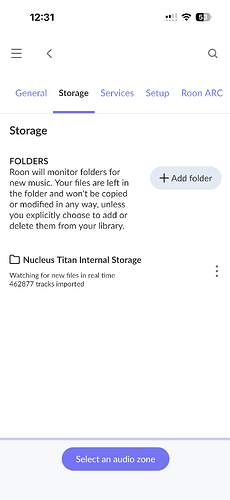

Thank you for your patience. We’ve reviewed the latest diagnostic logs from your Nucleus Titan, and the picture has changed since yesterday.
The good news: the import process was making steady progress. The bad news: it has now stalled on one queue chunk of your library, and the Titan is currently caught in an out-of-memory loop — the server runs out of RAM while processing that chunk, crashes, restarts, hits the same chunk again, and repeats. This is why the app keeps cycling between the Roon logo and the “Uh oh” message.
The underlying issue is the sheer size of the library. With over 900,000 tracks being ingested, the database simply exceeds what the Titan’s memory can handle.
