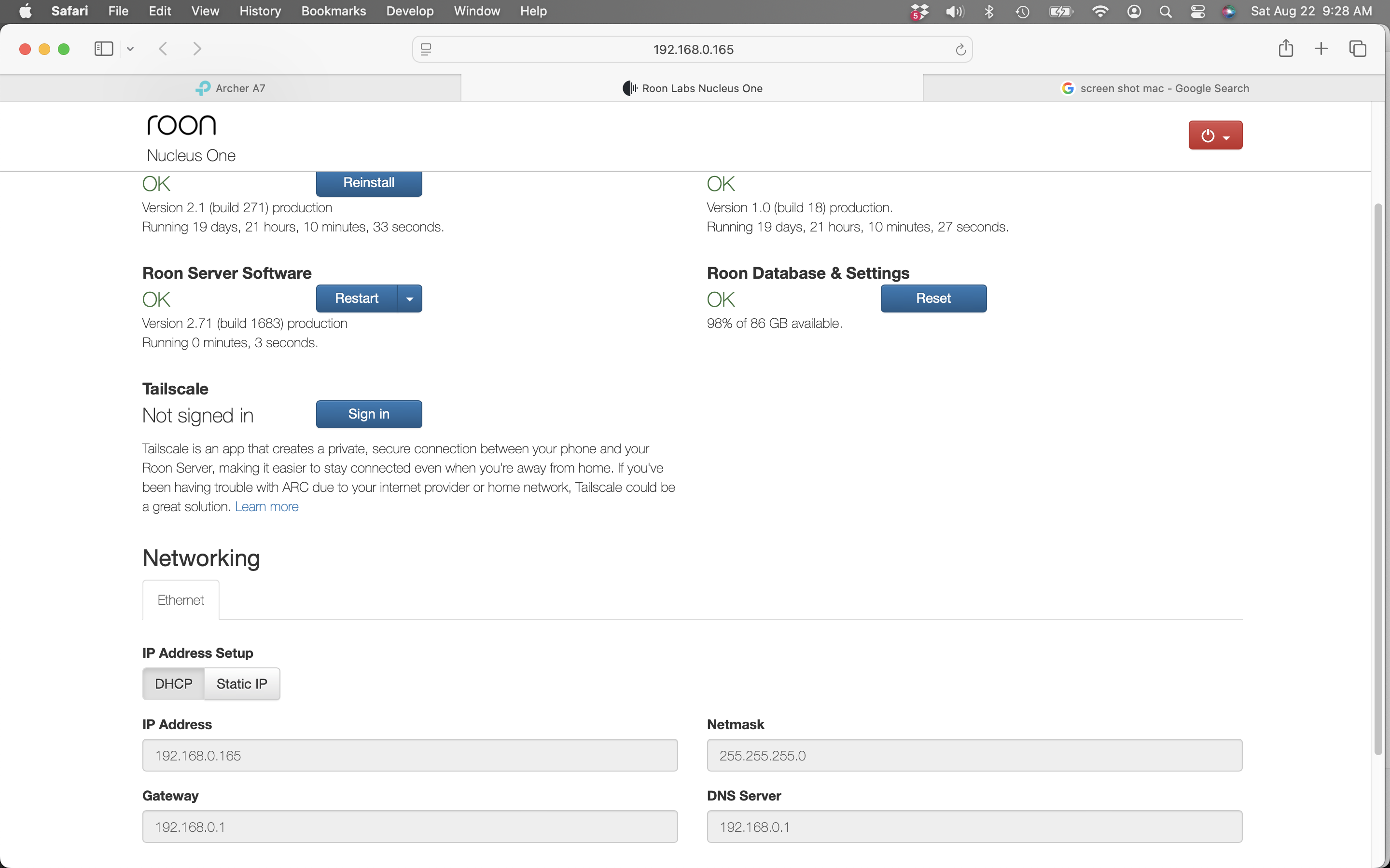

The roon app on my laptop keeps losing connection to the Nucleus One. This has happened MANY times in the last 4 months. But when I look at the Nucleus on the internet portal it is there and running. If I reboot it then the app will find it. If I restart just the OS then it does NOT fix the problem. I am running Version 2.1 (build 271). I reinstalled the OS 19 days ago. ACTUALLY, I just rebooted and it did NOT solve the issue. I cannot see it on my Mac laptop OR my iPhone

We are not able to see your Nucleus One in our diagnostic system. Please try to perform an Operating System reinstall (top left button in your WebUI screenshot) to see if that helps, since you mentioned it’s been 19 days since the last reinstall. Let us know how it goes!
