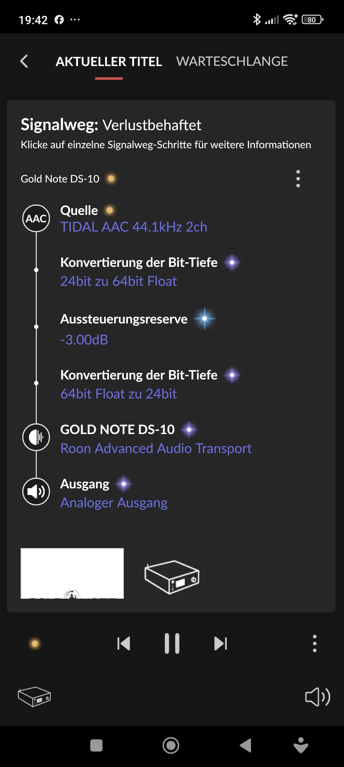

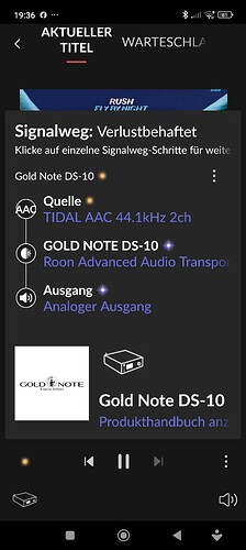

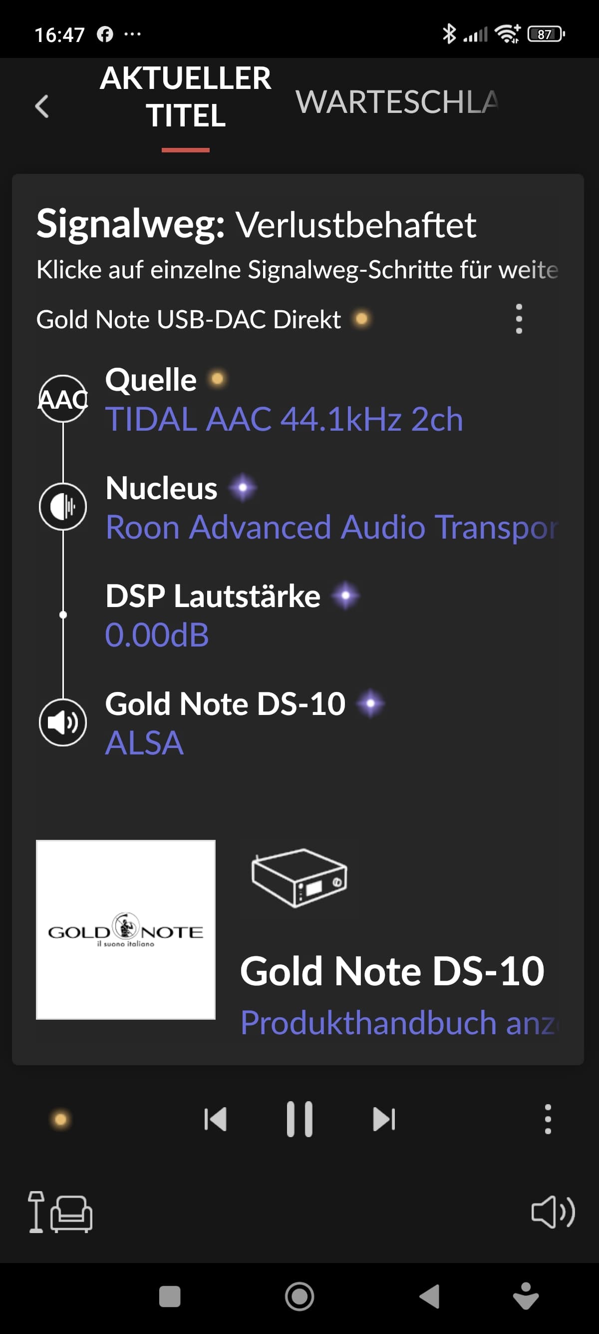

I’ve attached a few screenshots that might help you with troubleshooting.

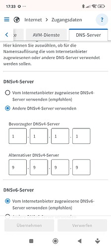

As an immediate step, please ensure that the DNS server assigned in the Fritz!Box settings admin page is reliable. This is usually under Internet → Enter Data → DNS or similar. Please try assigned Cloudflare (1.1.1.1) or QuadNine (9.9.9.9), which are known to reliably resolve the URLs associated with tracks from Qobuz/Tidal.

I have entered Cloudflare (1.1.1.1) and QuadNine (9.9.9.9) in my router settings.
All devices were restarted, but as I mentioned before, I still cannot play any music.

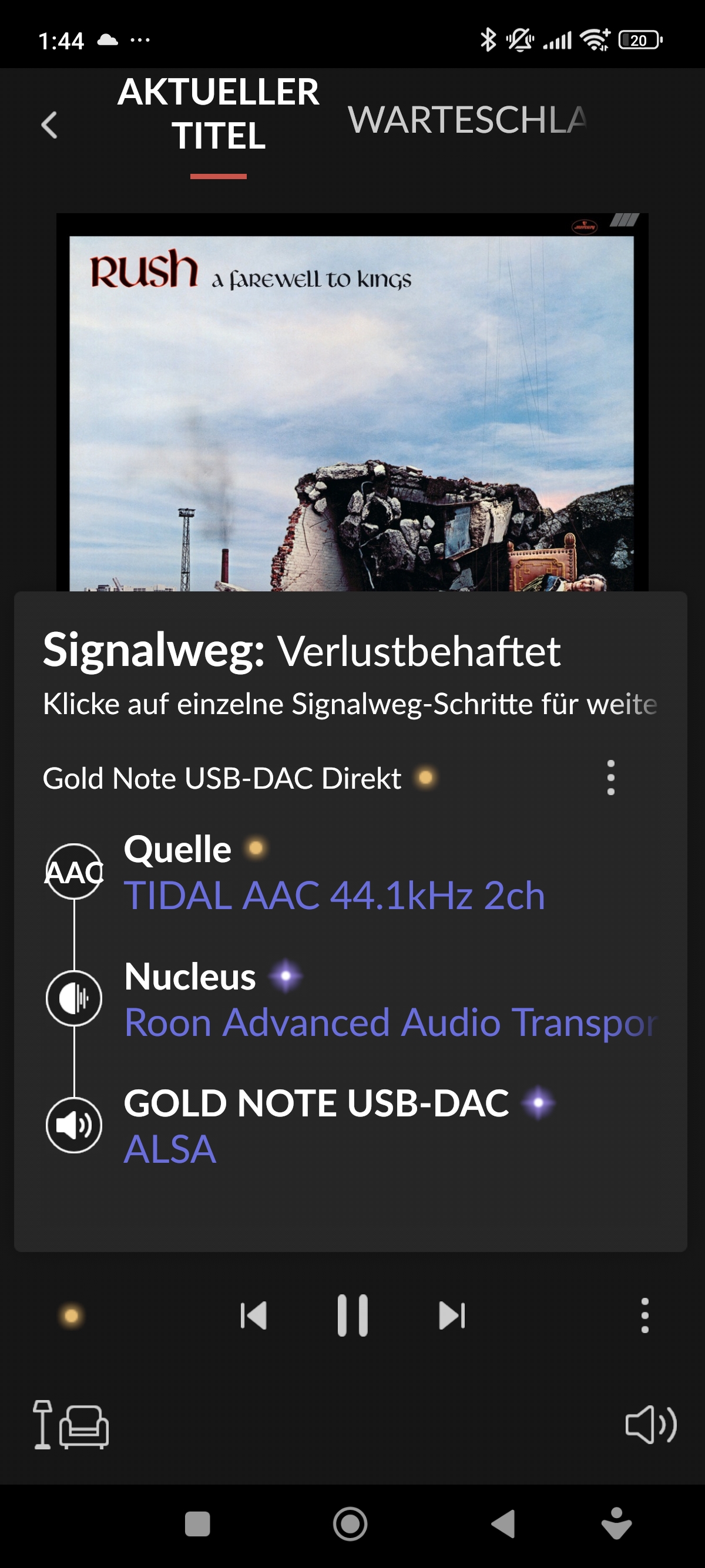

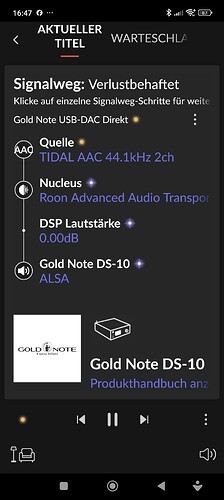

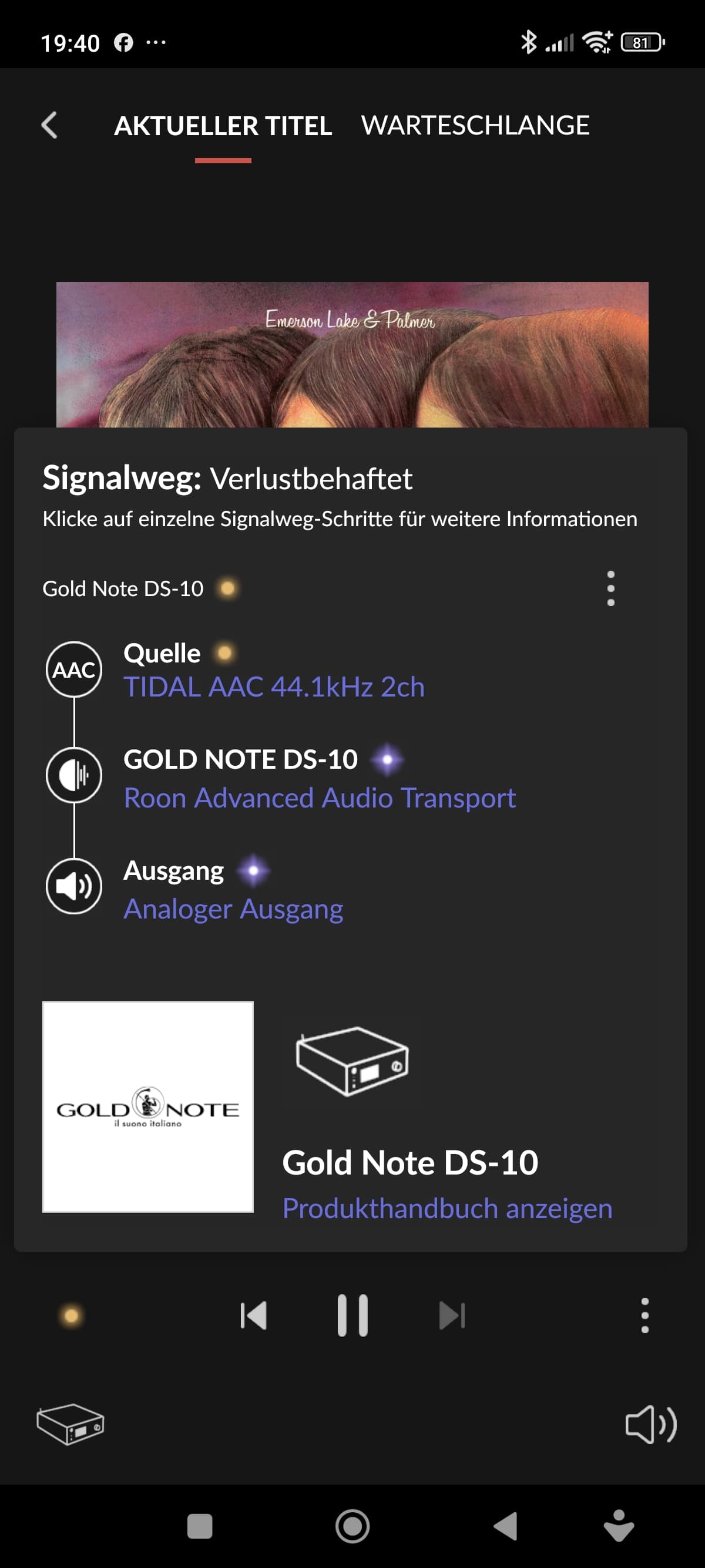

Hey @hweise,
Thanks for the update! From a fresh diagnostic report, we see that when Tidal content is played, the buffer gets stuck at 11%, and playback never actually starts:
Trace: [Gold Note USB-DAC Direkt] [LowQuality 7.5x, 24/44 TIDAL AAC => 24/44] [11% buf] [PLAYING @ 0:00] A Fortune In Lies - Dream Theater
We noticed it was also playing AAC - could you double check your Roon Settings> Services > Tidal > Playback quality, and see how things perform if you set it to max?
We’ll be on standby for your reply and results. Thank you! :folded_hands:
Hello Roon Team,
everything seems to be working perfectly again. I’ll keep an eye on it over the next few days.
