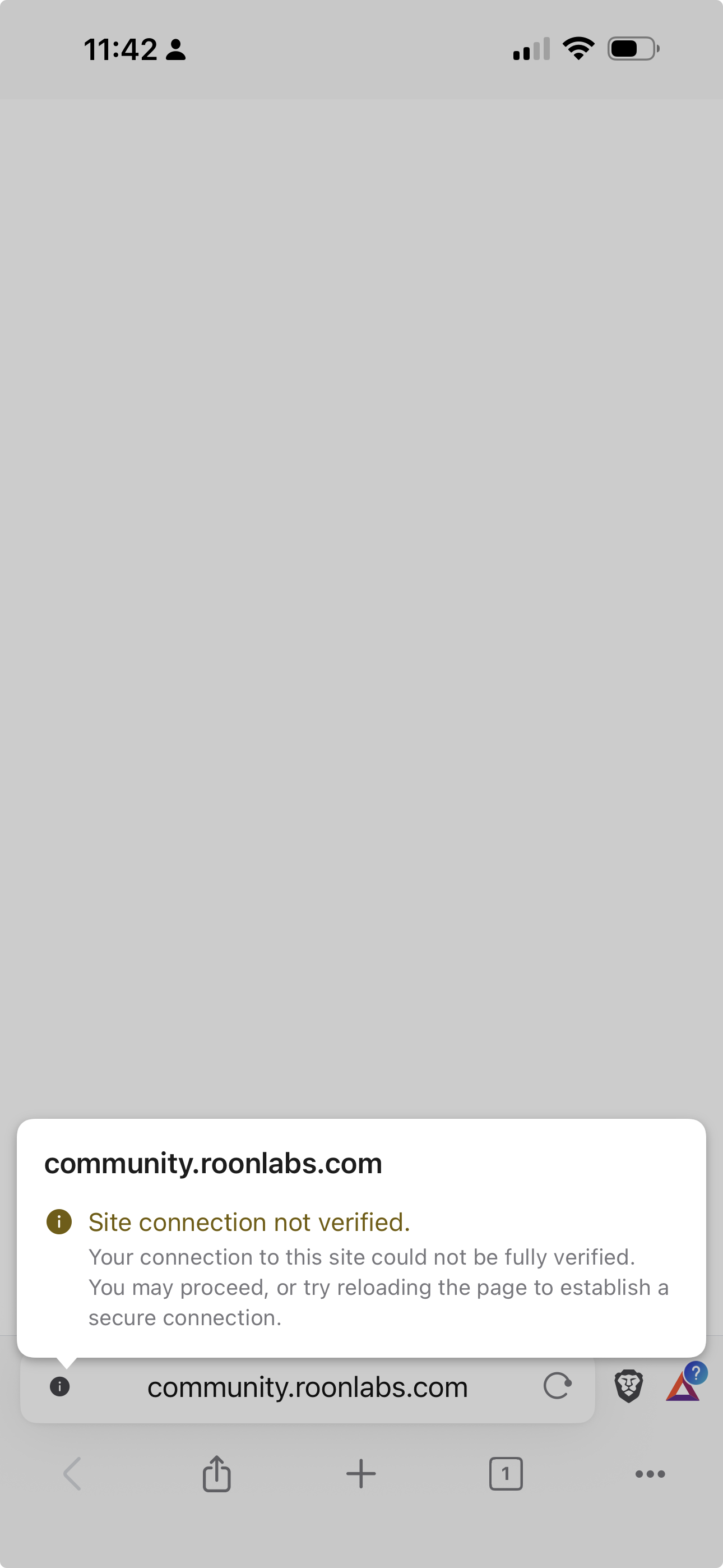

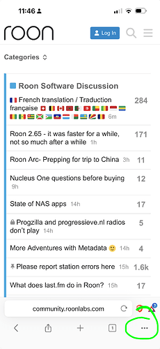

It’s some stale cookies or certs. I got this on iOS:

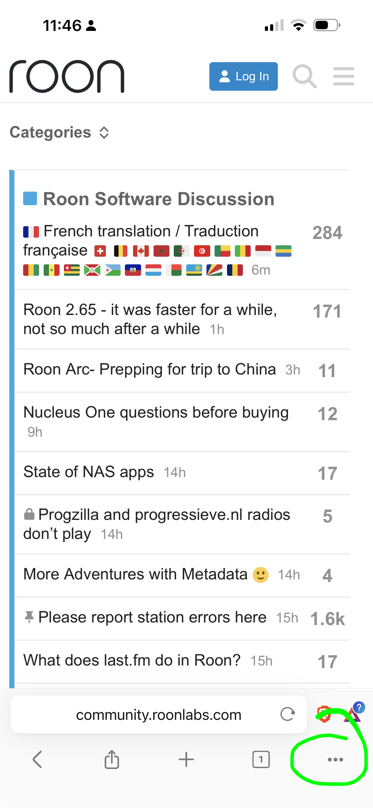

In Brave, when you are on community.roonlabs.com, open the site settings,

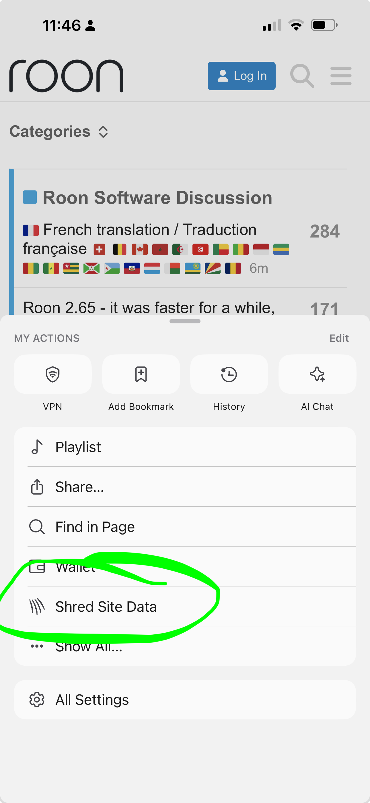

Then tap Shred Site Data:
It should load afterwards.

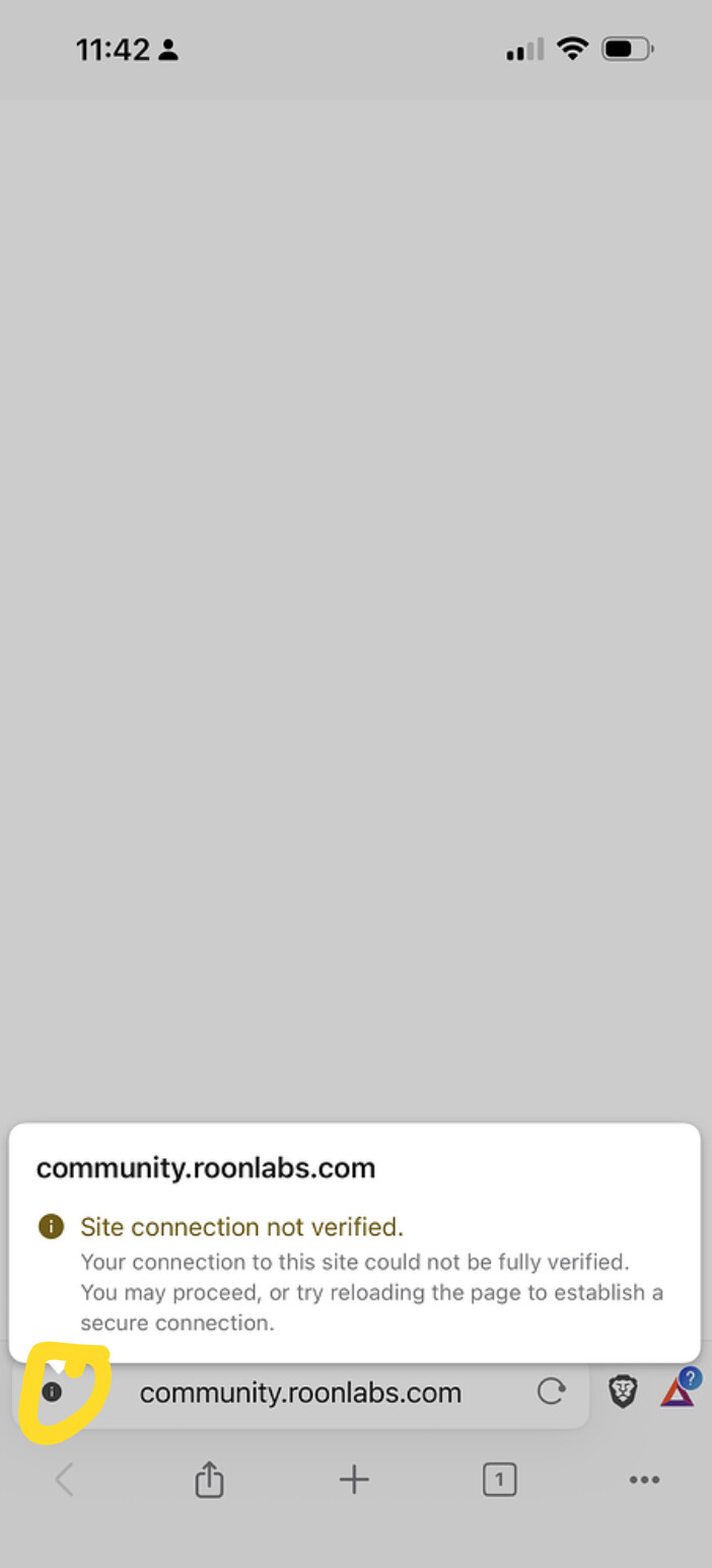

Do you get the same warning as I did in the info box?
Nope, nothing, after I click on the community link in the Roon app I stay on that same page.

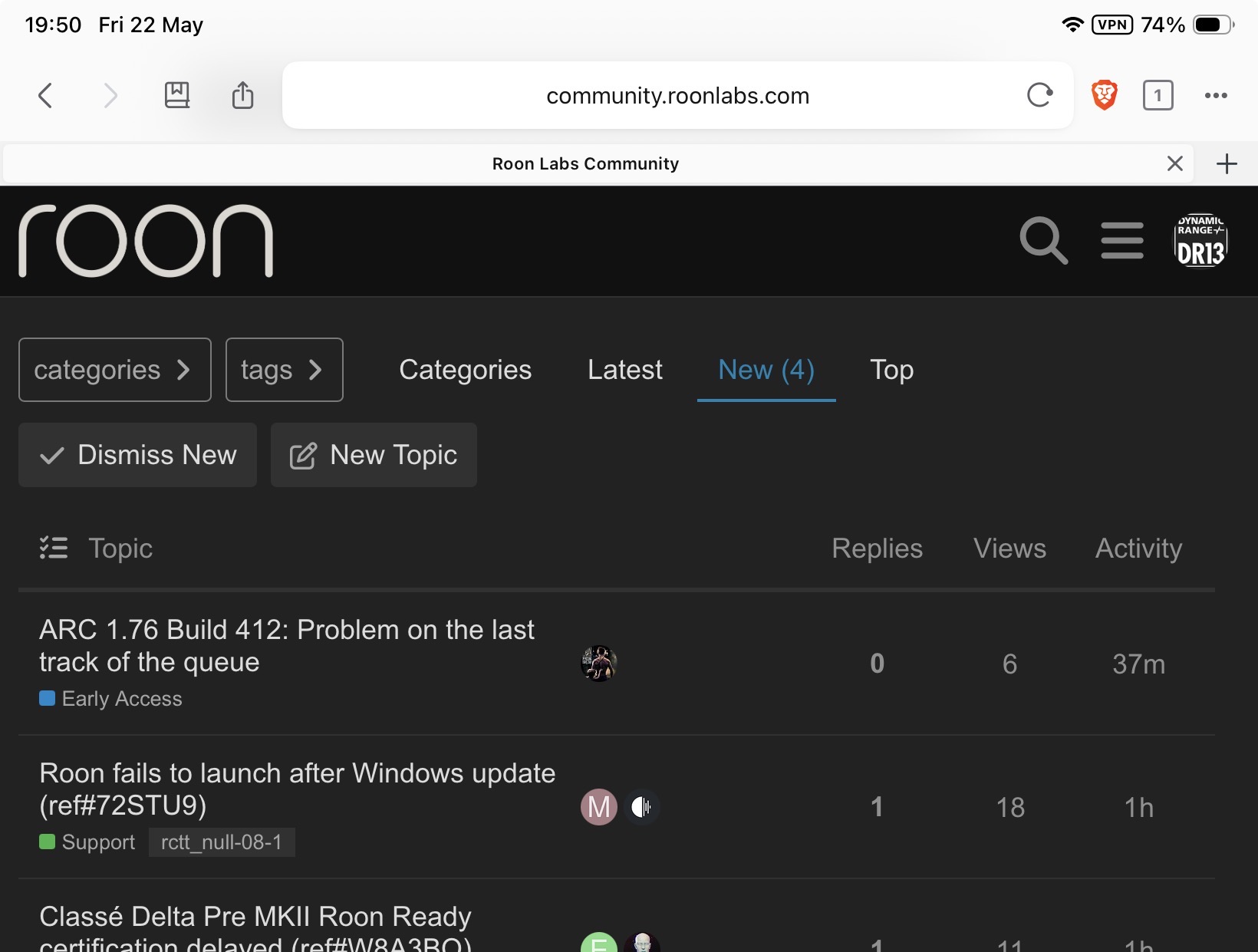

I have just checked on my iPad and it happily takes me here, I’m sure it must be an iPad setting that you need to find.

Well did you click the :information_source: button to the left of the address bar?
I must be stupid, I do not see the [i]
This is what I see:
OK seems Brave looks different on the iPad, I only have it on the iPhone and there is the “i” on the left of the address bar like in the screenshot that I posted previously, but perhaps only if there is an issue with the site (it’s now not there anymore for me after I fixed the issue):
But now I’m confused because I thought the issue was that community was not loading at all in Brave (which should cause the “i” button to appear), but I see now in your screenshot that it did load.

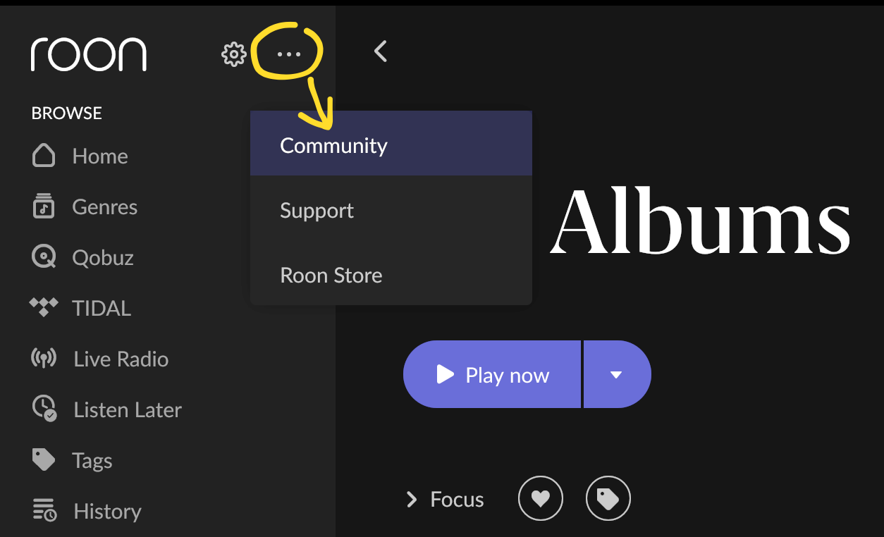

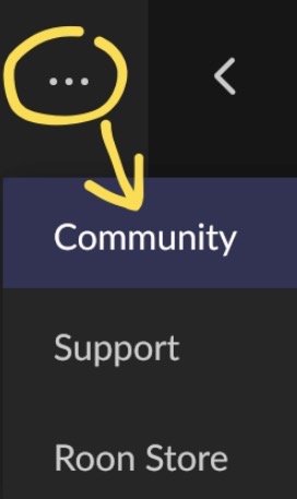

So it seems that I misunderstood what’s happening. Is the real issue that you want to open the community from here in the app …
… but then this does not work with Brave as the default browser? In this case, sorry, I have no idea. One would think that the Roon app just calls the macOS service to open the proper default browser. It’s possible that either your Brave isn’t properly registered as the default browser (can other apps open it correctly?) or that something is wrong in the Roon app causing this.
Maybe I did not explain it very well, sorry for that. It is indeed clicking on what you made yellow.Brave is installed as my default browser, Safari is deinstalled, so Brave is the only browser present on my Ipad.

The “problem” occurs with all 3 links, see below.
