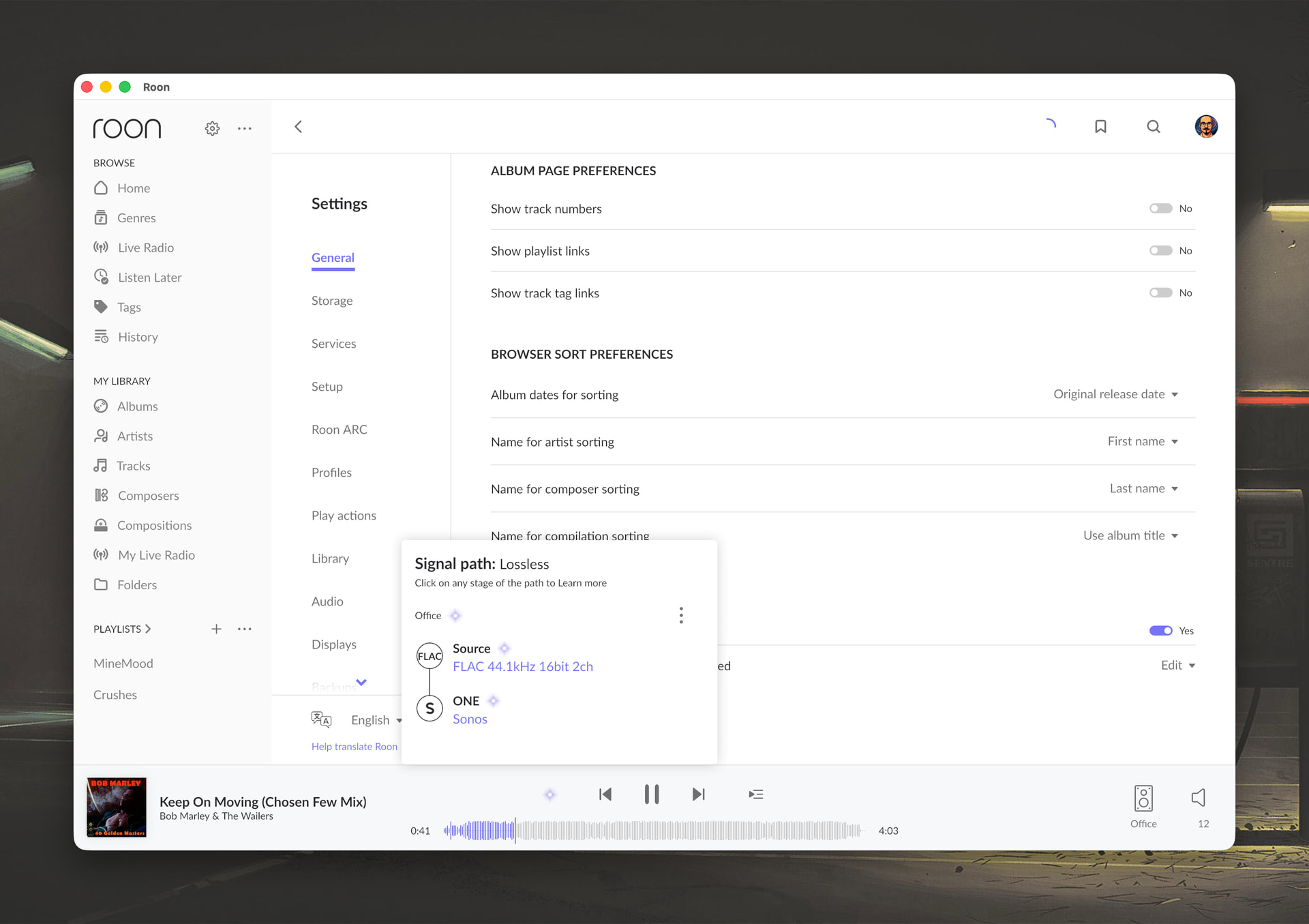

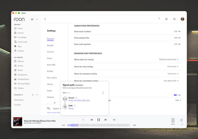

Here’s a fresh occurrence with a timestamp, screenshot attached:
  • Date/time: September 5, 2026, around 18:55 local time (UTC+3, Istanbul)
  • What was actually playing: a remix track by Mor ve Ötesi
  • What the macOS app displayed: a different track
  • Extra detail that might help narrow this down: the progress bar/timeline on the (incorrectly) displayed track was visibly advancing much faster than normal playback speed - clearly not just a stale label, but a timeline that’s also running at the wrong rate.
