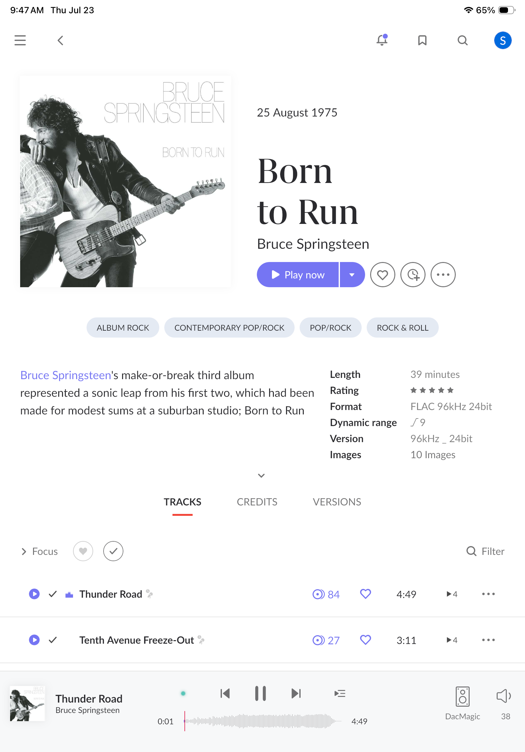

That is correct. Roon app on my iPhone will play to any zone. Roon app on my iMac and iPad will not play into any zone. The iMac and iPad apps appear normal and will allow me to select tracks from my library, but when I select Play there is no sound.
I just tried again to play tracks with iMac app at 3:00pm Mountain Standard time on July 24, with the same result: no sound. I then tried with my iPhone app and heard normal sound.

Thank you Benjamin for your clear instructions. The Roon AP on all three devices now work.
The Local Network and Firewall settings looked correct, but when I checked the DacMagic zone I found that I had two options labeled DacMagic. I switched to the other DacMagic zone and immediately had music. Thanks again
