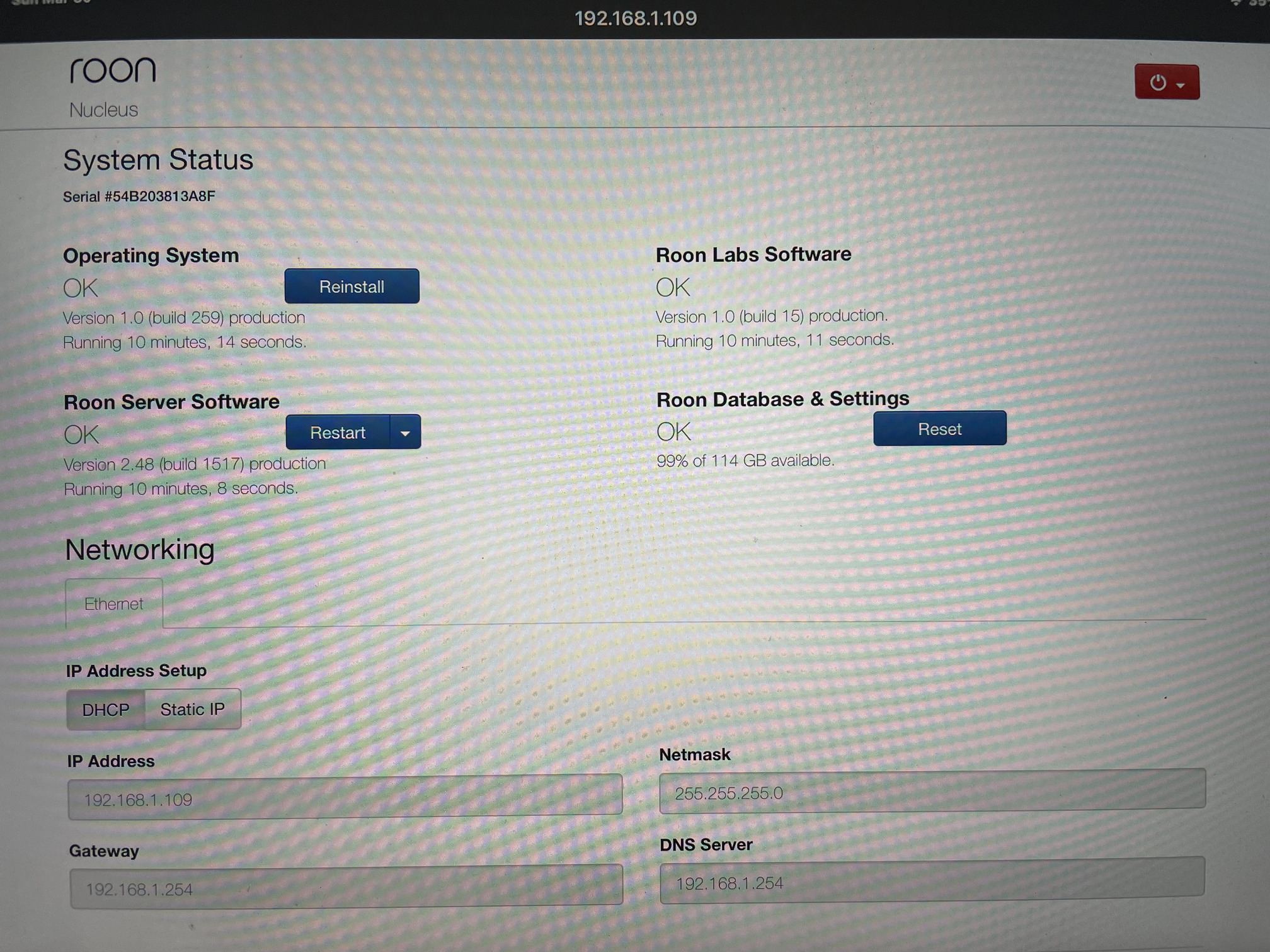

Hi @kgottschalk,
Thank you for your post. Can you please share a screenshot of your Nucleus Web Administration page? The diagnostics available to our server from the machine indicate that it might not be logging network activity as expected, so we’d like to see the status of the machine’s network interface.
Thank you! We’ll watch for your response.
Hi @kgottschalk ,
Thanks for the screenshot, that appears to be normal and working as expected. If you navigate on your iPad Settings → Roon App, can you ensure that Local Network Access is toggled to On? Are you able to connect to the Nucleus from another Roon Remote/App?
Local Area Network access is toggled on. I tried from my iPhone also no luck.
