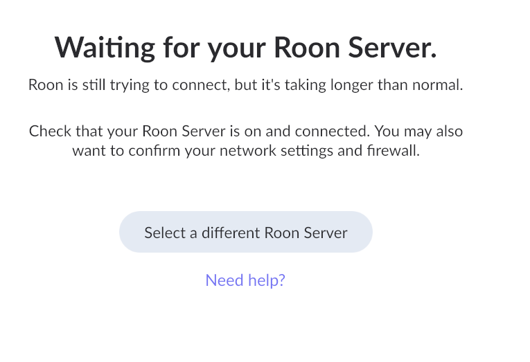

· After the most recent software update the Roon app on my PC and on my iPhone say "Waiting for your Roon server" and never connect to the server. I have rebooted everything but no luck.

Try clicking on “select a different Roon Server”, it will force Roon to perform a fresh device discovery scan.

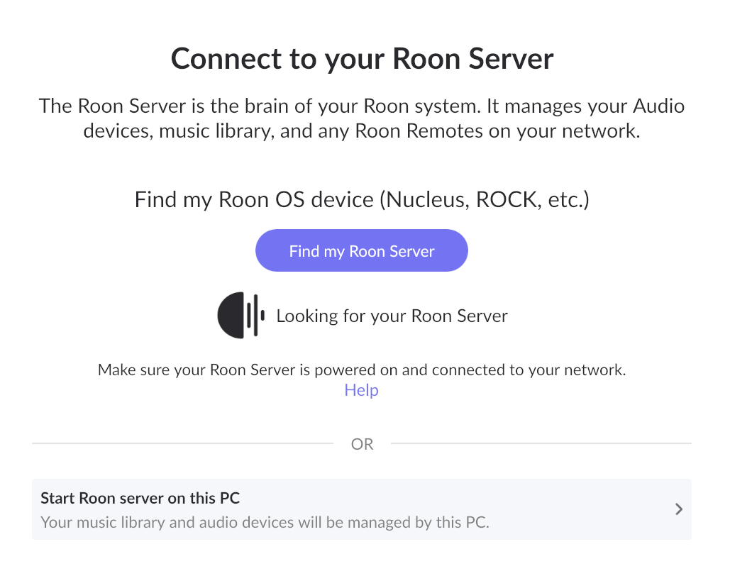

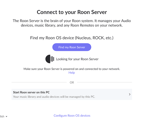

OK. Did that and I’m getting this message:

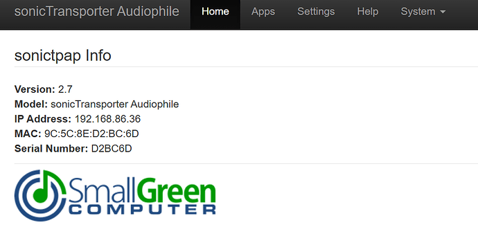

I found my SonicTransporter on my network. It’s connected and appears normal:

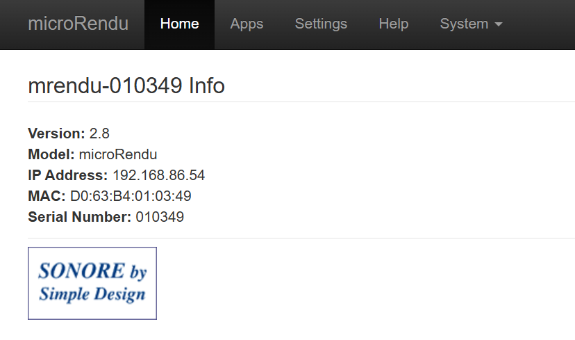

I also re-booted my end point which is a MicroRendu and it is connected as well:

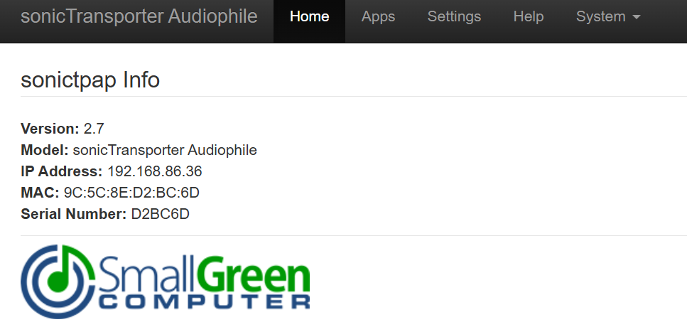

I updated the software using steps 1 to 3, but I’m still getting this message:
I haven’t made any changes which would put the SonicTransporter and the remotes on different networks or introduced any firewalls that I am aware of. I’ve been running Roon with good stability for at least a year with this exact configuration - the only change was the software update. (I’ve been a Roon customer for 5+ years - the SonicTransporter has always been the core, and I’ve used a few different servers over the years.)
