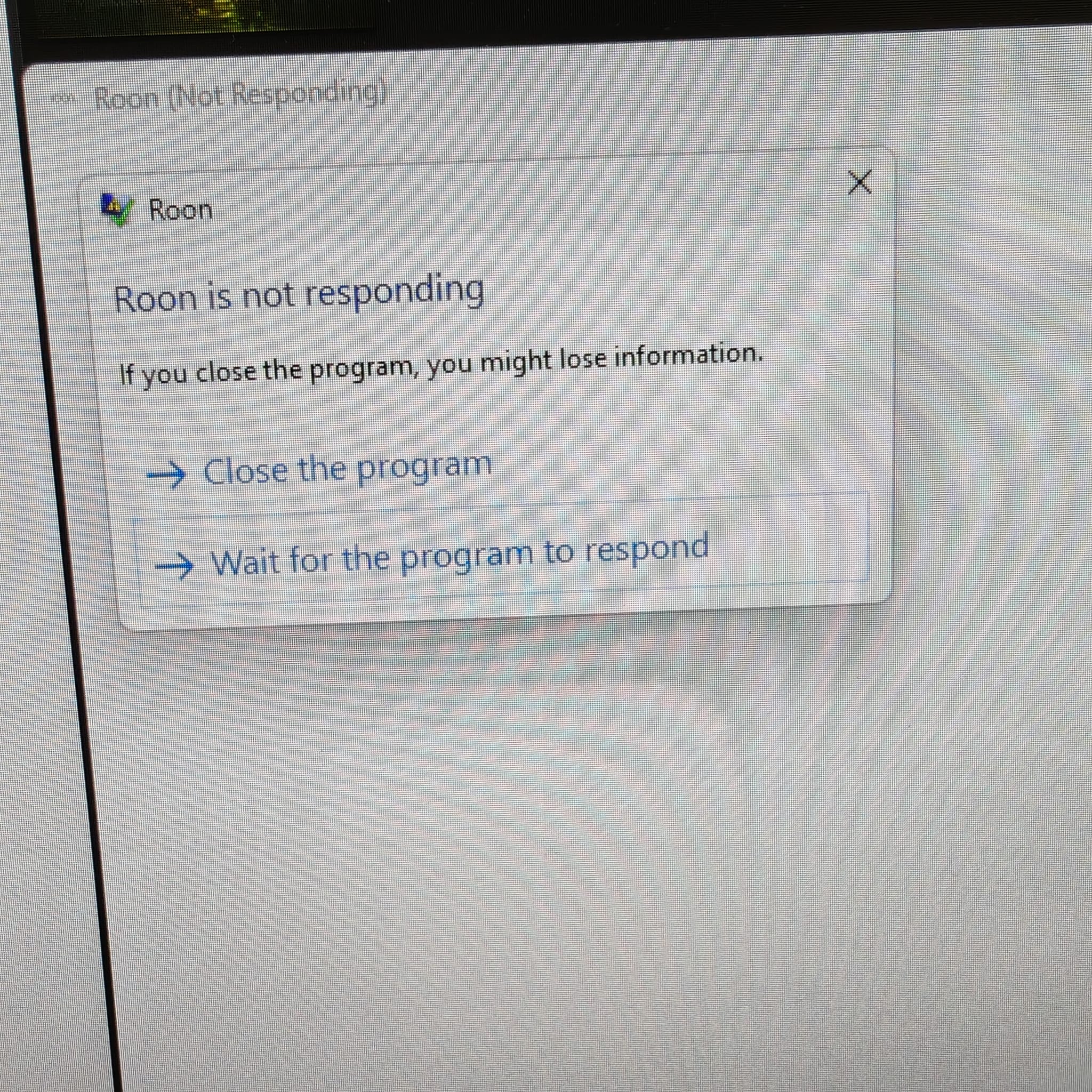

It had been fine for months, but now the Roon app in Windows more often than not just doesn’t open successfully. I get a white window that quickly turns to “not responding” that I have to kill.
What’s baffling is that sometimes (rarely) it works, but I cannot ascertain the circumstances in which it does so. The server is running, I can always access Roon successfully via my phone app.

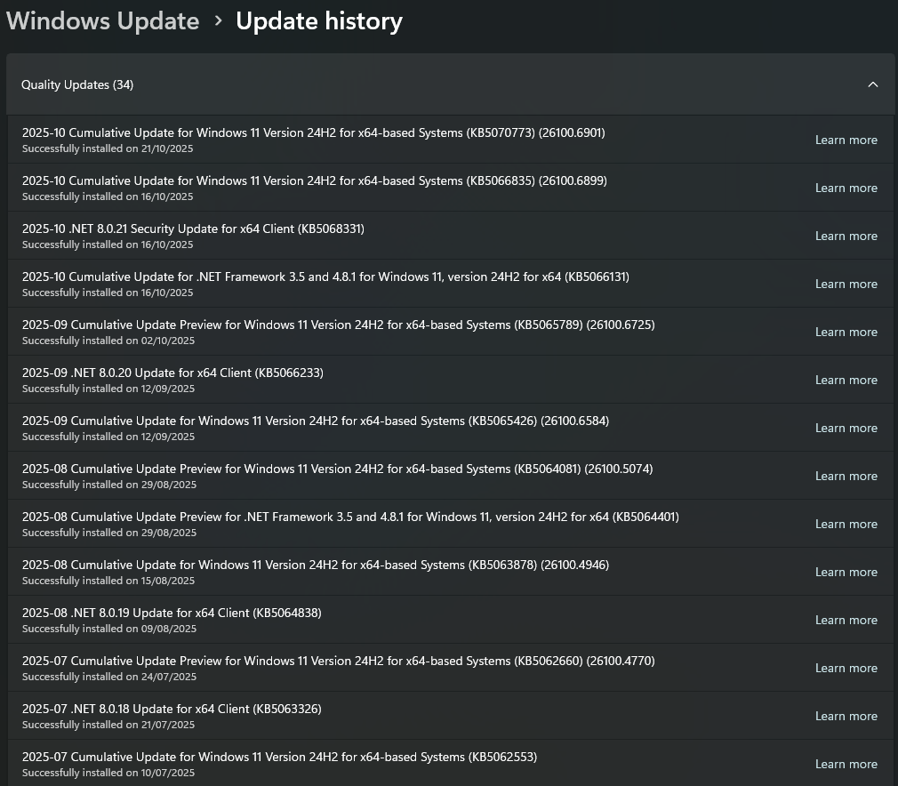

Just to check — have there been any recent Windows updates or driver updates on your system around the time the issue started?
Sometimes, certain system updates (especially graphics or .NET-related) can interfere with how the Roon app starts up.
Could you please follow the steps below so we can take a closer look?
  1. Check your recent Windows updates:
  • Press Win + R, type control update, and hit Enter.
  • Click “View update history” and let us know if you see any updates installed recently (especially in the last 1–2 weeks).

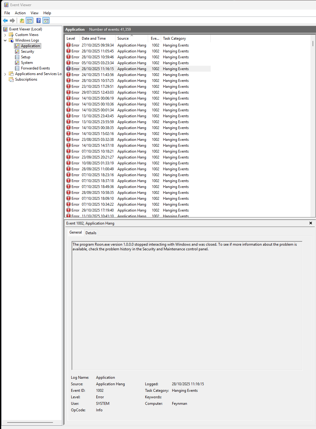

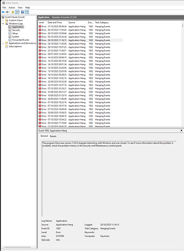

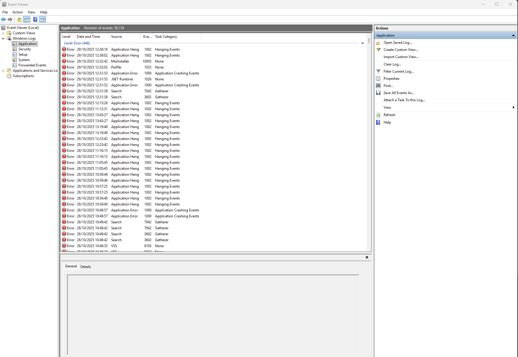

Hello @Phillip_Reeves
Thank you for the screenshots, but there is not so much useful information from the Event Viewer. There is the “Save All Events As” button. Please save it and attach it here.

If I can but in, I have the same problems and it started after the following updates Preview update (KB5067036) and .NET Framework Preview update (KB5067931)
Thanks
Mike
Sorry should have said that this is only happening when trying to connect to Roon server from a remote windows laptop, Roon server is on another windows machine and that works fine after the W11 updates.
