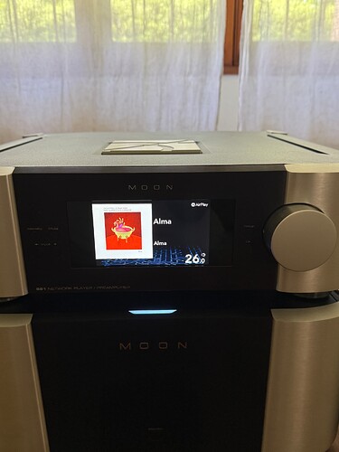

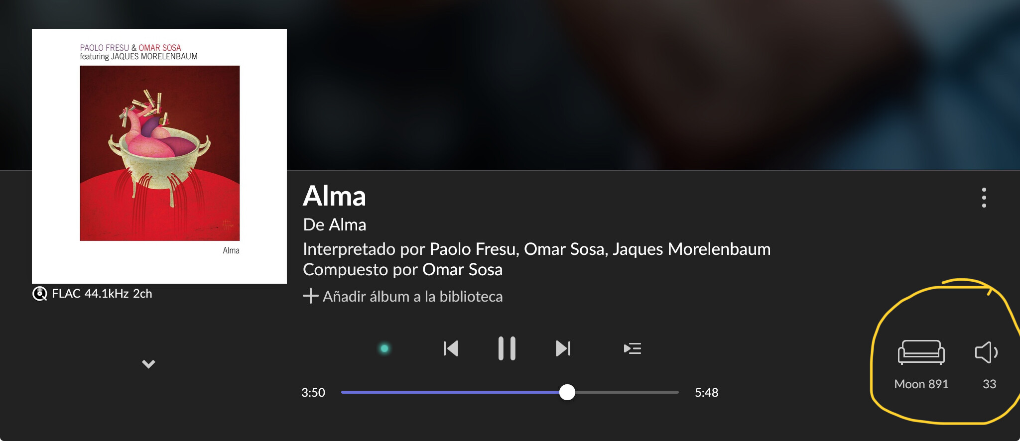

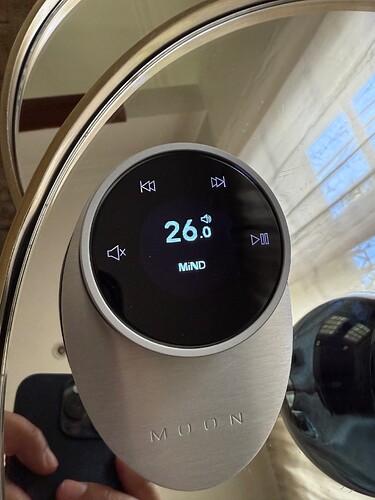

I recently upgraded my preamp from Simaudio Moon 791 to Moon 891. Since then, my Roon app has displayed a volume level of some points higher than that on my Moon 891 preamp. The more Í turn the volume on, the bigger the difference is.

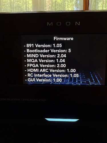

Additionally, please confirm that your Moon 891 is running the latest firmware.

One screenshot of iPad App, the other of the iPhone App.
Moon 891 is running latest firmware, updated yesterday, when installed.

From this screenshot, we see that you are using AirPlay instead of the RAAT. Have you tried the same with the Roon Ready mode enabled?
I hadn’t noticed it. I have always used RAAT. Surely that solves the problem. Right now I can’t review it, but as soon as I do, I’ll let you know the result. Thanks a lot.

Hello @vadim. I activated the Moon Zone 891 through RAAT and the problem was solved immediately.
