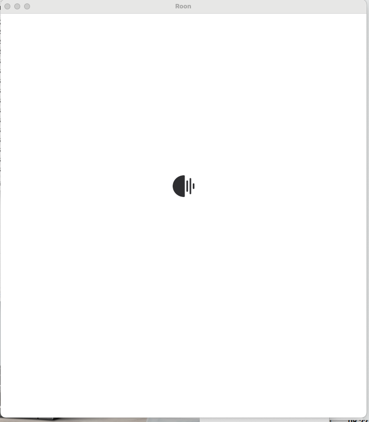

· The Roon app won't open after reinstalling after connectivity problems (none of the audio sources appeared to be available). I deleted and reinstalled the Roon app on my Mac (where Roon lives) and I've turned my Nucleus off and back on. Both the Mac and Nucleus are on a hardwired LAN. Both have IP addresses and appear as "wired" on my router's webpage.
When reinstalling the app, I get to the step where the Roon app "sees" the Nucleus but when clicking "next", the app seems to stall. All I see is the Roon icon wriggling. I've closed the app, restarted my Nucleus and repeated the above 3X, so I can use some help! Thanks!!!

No luck connecting from other devices. Prior to communicating with you, I deleted and attempted to reinstall a fresh copy of Roon. Renaming the files as suggested followed by reinstalling Roon didn’t resolve the issue. Specifically, when I click on “connect” from the screen, “Connect to your Roon Server”, I get to the Roon icon that wriggles but no further.

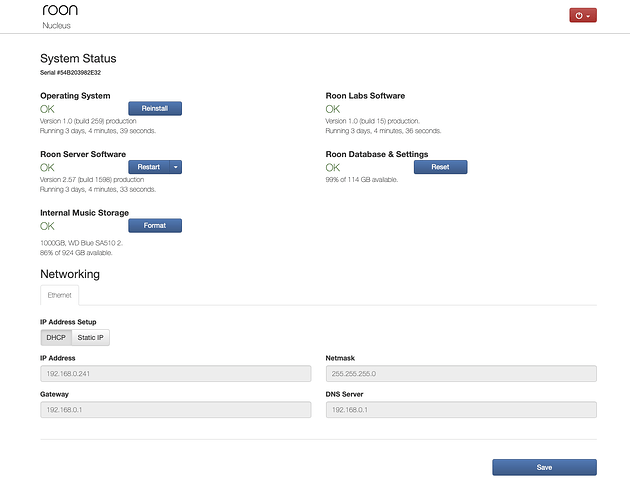

Good day @Rich_Hass !
Did you try to reinstall Roon OS on your nucleus ?
If not, can you please open a web ui of your nucleus and share a screenshot from it with us ?
You can find an instruction here.
Also, when you connect to your nucleus from your mac, does it require you to authenticate before proceeding or it hangs immediately ?
Regards.
Haven’t tried reinstalling the Roon OS, so here’s the screenshot you asked for. I’ve tried again to reinstall the Roon OS by first renaming the files you identified by adding “_old”. Then, I’ve downloaded the file from your website. When I get to the screen titled, “Connect to your Roon Server”, I’m clicking on the option “connect” for the Nucleus—and not the option to set up a Roon Server on this Mac. After selecting “connect”, I get a white screen with the black Roon logo vibrating, like something is happening but nothing does. Let me know what next steps I should try. Thanks!
