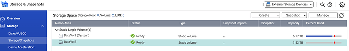

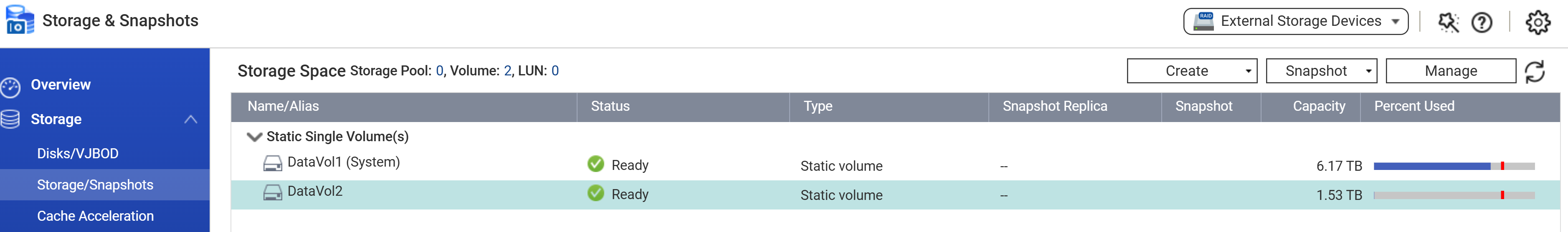

I still can’t get ROON running in container station.
This is my configuration
services:
roonserver:
image: Package roonserver · GitHub
container_name: roonserver
network_mode: host
environment:
  • ROON_INSTALL_BRANCH=production
  • TZ=Australia/Sydney
    volumes:
  • /share/DataVol2/Container/roon:/Roon
  • “/share/DataVol1/Music Nas 2:/Music”
  • /share/DataVol2/Container/roon-backups:/RoonBackups
    restart: unless-stopped
    logging:
    driver: local
This is the log

tar: RoonServer/Server/RoonServer.runtimeconfig.json: Cannot write: No space left on device
tar: RoonServer/Server/Sentry.dll: Cannot write: No space left on device
tar: RoonServer/Server/System.CodeDom.dll: Cannot write: No space left on device
tar: RoonServer/Server/System.Management.dll: Cannot write: No space left on device
tar: RoonServer/Server/System.Security.Permissions.dll: Cannot write: No space left on device
tar: RoonServer/Server/System.Windows.Extensions.dll: Cannot write: No space left on device
tar: RoonServer/Server/VERSION: Cannot write: No space left on device
tar: RoonServer/Server/libleveldb.so: Cannot write: No space left on device
tar: RoonServer/Server/libroonbase.so: Cannot write: No space left on device
tar: RoonServer/Server/processreaper: Cannot write: No space left on device
tar: RoonServer/Server/relaunch: Cannot write: No space left on device
tar: RoonServer/VERSION: Cannot write: No space left on device
tar: RoonServer/check.sh: Cannot write: No space left on device
tar: RoonServer/start.sh: Cannot write: No space left on device
tar: Exiting with failure status due to previous errors
Roon Docker image 1.0.6 starting.
VERSION file at /Roon/app/RoonServer/VERSION is empty — treating as no existing install.
Resolved ROON_INSTALL_BRANCH=‘production’.
No install present; installing branch ‘production’.
Downloading from https://download.roonlabs.net/builds/production/RoonServer_linuxx64.tar.bz2…
How do I fix this???
Plenty of space available on the system
Had the same issue, and I solved it by removing the volume alias names from the path, the top-level folder name is sufficient:
/share/Container/roon:/Roon
/share/Music Nas 2:/Music
/share/Container/roon-backups:/RoonBackups
I assume your /Container folder as used by Container Station, is on an SSD volume, and there is no second top-level folder of the same name on /DataVol1? The latter situation should be avoided, in this case it would be better to set up a new top-level folder, for example named /RoonInContainer on the SSD volume, and route to that one instead of /container
If you are uncertain regarding correct folder path syntax, feel free to share a screenshot of your volume´s and top-level folder´s names in File Station.
Space is not the issue here, but insufficient rights of Container Station to write anything into that folder, and seemingly invalid folder syntax in the share path as well.
Good luck!
