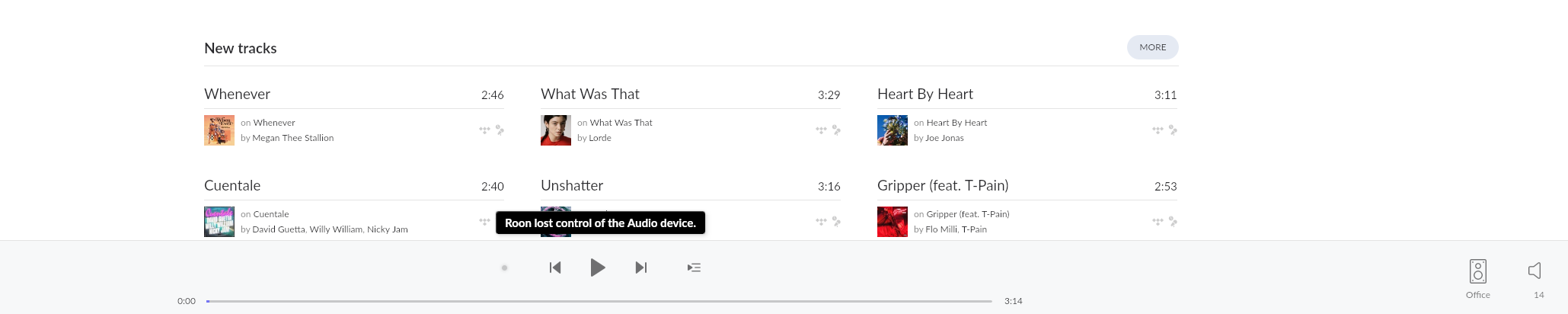

I am unable to play music on my sonos devices from my PC using the Roon app. I am unable to connect to the Roon server on my PC from my iphone running the Roon App.
I can see the devices listed in the bottom RHS of the screen on the PC, but when I try to play to them I get a message: Roon lost control of the audio device.

I’ve enabled diagnostic mode for your account and we can see that there were some issues with the laptop getting an IP address.
Could you please confirm that the issue is still relevant as I see 3 active Sono zones at the moment
