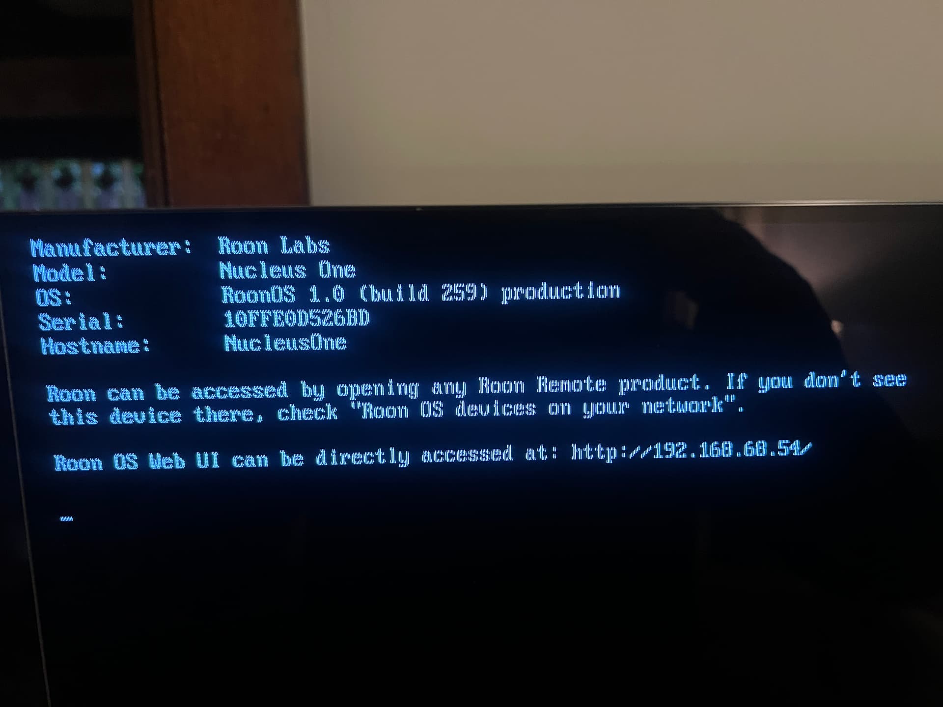

This is the screen that I see when I hook up the Roon to the monitor. When I hit enter, enter the command “ resetnetwork”, and hit enter again, no message comes up.(the screen remains unchanged.)

This is a message that I get on my screen. When I hit enter or try to put in the command, nothing happens. Additionally, when I enter the roon OS web UI into my computer again, I’m unable to access any information.(I get a message that I’m unable to access the server.

I have tried that approach with 2 different routers and 2 keyboards with no change on the screen
