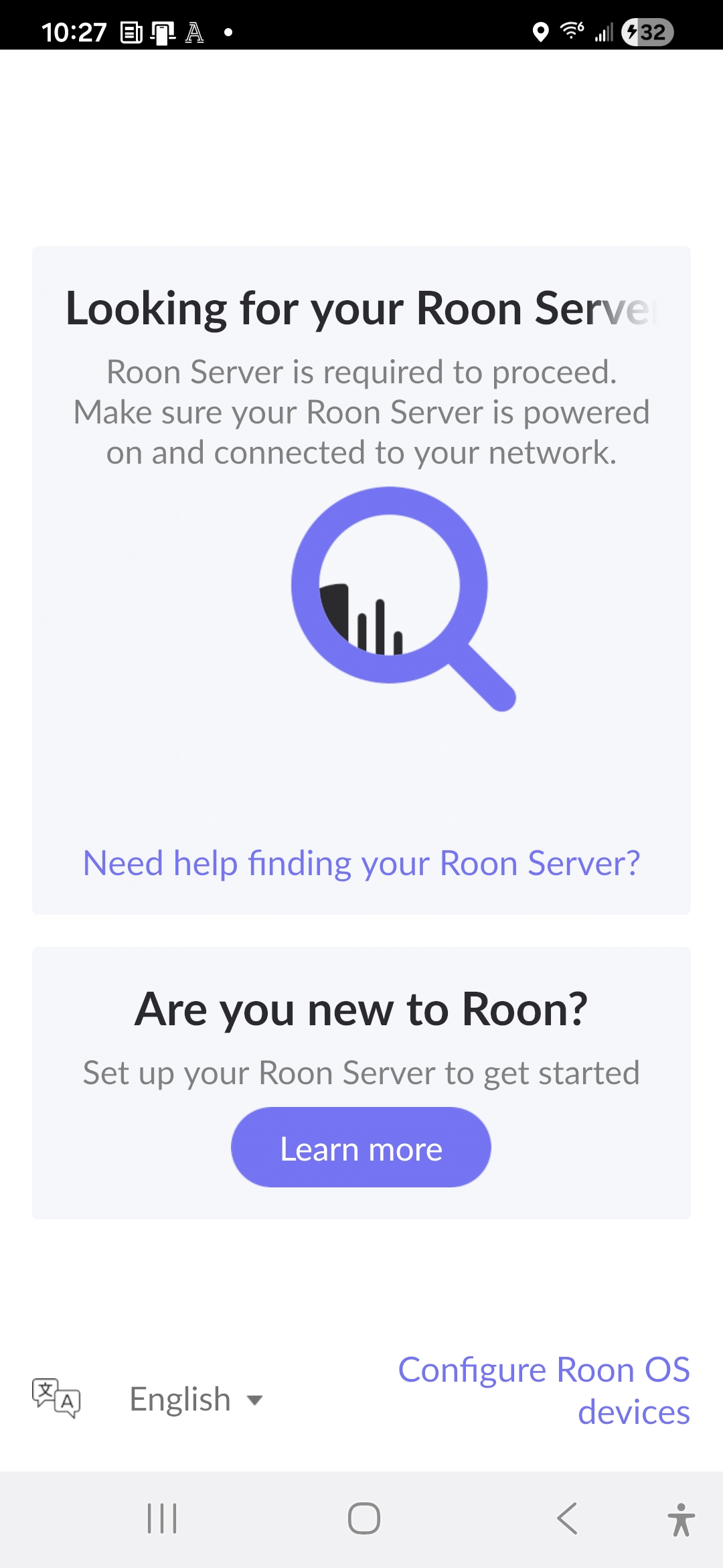

I did an upgrade while in roon app and then the app could not find the server. The server is a sonictransporter CDR version 2.7. I am using spectrum 1G service and my home computer is a windows 11. Both phone (S23) and Sonictransport are on same subnet and have rebooted everything and restarted roon server on Sonictransport. Tried scanning the sonictransport address but still doesnt find.
Spectrum cable modem. Eternity connection to Sonictransport. Spectrum wifi to S23. Windows firewall and windows defender.

Thanks for getting back to me. I went through a lot of different procedures to get everything working. To be frank, I am not sure exactly which one resulted in the Remote being able to see the SonicTransporter as the server as I did a lot of different steps. The most likely one was the two-step update process to move the software from 2.7 to 2.8. The procedure was confusing and just hitting the update button doesn’t update the firmware. Took following another topic here to do it correctly. Once the software was updated that was the key to the remote finding the SonicTransporter as the server.
After all of this, then the SonicTransporter was not showing up as an audio source. One of the procedures I had tried said to uncheck all the boxes on the SonicTransporter Roon Server Settings. I didn’t realize that one of the boxes enabled the SonicTransporter to be an audio source. Later going through everything multiple times, I realized that box needed to be checked. So I rechecked that box and it showed up as an audio source.
The final issue, I dealt with was that Windows 11 cannot open the Files on the SonicTransporter. I had to reset Windows 11 to SMB 1 file sharing (which is not recommended for security reasons).
Fortunately through all of this, I was also able to get Roon Arc to work which it had never worked before.
