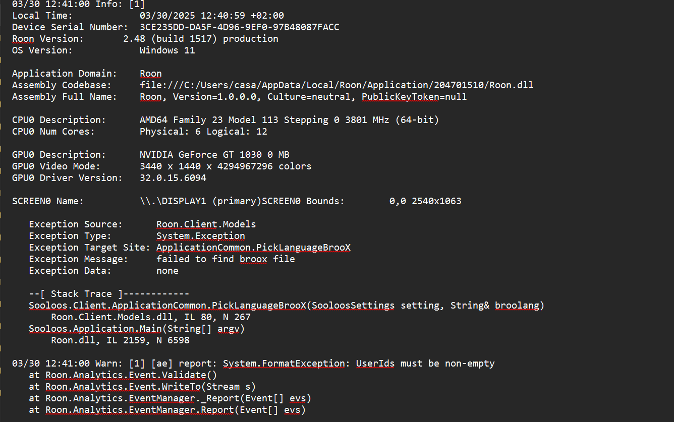

Roon application fails to start after today's update (ref#NLDDP9)
after todays update it does not start
why do you care?
Is this the Win 11 SMB guest login thing again ?
I don’t know enough to comment
Local Time:            03/30/2025 12:40:59 +02:00
Device Serial Number:  3CE235DD-DA5F-4D96-9EF0-97B48087FACC
Roon Version:       2.48 (build 1517) production
OS Version:            Windows 11
Application Domain:    Roon
Assembly Codebase:     file:///C:/Users/casa/AppData/Local/Roon/Application/204701510/Roon.dll
Assembly Full Name:    Roon, Version=1.0.0.0, Culture=neutral, PublicKeyToken=null
CPU0 Description:      AMD64 Family 23 Model 113 Stepping 0 3801 MHz (64-bit)
CPU0 Num Cores:        Physical: 6 Logical: 12
GPU0 Description:      NVIDIA GeForce GT 1030 0 MB
GPU0 Video Mode:       3440 x 1440 x 4294967296 colors
GPU0 Driver Version:   32.0.15.6094
SCREEN0 Name:          \\.\DISPLAY1 (primary)SCREEN0 Bounds:        0,0 2540x1063
   Exception Source:      Roon.Client.Models
   Exception Type:        System.Exception
   Exception Target Site: ApplicationCommon.PickLanguageBrooX
   Exception Message:     failed to find broox file
   Exception Data:        none
   --[ Stack Trace ]------------
   Sooloos.Client.ApplicationCommon.PickLanguageBrooX(SooloosSettings setting, String& broolang)
       Roon.Client.Models.dll, IL 80, N 267
   Sooloos.Application.Main(String[] argv)
       Roon.dll, IL 2159, N 6598
03/30 12:41:00 Warn: [1] [ae] report: System.FormatException: UserIds must be non-empty
   at Roon.Analytics.Event.Validate()
   at Roon.Analytics.Event.WriteTo(Stream s)
   at Roon.Analytics.EventManager._Report(Event[] evs)
   at Roon.Analytics.EventManager.Report(Event[] evs)

i think i did open the casa, where do I see it? - pretty bad interface by the way
You did - I’ll merge this thread into the Support thread to keep everything together…
Hey @vincenzo_arena,
Thanks for writing in and welcome to the Roon Community! Sorry to hear about your instance of Roon crashing - let’s see if a Roon database refresh may help.
  • Exit out of Roon
  • Find the folder that says “Roon”
  • Rename the “Roon” folder to “Roon_old”
  • Verify if the issue persists on a fresh database before restoring the backup
Let us know how it goes!
yes, it worked, but a reinstall should not be a real solution ( by the way I’ve found the same answer in a thread of few years ago )
thanks
