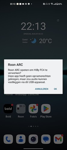

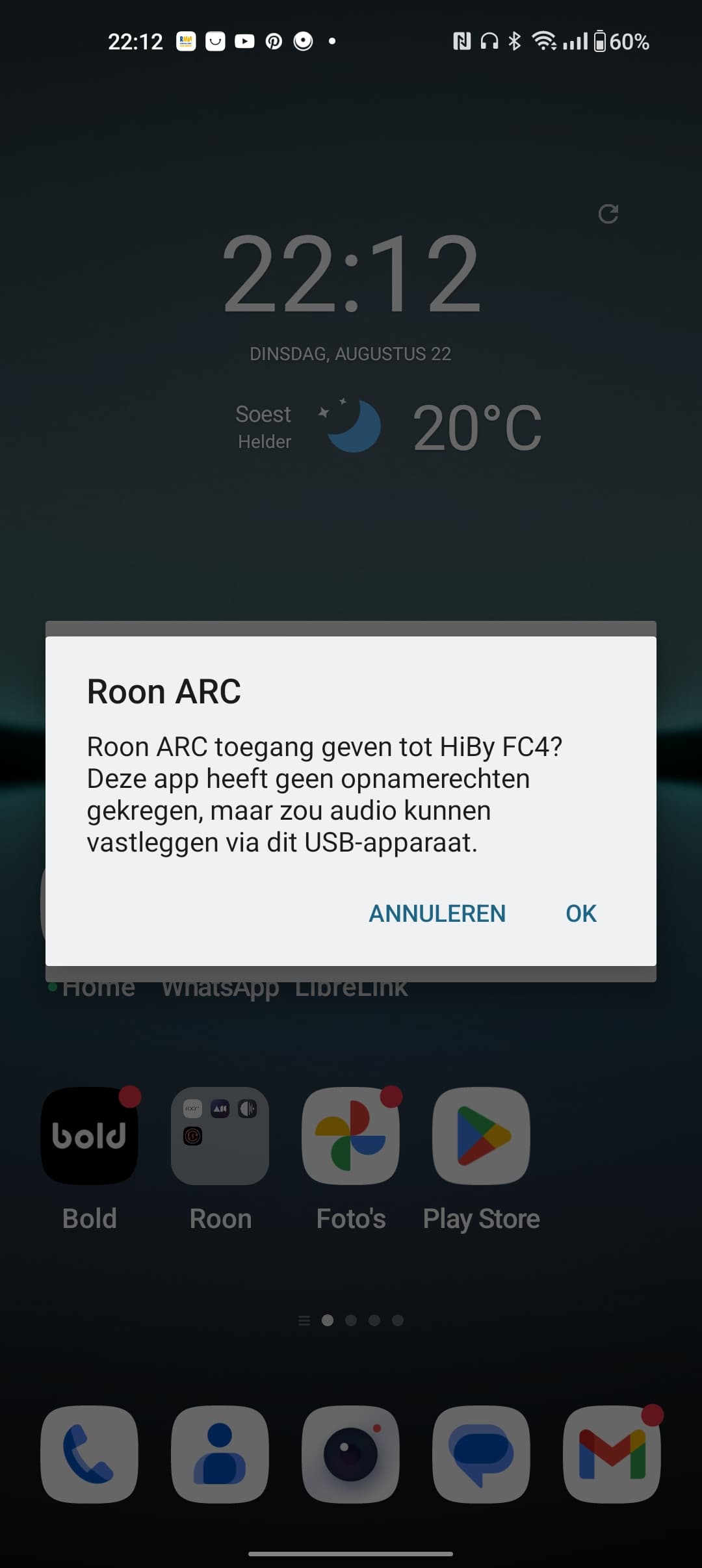

Hi Connor, The pop-up connecting the USB DAC. Just as with any other USB-DAC. After confirmation ARC is launced and then it freezes. Like this. Behaviour is prior to lauch of Roon ARC us exactly the same as with a dongle that works well. (exept for the freeze within Roon ARC)
First message.
Second message.
After confirming the second message Roon ARC launches and freezes. Without any further messages.
