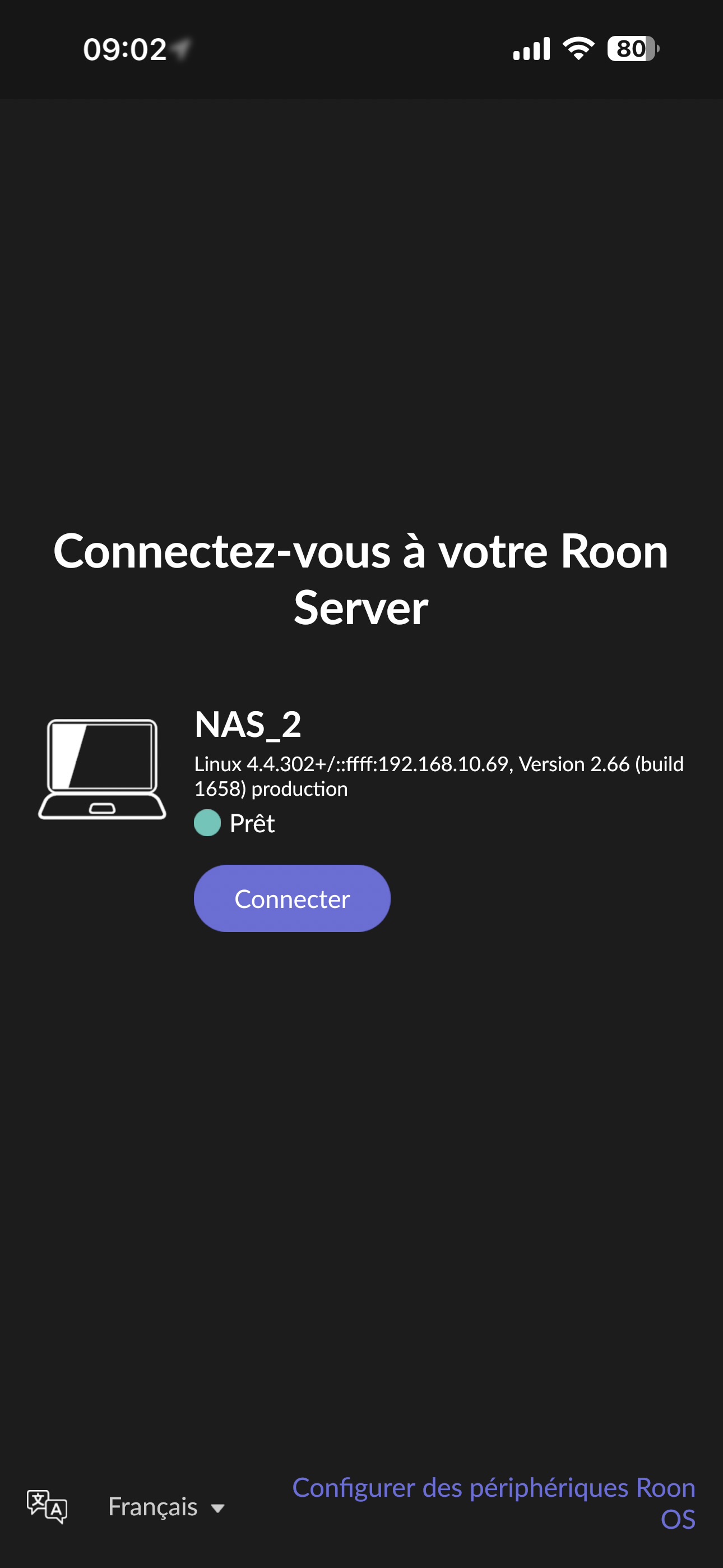

Ihave this problem with the latest versions:
ARC: Server not online message
Roon on local network: NAS server visible but unable to connect. After a few seconds, it prompts me to log in, then tells me I’m already connected…
Everything was working fine before, no configuration changes.
What’s the problem?
Roon server on Synology NAS 224+ ; ethernet networks ; all works fine before the last versions !
Hello @Daniel_LEVY ,
Thanks for reaching out.
Can you provide more details regarding this aspect? If it is asking you to Unauthorize, you can safely go ahead and do so, and then re-authorize the server after.
Thank you for your response.
I had to log out and Roon worked again (without having to log back in !).
The same thing with ARC which worked after logging out…
In fact, it seems that I was logged in twice, it’s quite curious!
Hi @Daniel_LEVY,
We’re glad to hear that restoring the login session seems to have worked. The most likely culprit is a timeout during the initial connection attempt. Let us know if this happens again by reaching out in a new tech support request here. Thank you!
