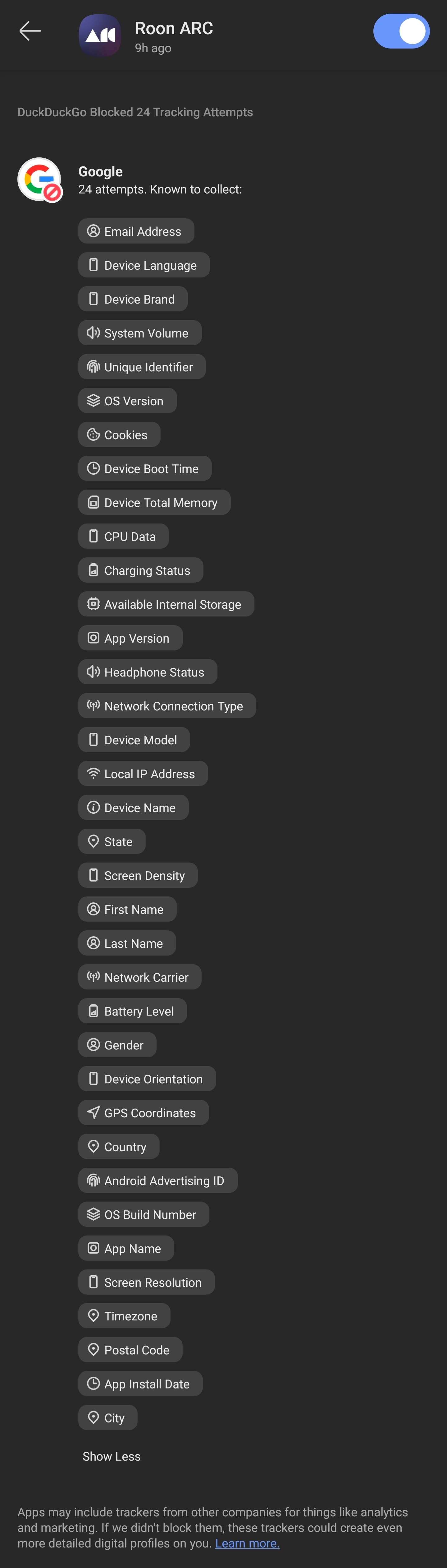

Hey @benjamin , I wonder is the reason that you can’t see any logs is because I use ‘app tracking protection’ by DuckDuckGo on my phone.
I can see that the following requests from Google were blocked in the Room Arc app by DuckDuckGo
Hello @Joe_0,
Your suspicion about the DuckDuckGo “App Tracking Protection” is 100% correct. That tool works by setting up a local, mock VPN on your Galaxy S24 to intercept and block telemetry, data logging, and crash-reporting endpoints.
