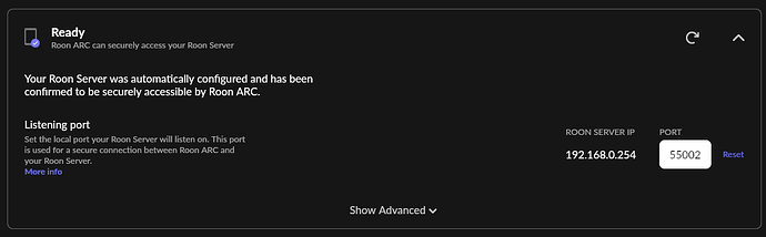

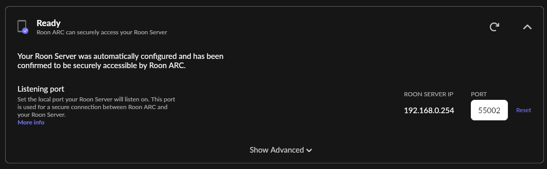

Roon server connection doesn't seem to be an issue any more. The ARC connection status on the server is showing "Ready"

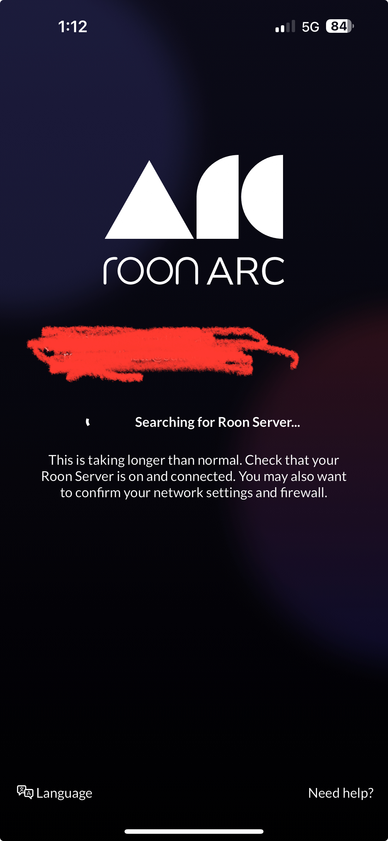

Unfortunately, the issue doesn’t end there. Now my ARC app can’t connect and since I don’t have access to this app logs, I’m totally lost here.

ARC diagnostics that the session has become invalidated because the RoonServer ID has changed. If you’ve migrated your RoonServer between machines or restored a Backup, you’ll need to resync ARC by reinstalling.
Disabling IPv6 likely won’t have any effect here, and NAT traversal doesn’t appear to be the problem, but you can try installing Tailscale instead of relying on port forwarding as a first step.
