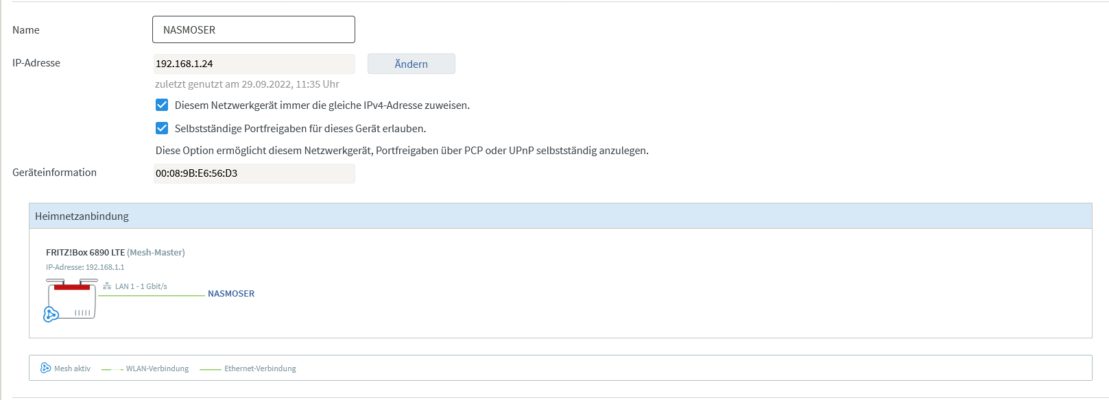

Can you check that you have fully configured your Fritz!box router? As well as enabling UPnP (which you have done according to the error message in your first post), you need to enable independent port sharing on the IP address of your Roon Core, similar to this:
