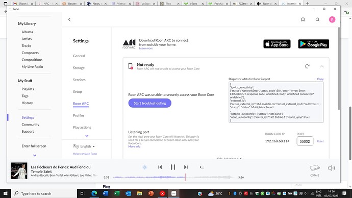

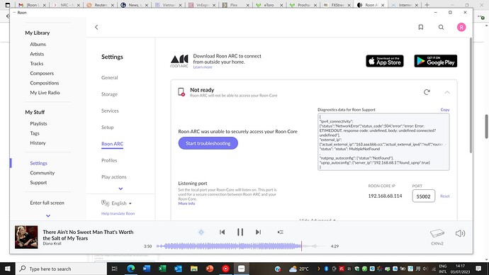

Roon ARC cannot connect to Roon Core
Roon Core Machine
Number of Tracks in Library
"ipv4_connectivity": {"status":"NetworkError","status_code":504,"error":"error: Error: ETIMEDOUT, response code: undefined, body: undefined connected? undefined"},
"external_ip": {"actual_external_ip":"163.aaa.bbb.ccc","actual_external_ipv6":"null","router_external_ip":"null"},
"natpmp_autoconfig": {"status":"NotFound"},
"upnp_autoconfig": {"server_ip":"192.168.68.1","found_upnp":true,"error":"<s:Envelope xmlns:s=\"http://schemas.xmlsoap.org/soap/envelope/\" s:encodingStyle=\"http://schemas.xmlsoap.org/soap/encoding/\"><s:Body><s:Fault><faultcode>s:Client</faultcode><faultstring>UPnPError</faultstring><detail><UPnPError xmlns=\"urn:schemas-upnp-org:control-1-0\"><errorCode>718</errorCode><errorDescription>ConflictInMappingEntry</errorDescription></UPnPError></detail></s:Fault></s:Body></s:Envelope>"}

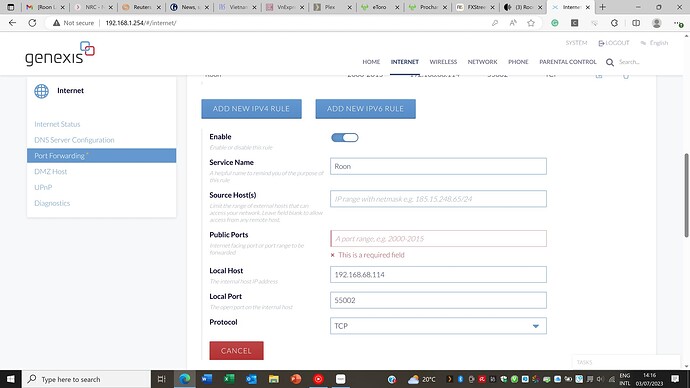

The modem is a Genexis Platinum 7840, with a Deco M5 wireless adapter attached to it. My region is The Netherlands.
I have enabled UPnP, set the port to the same as in Roon. Don’t know though what to put in at Source Host and Public Ports though. Protocol I have set as TCP.
And, I cannot find anywhere a setting where I can set the modem in Bridge mode
yes i did, but as you can read, some fields to fill in are not clear to me
please share some screenshots of the modem router port forwarding settings, and confirm the IP address of your Roon core.

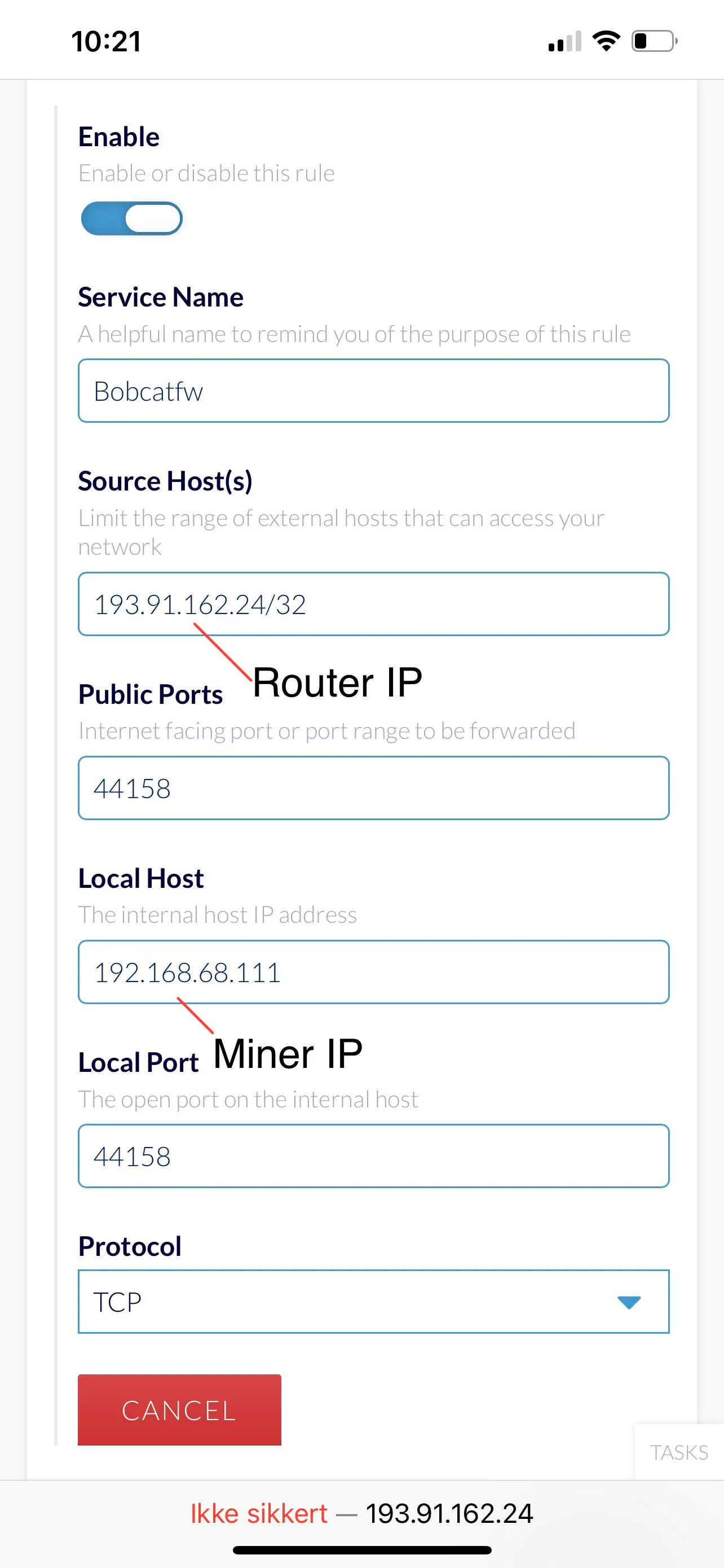

@Rob_Langstraat, is this the port forwarding screen you see?

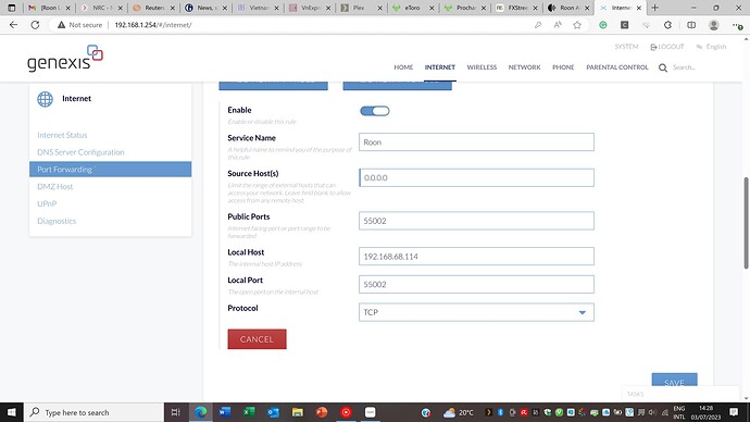

If so try setting ‘service name’ to whatever you want to call it…ARC for example, then ‘source hosts’ to 0.0.0.0/0 then the ‘public ports’ to the port Roon suggests, then ‘local host’ to the Roon Core ip address and finally the local port to the same as the previous ‘public ports’ setting, you will need to save it I imagine and of course remember to enable it (top of the screen).

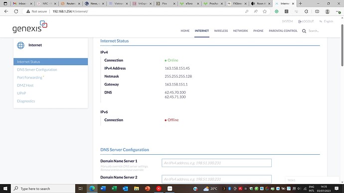

Something doesn’t look right there. The router isn’t using a private network address, e.g., 192.168.68.0, and is a different subnet to the core. Both devices need to be on the same subnet for Roon to work.
Please provide details of all network equipment you have, and describe how the core is connected.
@mjw, Martin, that was just an example from a manual.
Genexis Platinum 7840 router. Connected to that a Deco TP Link. Roon Core is on my HP Zbook 64 bits Windows 10
Source host has a slash 0 (/0) at the end.
I did put it in the instructions but I think the forum software may have removed it?
