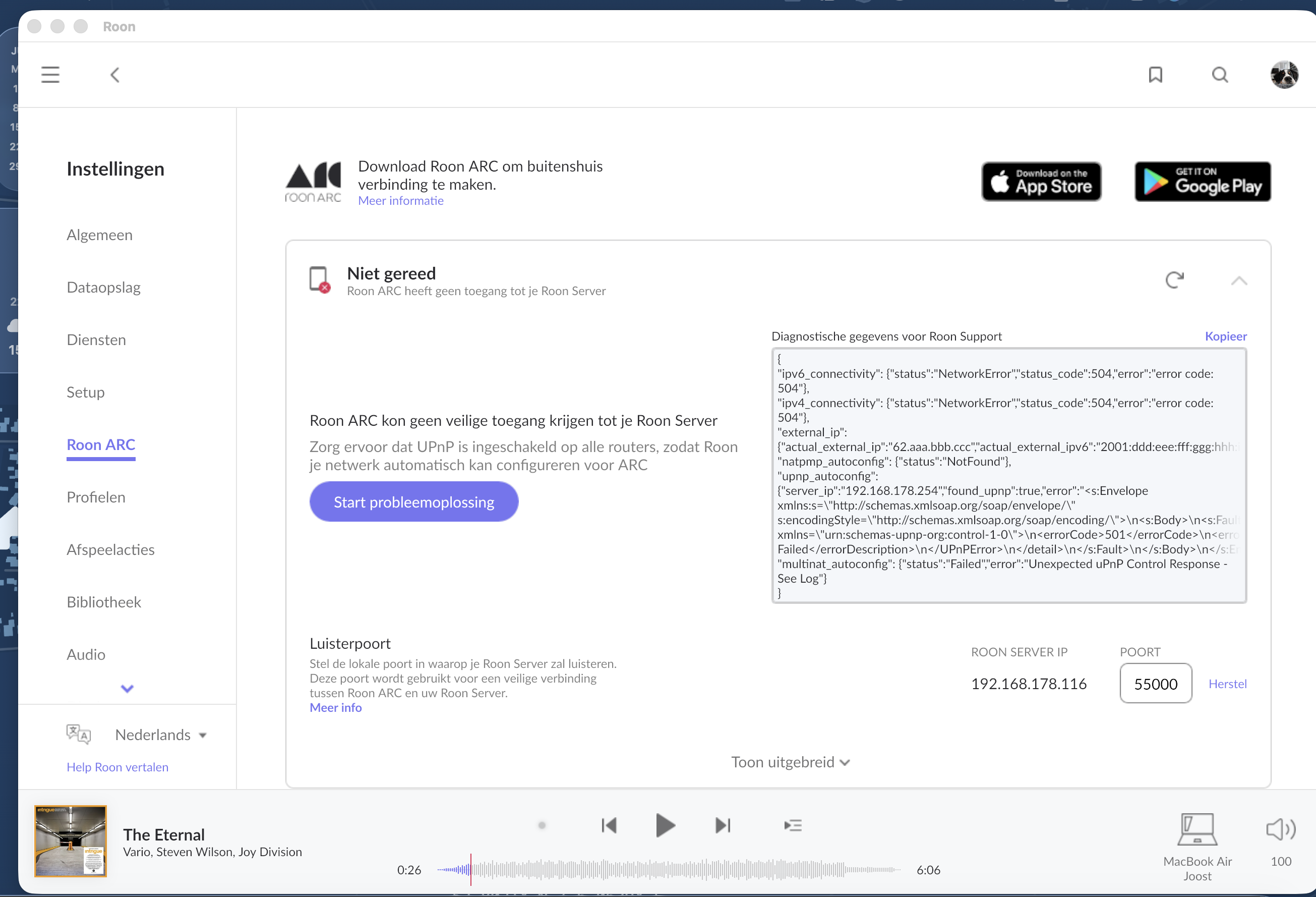

· I've got a fiber internet connection, my internet provider is Odido (NL). The connection is made with a fiber modem, Zyxel EX5601-T1. Via UTP cabels are two routers connected: Netgear GS108Ev3 and TP-Link TL-SG108E. I'm running Roon Rock Serial #94C69119F02D version 1.0 with Roon Server 2.67 (build 1661).
After the Roon ARC test I get this diagnostic info:
"ipv6_connectivity": {"status":"NetworkError","status_code":504,"error":"error code: 504"},
"ipv4_connectivity": {"status":"NetworkError","status_code":504,"error":"error code: 504"},
"external_ip": {"actual_external_ip":"62.aaa.bbb.ccc","actual_external_ipv6":"2001:ddd:eee:fff:ggg:hhh:iii:jjj","router_external_ip":"null"},
"natpmp_autoconfig": {"status":"NotFound"},
"upnp_autoconfig": {"server_ip":"192.168.178.254","found_upnp":true,"error":"
s:Client
UPnPError
501
Action Failed
"multinat_autoconfig": {"status":"Failed","error":"Unexpected uPnP Control Response - See Log"}

Looking closely at your diagnostic error message, we can see exactly what is causing the block: "upnp_autoconfig": {"server_ip":"192.168.178.254","found_upnp":true,"error":"UPnPError 501 Action Failed"}
This means Roon successfully found your Zyxel router (192.168.178.254) and asked it to open a port automatically using UPnP, but the router’s software rejected the request (Error 501). This is very common, as the UPnP implementation on many ISP-provided routers can be quite buggy.

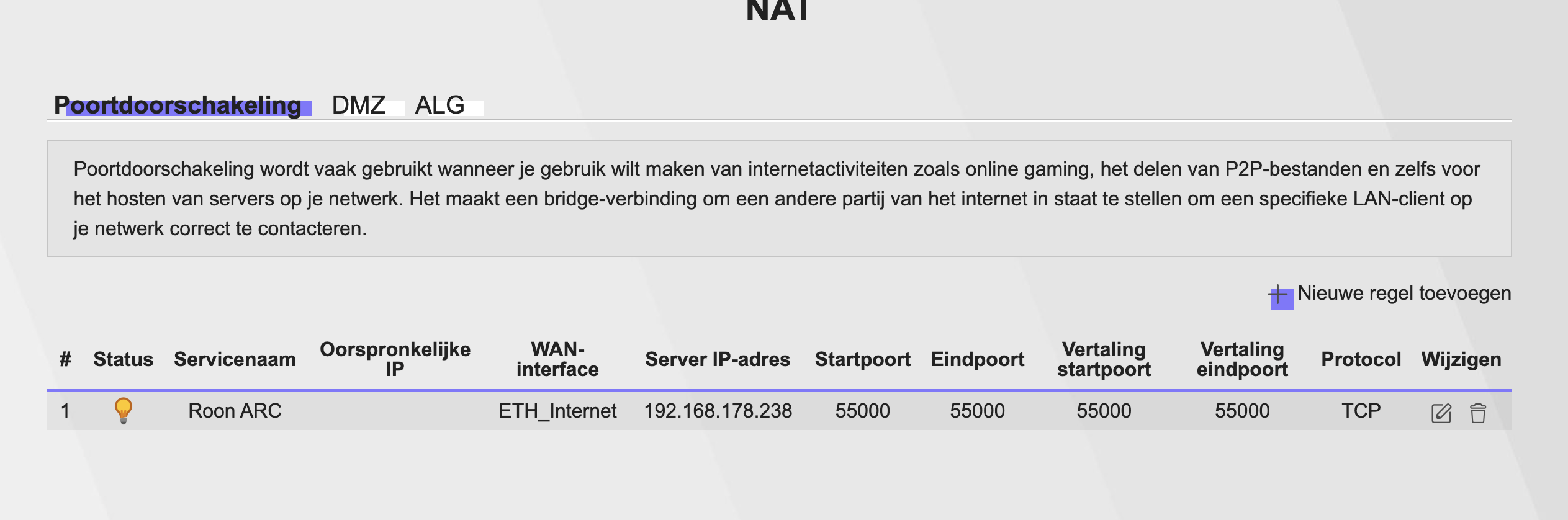

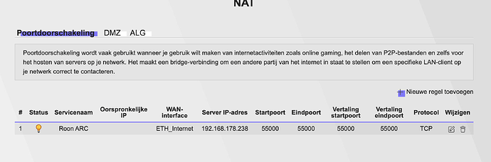

Hi Vadim,
Thank you for your reaction. Unfortunately ROON ARC still doesn’t work. Underneath the NAT port forwarding:

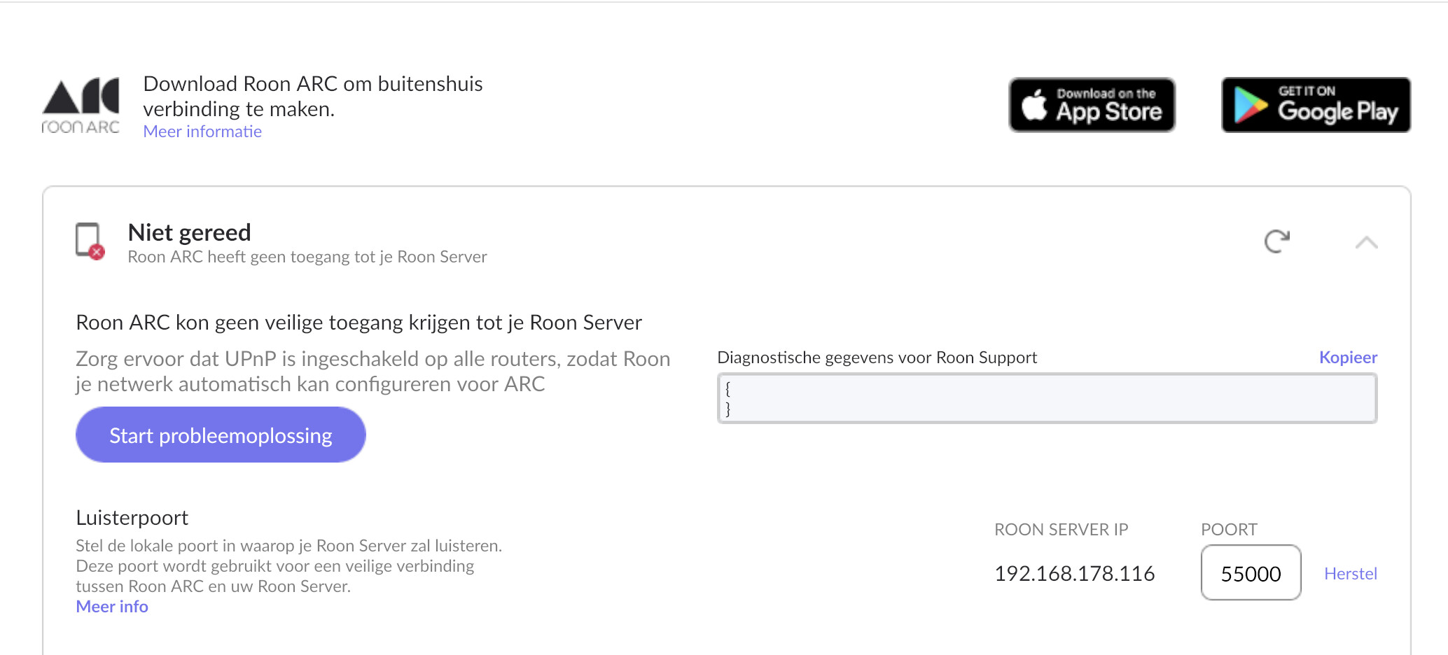

And this is the result of the ROON ARC test:
So, there is no (or little) diagnostic data. I’m not shure what to do now.

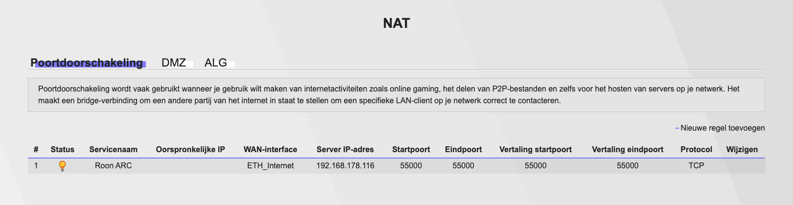

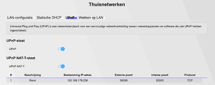

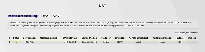

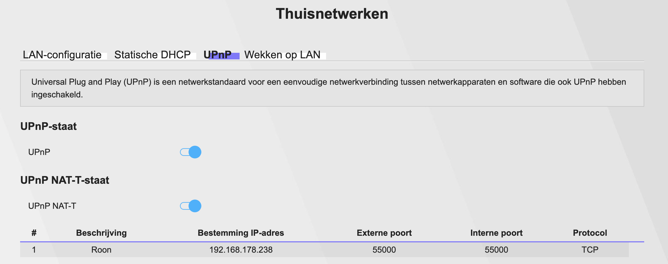

I’ve changed my server, so the IP adress was also changed. I also changed the settings in de the router to:
and:
And now ARC works!
