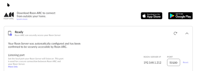

Hi,
Result:|
Hi @Edwin_Slee,
Did you create a manual port forwarding rule in your router settings page? It looks like you’re relying on autoconfiguration with UPnP. It’s possible the router is simply having trouble negotiating an open port with the server when you refresh that page.
You can install Tailscale as an alternative to port forwarding using the instructions two posts above this one. This will open a separate network pathway between RoonServer and ARC - you can compare performance via Tailscale to port forwarding and see which is faster.
