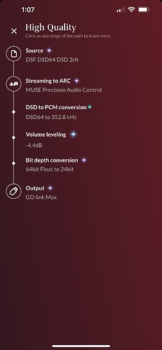

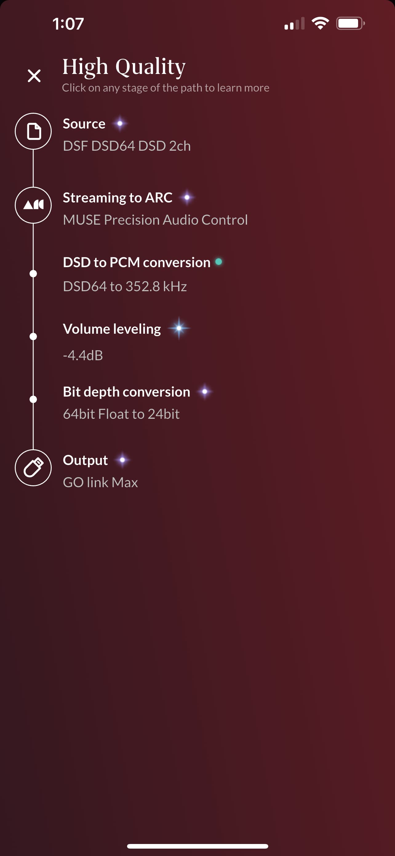

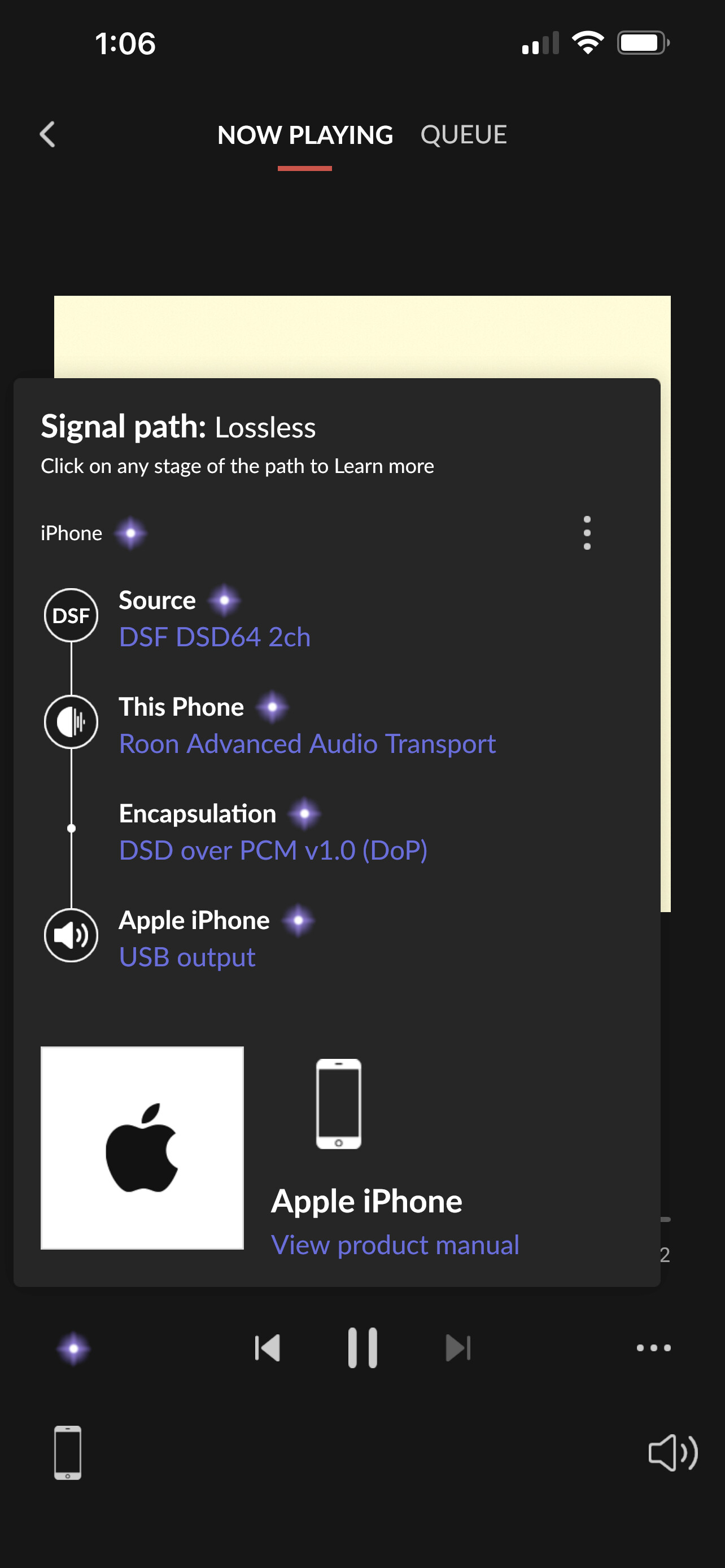

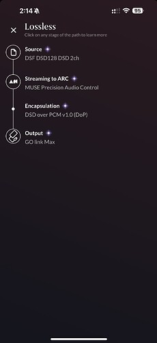

Hi @benjamin . OK, the 1.06p screenshot is of my go max pro through my iPhone on Roon Remote. That, as you can see, does do DoP.
The 1.07p screenshot shows the downconverting through Roon ARC on my iPhone to 24/352.8 PCM.

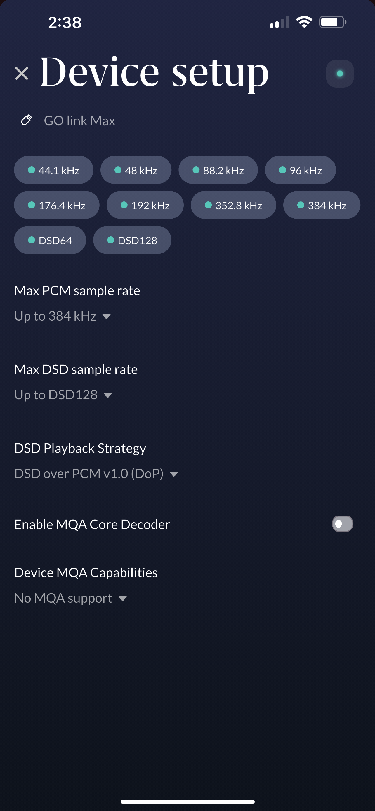

The 2.38p screenshot shows my Roon ARC settings for the go max pro.

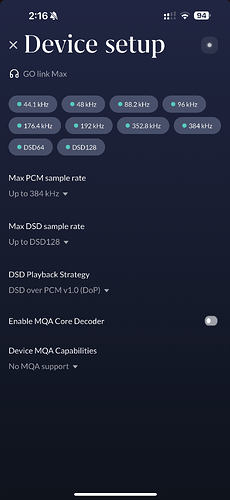

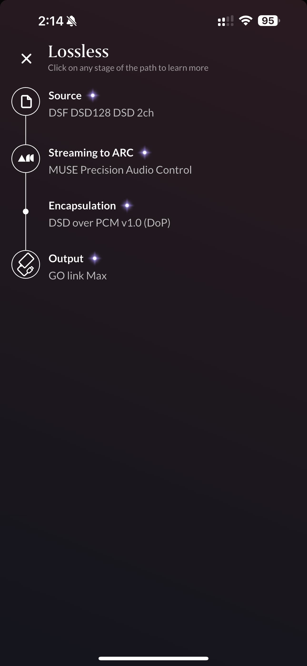

My friend, @ComputerAudiophile , also has a go max pro. The 2.14p screenshot shows that Roon ARC is doing DoP on his iPhone.
The 2.16p screenshot shows Chris’s settings in his iPhone for the go max pro over Roon ARC. Same as mine.
Chris has an iPhone 15 Pro Max. Mine is a 13 Pro Max. I don’t know why that should matter. JCR

Thanks for the update and screenshot! Apologies if this has already been glazed over, but have you tested disabling volume leveling?
Very astute, @benjamin. I missed that one. And indeed, by disabling volume leveling, I’m getting lossless DoP playback of DSD.
