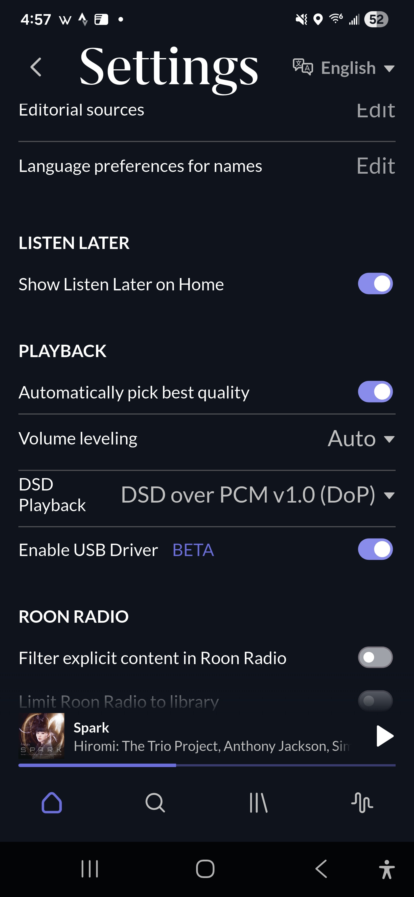

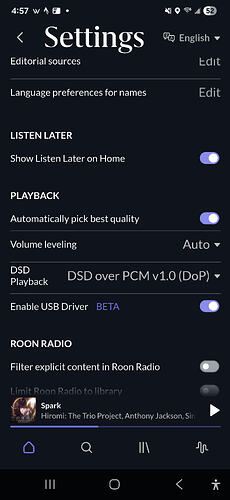

Hi, thanks for the quick reply. 4:47 pm pacific time Monday. I just tried arc, it plays through the dac but volume control is the phone not the dac. Once I toggle the “usb dac, beta” switch it starts crashing. When working it also downsamples to 48kHz, like android does. Roon plays through the USB dac but down samples to 48kHz and volume control is the phone. Neither roon nor arc will play through the dac at hi-res. Dac can handle 192 and dsd 128. Side note, when I plug the dac into the phone I get a pop up asking which app do I want to use the dac. Two options are given, ARC or usb audio player. Roon itself is not an option. Roon will play through both dacs through a Raspberry PI over wifi but not the phone usb dac. Hope that helps.

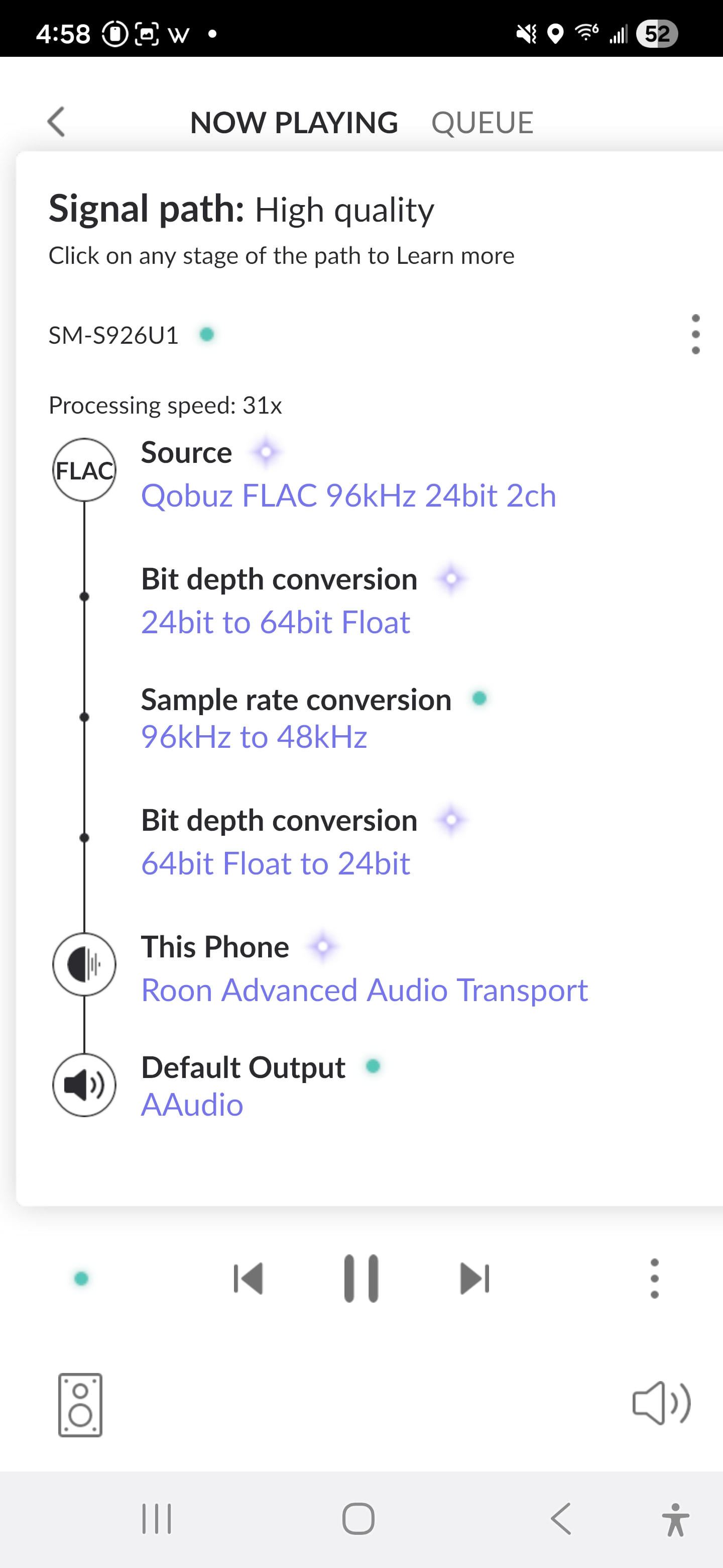

Later that evening… I played around further. I ignored the pop-up that appears when I plug in the USB dac. USB audio finds the dac and asks if it should use it. It then plays bit rate of source. Arc and roon don’t notice the dac in any pop-up and just play 48kHz. the stream on roon shows AAudio on output no mention of ifi dac. On arc it shows ifi dac for the output device but the stream is up/down sampled to 48kHz.

So… qobuz and usb audio player both find the ifi dac and play at the source bit rate (confirmed by the dac). Roon and arc downsample to 48kHz(per the app confirmed by the dac) . Arc attempts to play hi res when the “usb dac beta” is toggled on but quickly crashes. I uninstalled and reinstalled arc. No change.
