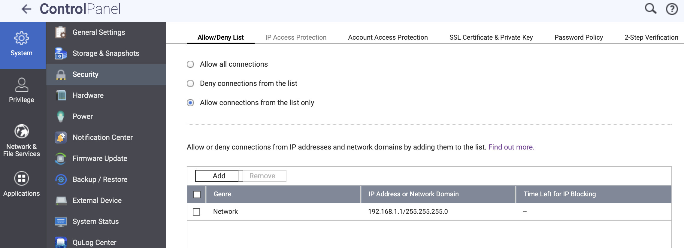

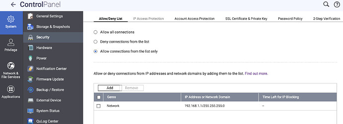

I looked at my firewall settings on my NAS (which runs the ROON server) and I only allowed connections from the list of approved IP addresses.
The only address I have is that of my router with a subnet mask of 255.255.255.0
I thought that would be OK because all my external traffic comes through my router. But apparently not. When I changed it to “allow all connections” Roon reported ARC as “ready”. I’m pretty horrible at network stuff and it feels to me like a security risk leaving it as “allow all connections” so I have changed it back for now. Is there an IP address I can add to the list that’s associated with ROON ARC so this will work while still only allowing connections from the list?

Hi @paul.ferrari,
As long as your router firewall is engaged, then your main line of defense is intact. The key is to avoid making changes to the DMZ or firewall settings within the router (other than the port forwarding rule).
If you expose the NAS to all external traffic per the setting you tried, the router still polices the connection upstream, so it’s not an inherent security exposure.
Roon ARC connections are encrypted and require authentication. An outsider can’t just connect and control your NAS or access files. So, malicious actors or port scanners might see an open port associated with your WAN IP, but that port will only allow encrypted Roon traffic from your account to go in/out.
If you want an additional layer, try adding a new rule in the page you shared that only permits traffic through the port you’ve assigned in your manual port forwarding rule.
