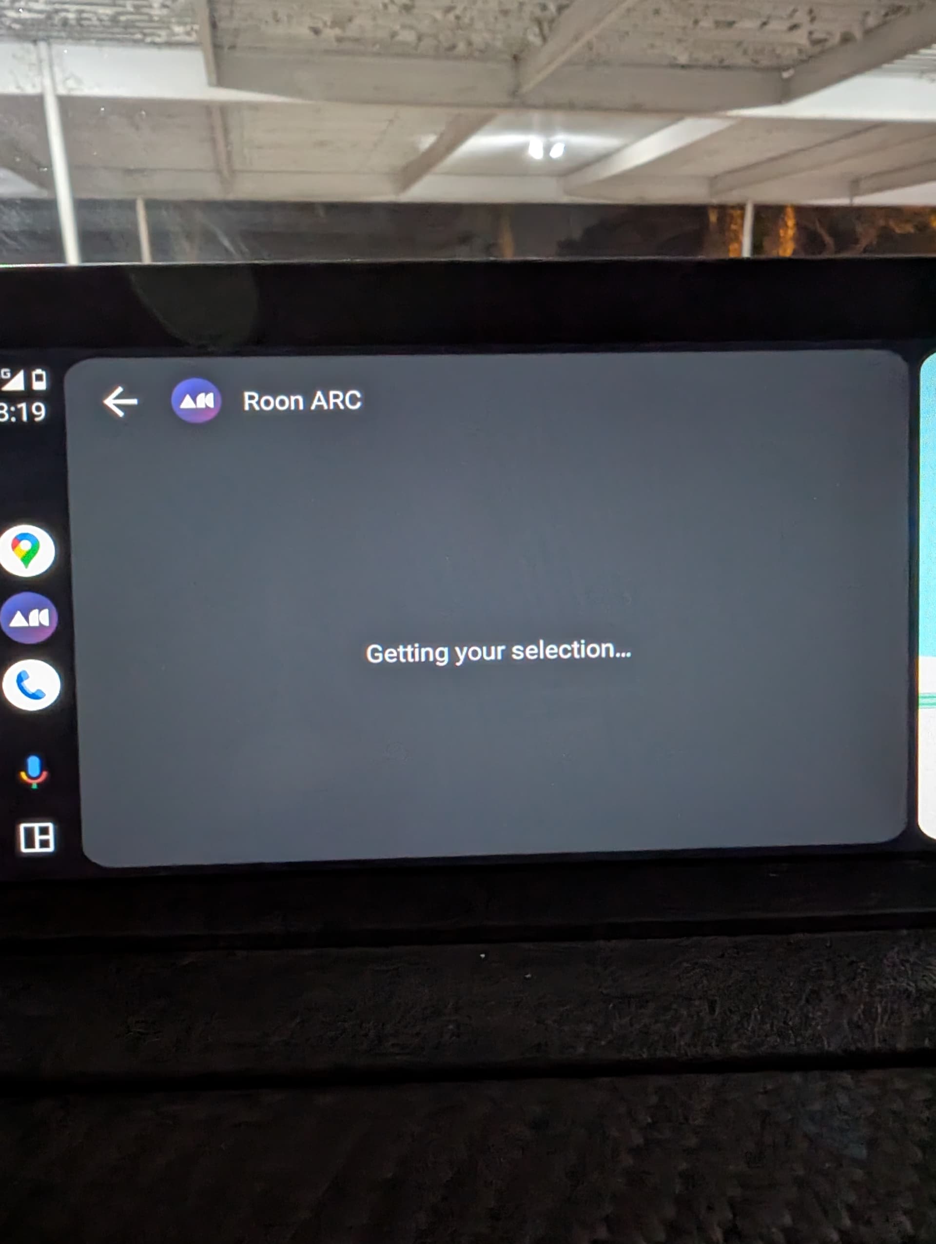

I am having multiple issues with Roon Arc. These issues include - black screen, freezes, poor connection, and non-stop buffering.
Unifi Gateway Max -> UniFi Flex 2.5Gbe switch -> PC (AMD 3800x)

I installed the APK but it isn’t showing up in Android auto.
Hi @AgDev01,
Were you only experiencing these symptoms with Android Auto? If so what are the make and model of the head unit you are using? If it’s the stock head unit that came with the car please let us know the make and model of the car.
Not just with Android Auto but primarily with that as it was where i used it most, and where i had intended to use the product.
It is a Roadtop box EVO ID6-Black installed in an 2018 BMW M2.
Thanks for the clarification @AgDev01. Since you listed multiple symptoms with unrelated causes, we need to ask you to clarify which occur with just the phone, and which occur with the head unit.
Among the issues above - black screen, freezing, poor connection (I assume this refers to the popup banner?) and endless buffering - which occur only with Android Auto?
Is the black screen/freezing issue something you see in the head unit UI or on your phone? Have you encountered this freezing on the phone without the head unit connected at all?
The buffering issue has happened on both just the phone and with Android Auto.

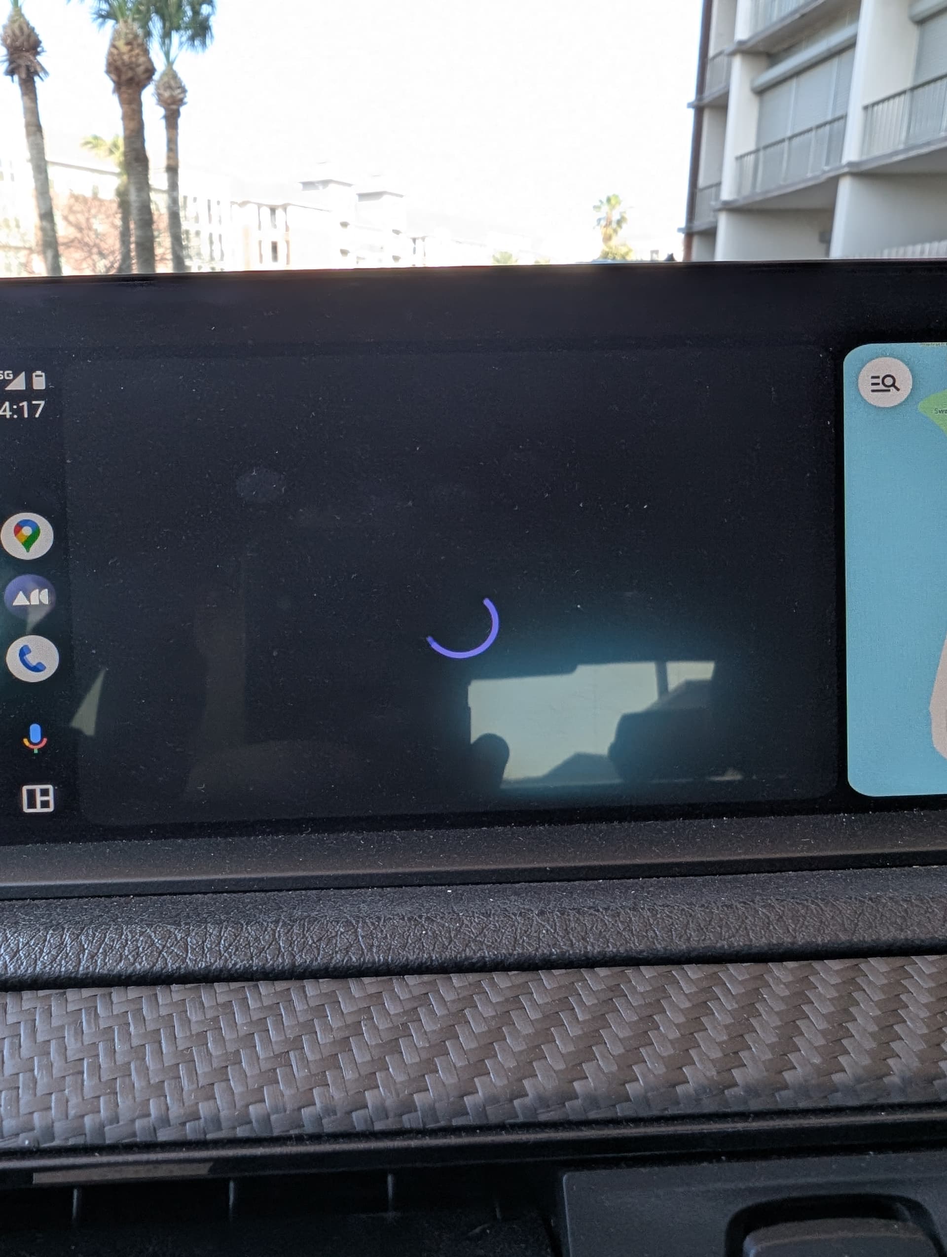

The black screen and freezes are exclusive to android auto. The poor connection message started when android auto was running but happened on the phone when i tried playing a song after exiting the car.
The apk that was linked doesn’t show up in android auto at all.

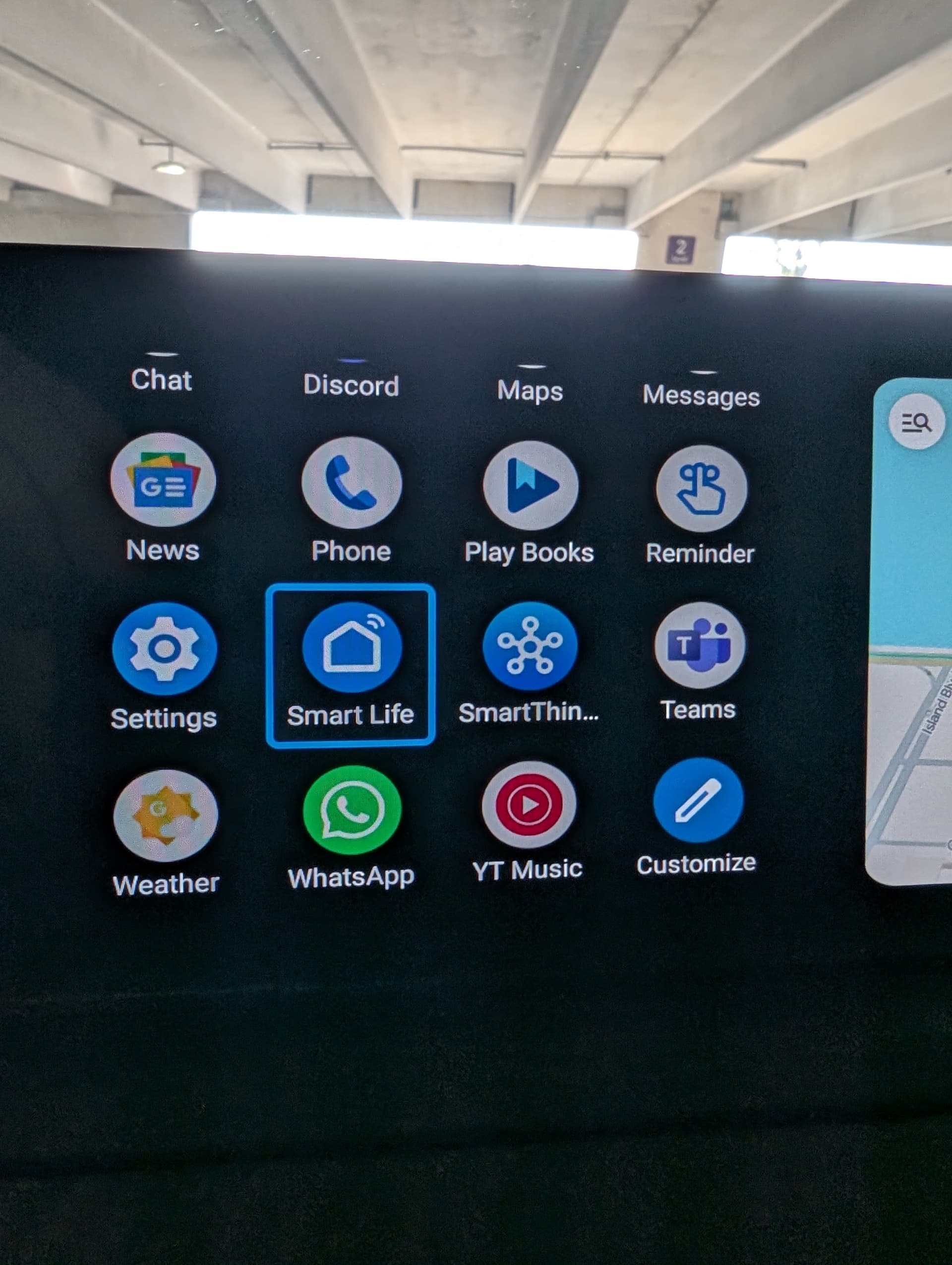

Forgive the confusion earlier - ARC’s APK won’t include the Play Store wrapper required to launch in this head unit. You’ll have to enable APK access for head units in Developer Mode or go back to the Play Store version.
Out of curiosity, do you connect via USB or Bluetooth to this head unit? Does it matter which one you use? We’re reproducing this problem in-house and will respond as soon as possible.
I have enabled the unknown sources in Android Auto and will try it out.

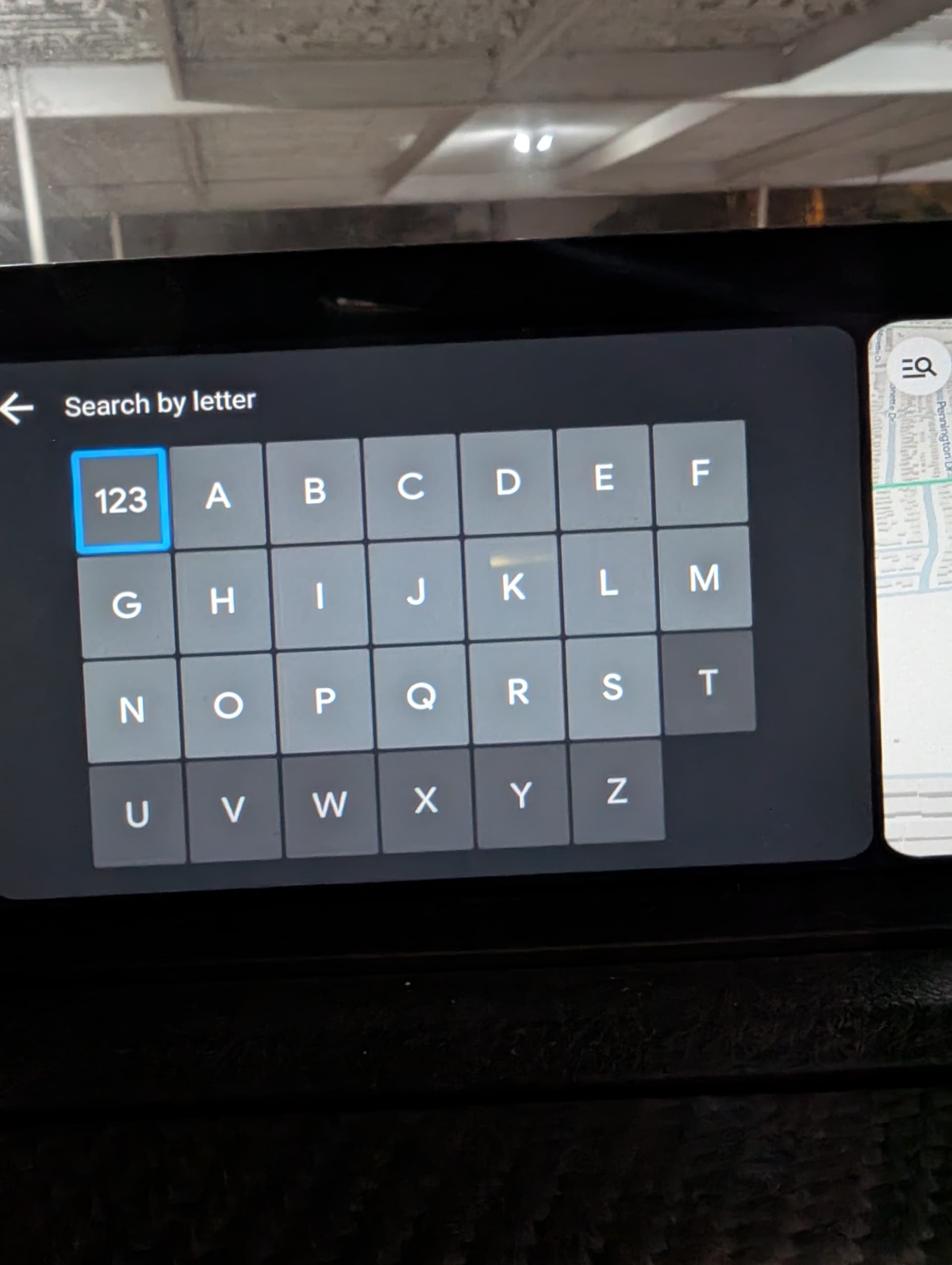

One other issue I noticed in Android auto when I go to the letter search for artists I can only go to S.

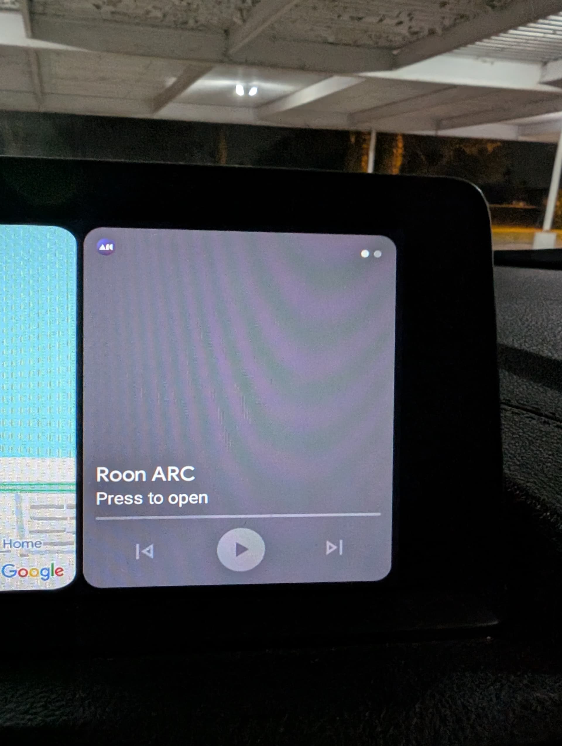

Had this happen getting in the car this afternoon.
Edit now I’m getting the poor connection error. Force closing the app and restarting the phone don’t seem to help.
Edit 2 in order to get it working i had to sign out and sign back in which deletes my downloaded files and is a chore to get set back up again.
Now it won’t display the now playing screen even though music is playing.

This is actually a result of the car’s limitation within the Android Auto interface rather than Arc itself. There isn’t much we’re able to adjust in this area, unfortunately.

I think I have a solution for this. I was also getting the spinning circle on Android Auto about 50% of the time. I went to settings in the app on the phone and toggled Offline Mode on and off and then it worked fine once it reconnected to the server. Hope this helps someone else!
