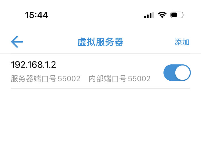

The problem is I have done the forwarding on ISP router.
It worked well in the past.
