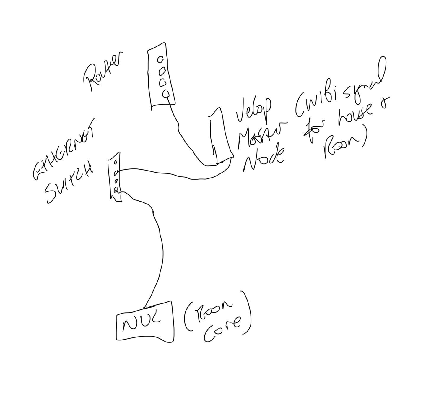

That’s interesting re the UPnP. I made a mistake, it’s an ethernet switch, not splitter. So the cable from the NUC goes into the ethernet switch (five ports), one of which is connected to the master Velop node, which is then connected to the router. This had historically worked, and the reason for doing this is because my Roon connection needed to be to the Mesh wifi, but so did other ethernet cables.
Not sure if this helps, but here’s a fairly poor diagram!
Roon works perfectly across the house using the Mesh wifi, but Roon Arc has stopped (it previously worked on this configuration)
