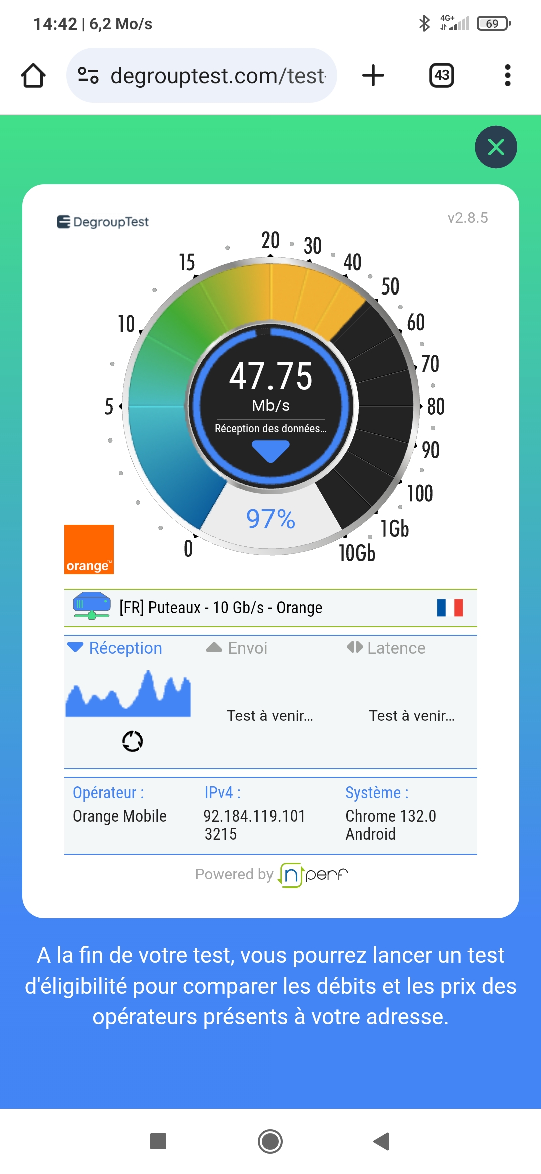

Roon ARC only works with WIFI, not with mobile data network (France). I can connect with WIFI everywhere, Roon ARC is working fine, but if I'm using a mobile data network (Orange, France), no way to connect, Roon ARC tells me there's a Port Forwarding Issue and that I have to check the ARC settings on my Roon Server. When I'm back to wifi, it works immediately. The speed of the mobile data network is good.
mobile data network, Orange (France)

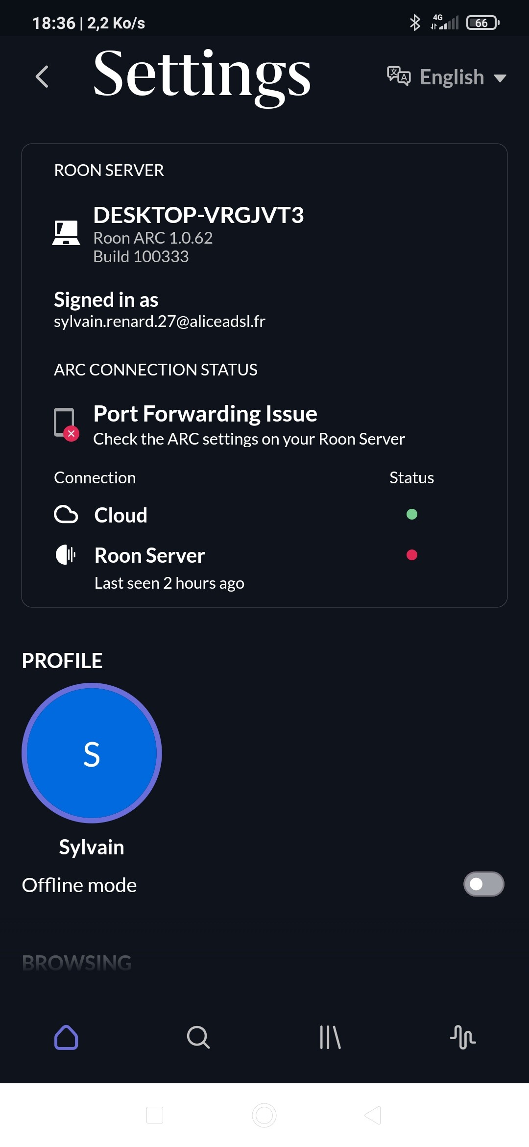

I have no error message in Roon server, only on my phone, in Roon ARC.

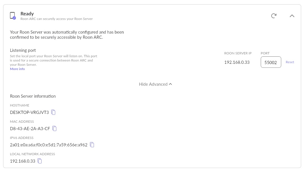

Please show a screenshot of Roon > Settings > Roon ARC.

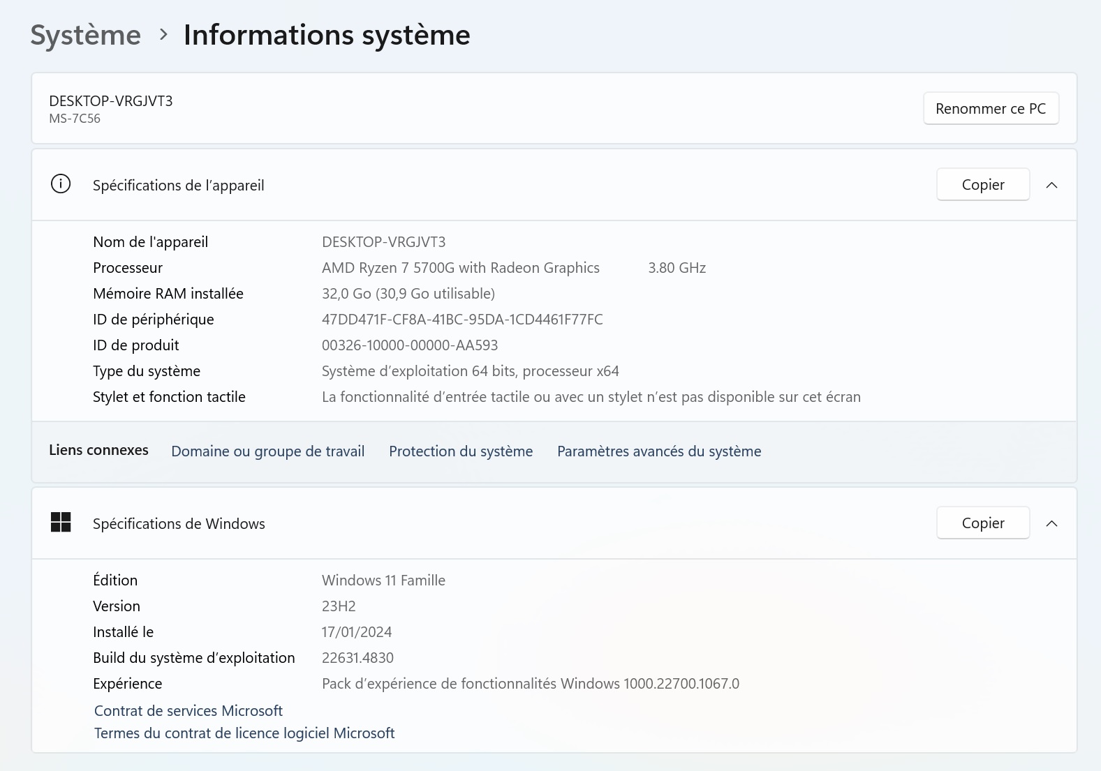

Please also tell us what kind of computer you use for your Roon server. There may be simpler methods to get ARC working.
Good, thanks. OK, so according to this, the Roon server doesn’t think that there is an issue with the port forwarding. The router allowed the Roon server to configure it automatically for you, and the Roon server thinks that this worked.
Obviously, this makes it weird that ARC believes otherwise. Please also show us a screenshot of the ARC app where it complains about this.
Thanks. Did it ever work and just stopped, or did it do the same thing immediately as soon as you tried using it?
It’s clearly odd that the server and the app don’t agree. I think this is something that official support needs to take a look at. They may be able to get more information from the technical log files.

Rather than trying to figure out what’s wrong there with the port forwarding (which might not even work with your internet service provider), it is easier to use the alternative Tailscale method. It makes it seem to ARC on your phone as if it was connected to the local wifi. Therefore, the port forwarding is not necessary. Using Tailscale for ARC is fully supported by Roon Labs.
You just have to install Tailscale on Windows and the phone, and create a Tailscale account. You can read about the basics here:
And the Windows-specific instructions are here:
Thank you, it works fine with Tailscale!
