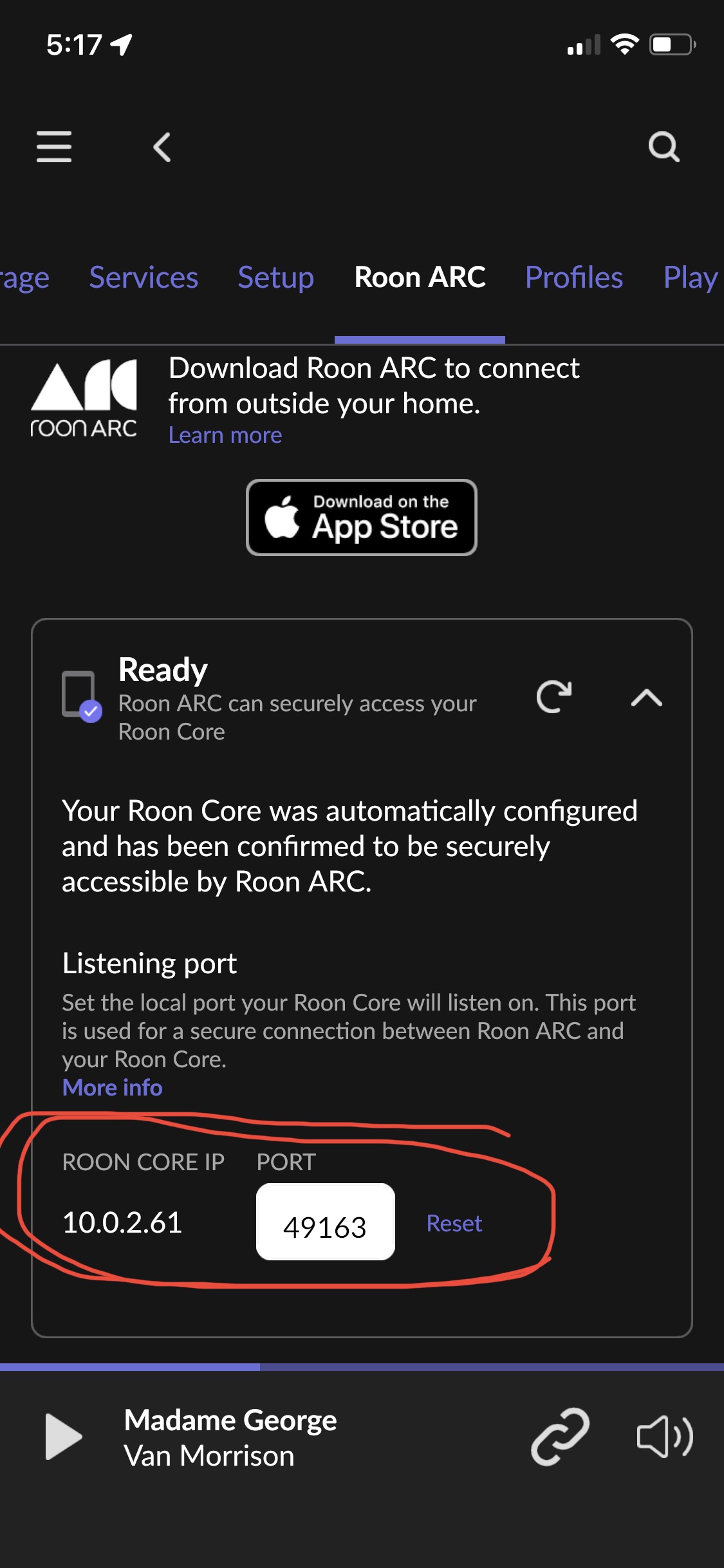

Not sure. I have a Port forwarding / port mapping setting in the router. I added it to port forwarding. All the details you need (IP and PORT) are in the roon arc settings screen.

Is port 55000 what was requested in the ARC app?
It was not for me. It was a different number. I used the one on the ARC settings page. Saw someone talking about this on another thread. Seems to work if I use the port on the app.
Whoever I replied to has deleted the post, but yeah you have to match the port requested in the app to the port you forward to the host device. That’s how port forwarding works!
Troubleshooting may be helpful for experienced users. I love music and port forwarding (with a mesh router by tp-link is a mystery for me.In the deco app I took the port, the arc app suggested, still no connection
Hi you need to look on your Roon, settings, Roon ARC all yore info for port forwarding can be found here
My understanding is that it doesn’t matter what the number is as long as it is the same in Roon Core and in Port Forwarding. 55000 is the “usual” number used .
I don’t see anywhere in the ARC app where the port number can be found.
…it doesn’t matter as long as the port-number is not already used by another service :wink:
Roon recommend to use 55000

You need to know your Roon core device IP address and the port number it’s using. In Roon, go to Roon - Settings - Roon ARC. You will probably need to click the down arrow where you should see the IP address (192.168.1.85 for instance) and the port number (55000 or 55002, etc.) Those are the numbers you will need to create your port forwarding in your internet router.
