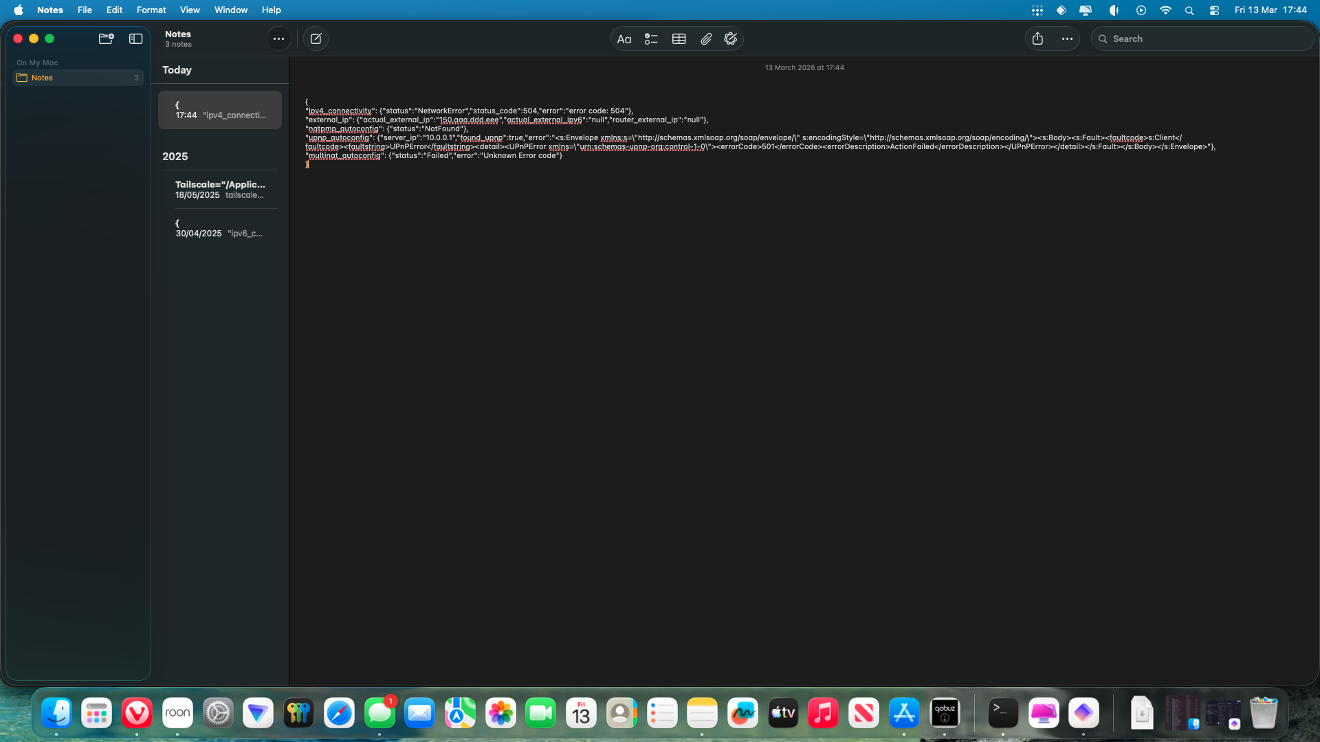

· Hi, using Tailscale, for some reason my system has stopped functioning for ARC. Have done all the checks I can and am getting error messages from my Room Server saying it is not ready. Have previously had issues, but Tailscale resolved them, but it's stopped!
· Use Starlink as internet provider, through a Netgear Orbi 800 wifi network, Tailscale.

Hmmm, not sure how anything on my phone could make a difference to those error settings on my room server (running on Mac mini). Tailscale all fine on all my devices. All up to date room server rebooted, all the standard stuff
unable to connect to the room server from my phone at all.
What I don’t get is why it has stopped working when it was working fine.
