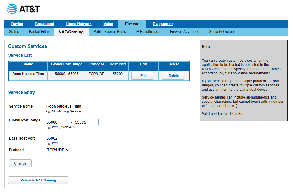

· My router was replaced today. Even though I have opened a port, Roon ARC still says "Not Ready."
· AT&T Fiberoptic 2 gigabyte service. AT&T router model # BGW620-700

Hi @Tom_Gurgui,
Thank you for your post. You’ll need to specify the target IP (the RoonServer IP address listed in your Roon Settings → ARC page) in your manual rule for port forwarding.
If you select “edit” or “change” in your screenshot, you should see an option for a dropdown menu under Needed by Device. Look for an option to enter IP address and then paste the IP address from Roon Settings → ARC.
Restart RoonServer after you’ve saved the rule and let us know if this helps.
Do you have any second routers in this setup, by the way, or only the AT&T gateway?
Hi Connor,
Thanks for the tip. I seem to have gotten the Roon ARC problem solved (instead of entering the IP address of the target device, I was able to select “Nucleus Titan” which is the name that I gave the server in the Roon software. That seems to have fixed the problem.
