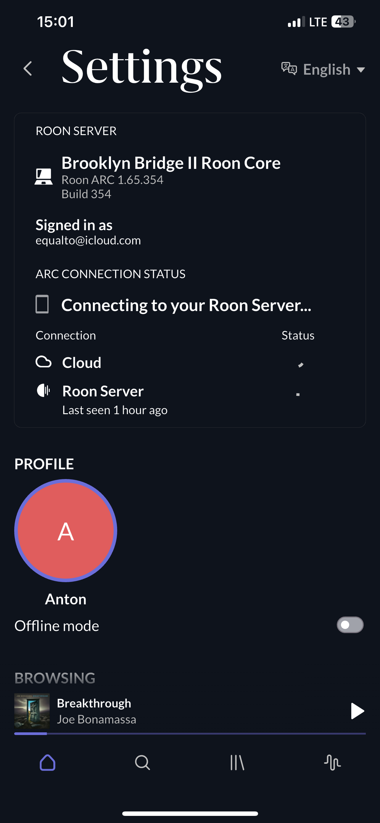

Hi ! I still have problems with connection. It works only in local network. Also I can’t download any music from local network ROON core.
Hi @equalto ,
It looks like you are on LTE in that screenshot and it says your RoonServer is last seen an hour ago, so I wonder if it could just be a cached page. What is the exact error that you are seeing in Roon Settings → ARC? Have you configured a port forwarding rule or are using Tailscale for the ARC connection?
